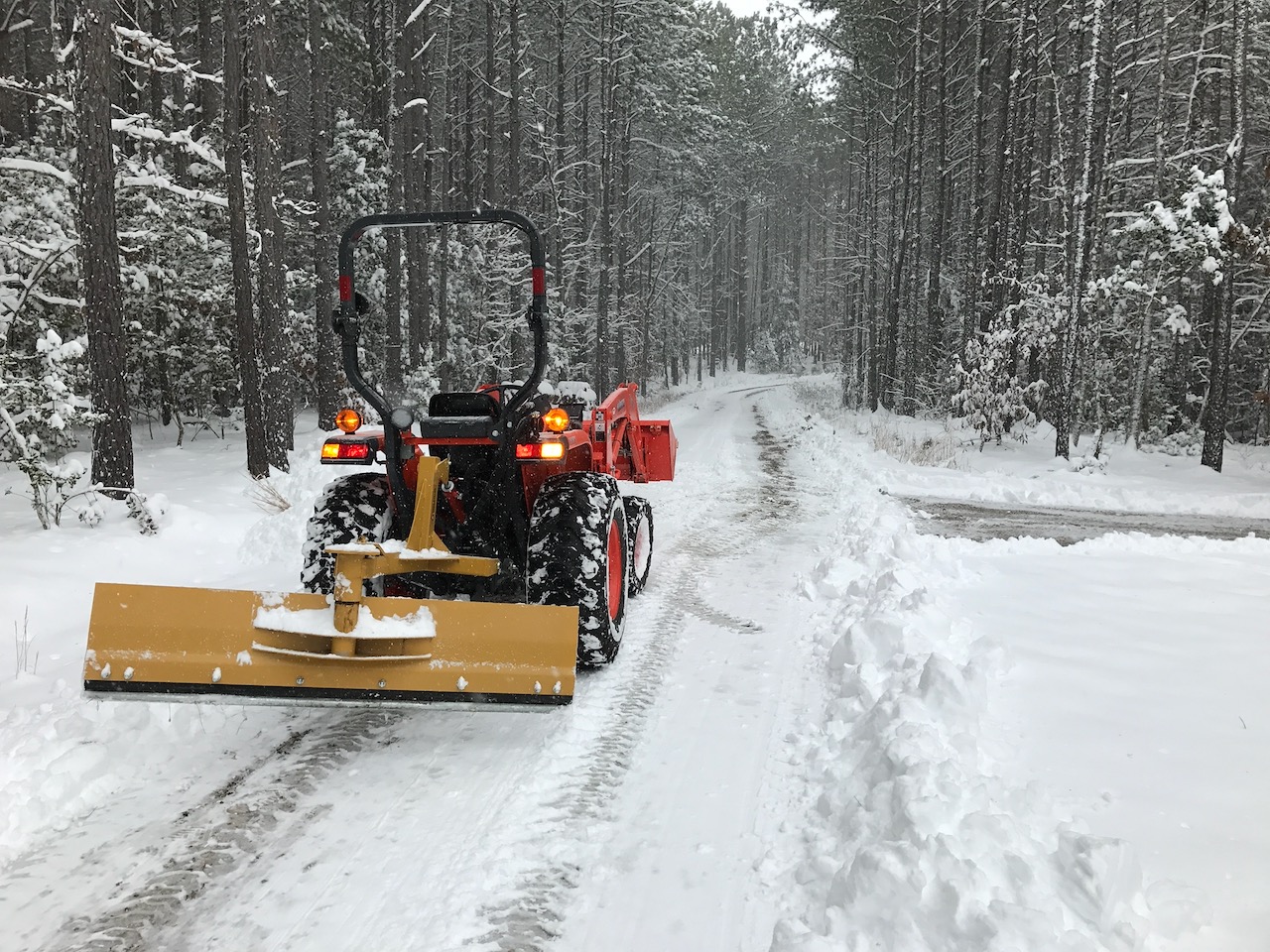

This is a fairly typical result after clearing with a rear blade and pipe over the cutting edge:
I tend to clear in two passes, out and back, one on each side of the driveway. This avoids running down the very middle and scraping off the crown in the gravel.

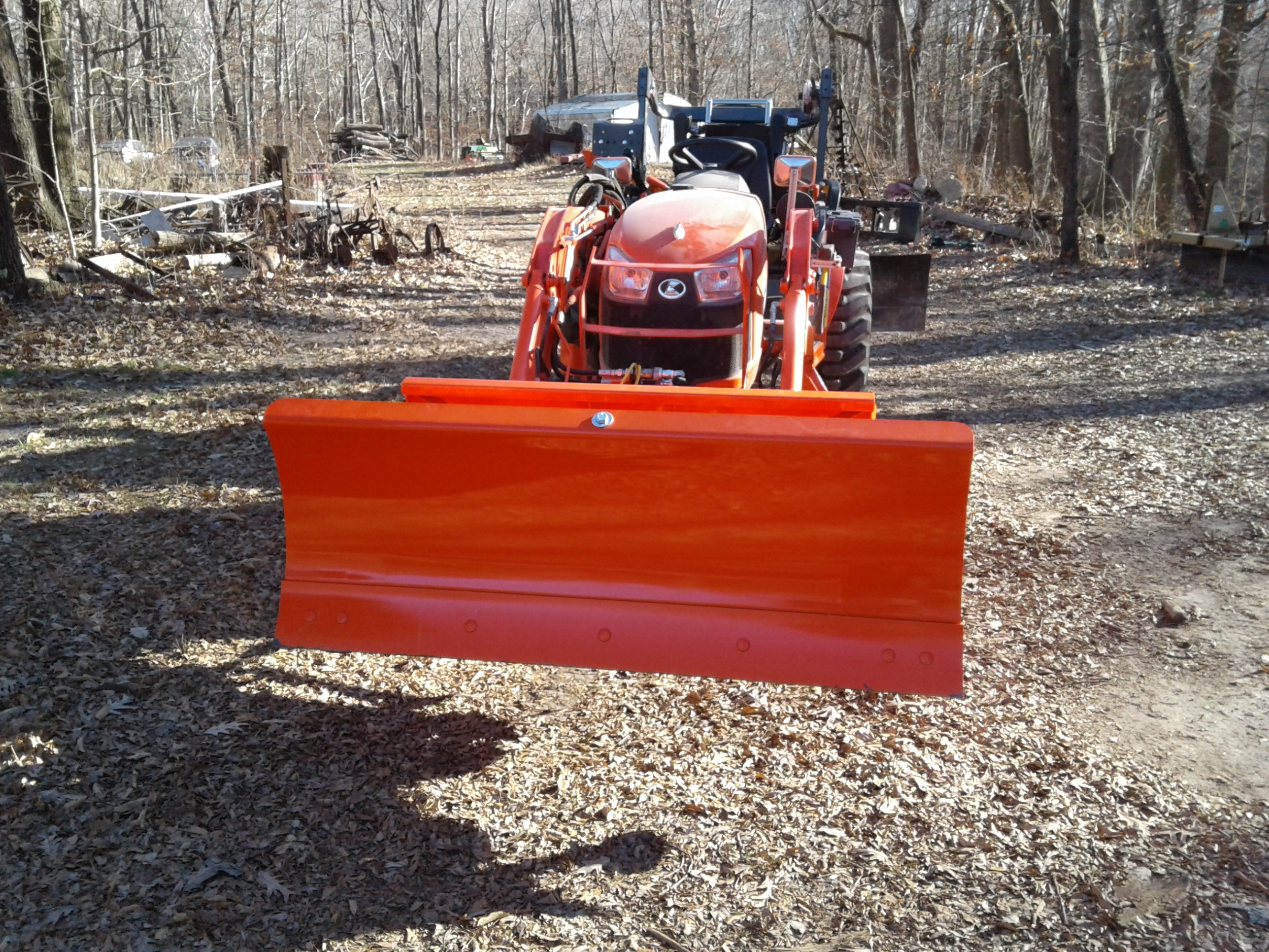

I got by with all of them. Rear blades took more effort. Blower was fun but was poor for doing parking lots where I had to toss the snow more than once to get it off the lot. Snow plow on SSQA is my favorite.

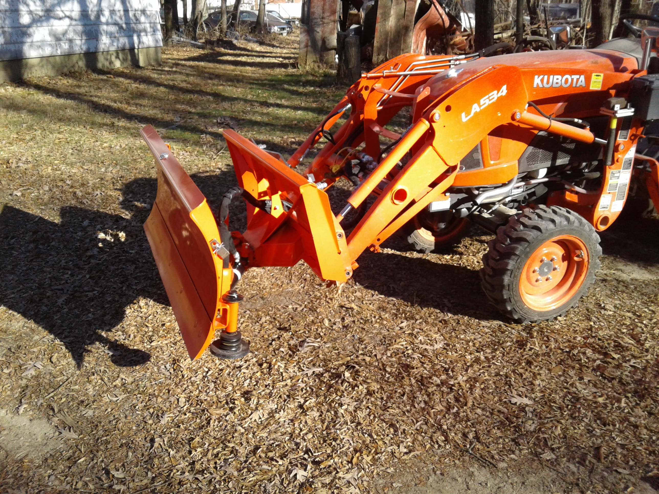

Funny thing with FEL plow when you angle the blade it also tilts. You have to adjust curl cylinders to make blade level again. The skid shoes on the plow keep digging into my gravel, think it needs wheels like a state truck has. It maybe years of only having a rear blade but I just use rear blade now, less hassle.

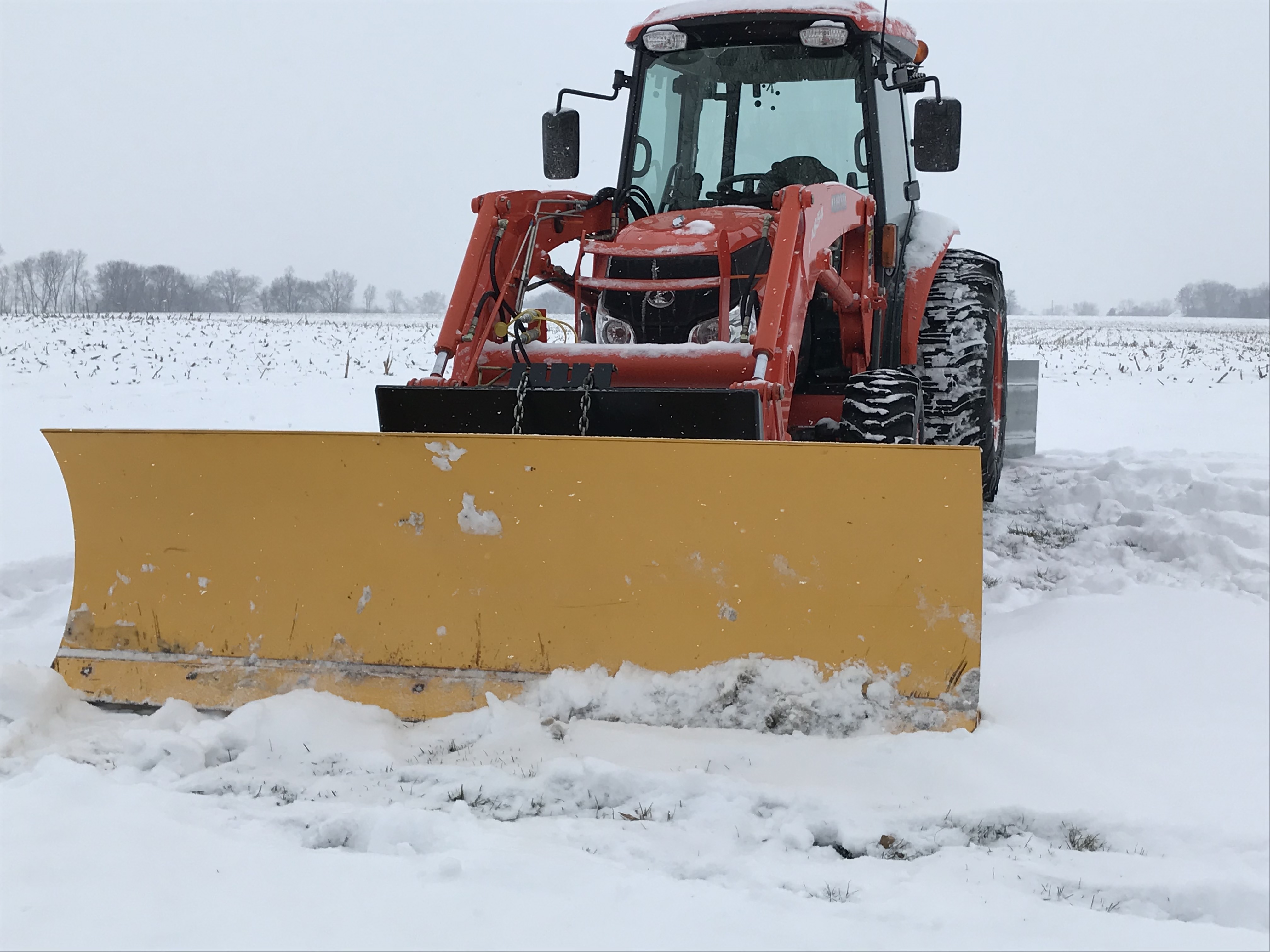

I have and use both;a 8' converted truck plow on the FEL and a heavy 7' rear blade.They both have their uses.

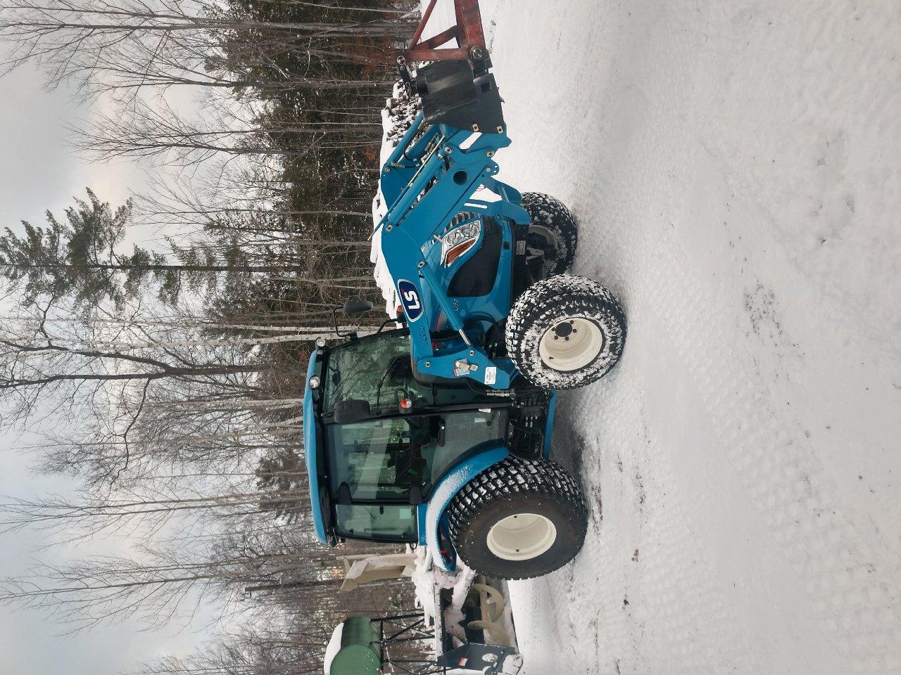

I use a rear blade mounted on a SSQA adapter on the FEL and a pull blower on the 3ph. I get 120-140" a year...flat driveway...80'x80" area to clear between drive and pole barn...loaded turfs. Last year was first year. Never had more than 10-12" to deal with. Worked very well.
If you set the plow frame parallel to the road the blade will stay level at any angle.
