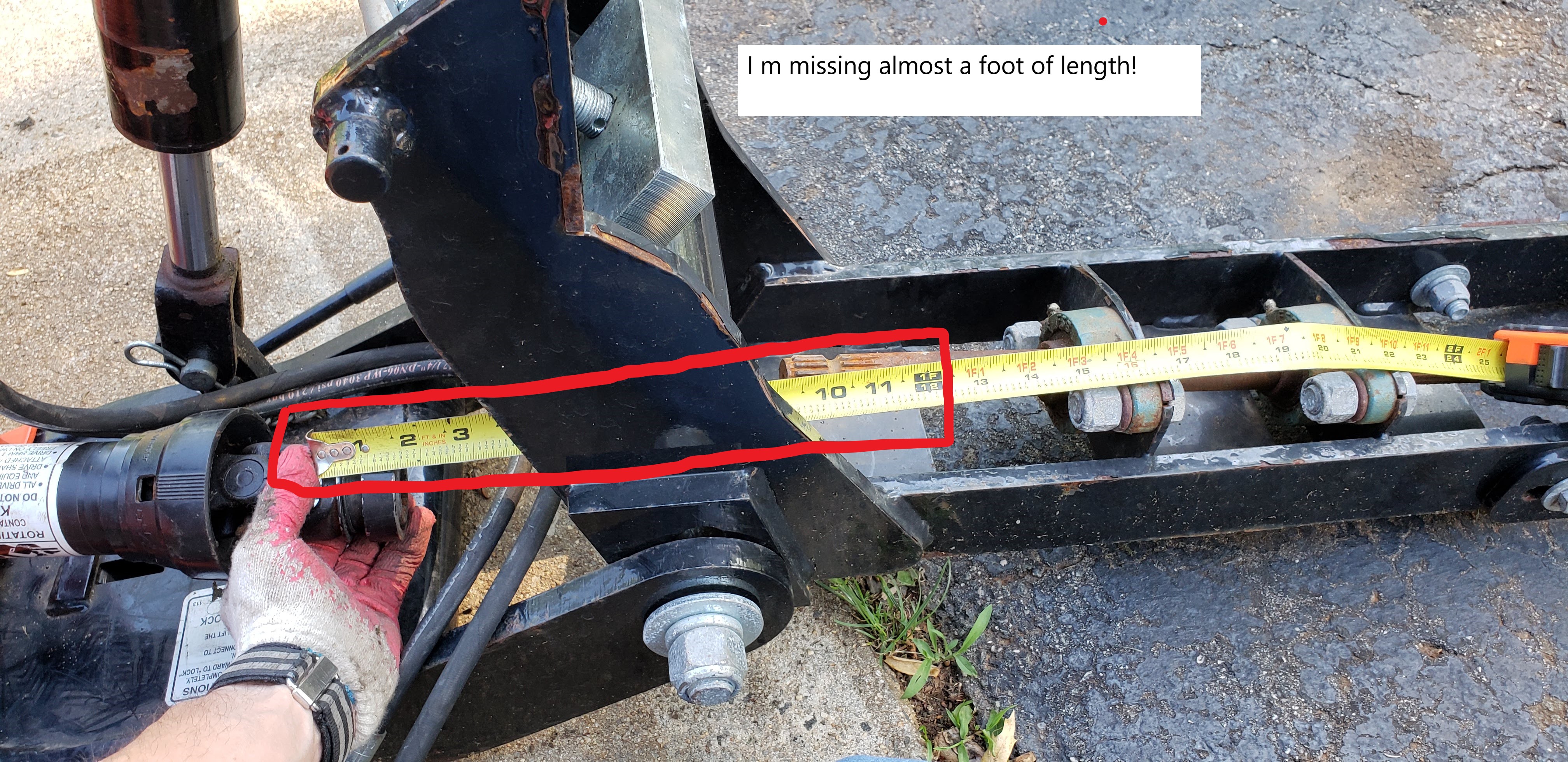

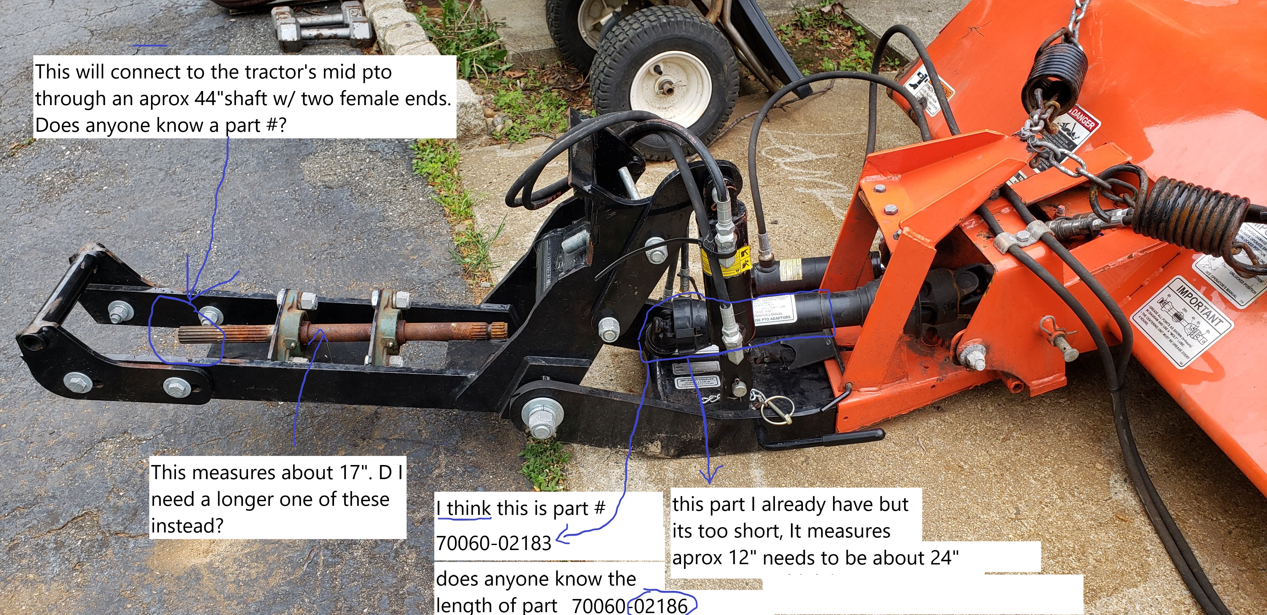

I have a 2033 b7500 hst tractor and I bought a used front sweeper and a quick hitch. For the life of me and after talking to messics and my local dealer and posting on another forum, I cant figure out the missing parts to make it all work.
Do any of you know what parts I need to compete the following installation? 2003 B7500 tractor to BX2537A sweeper through B2733A front hitch. The sweeper came with a front driveline male shaft that is too short (12") I measured about 19"-20" length needed. (or maybe I need a longer output shaft on the quick hitch?) Also the output shaft thats on the hitch measures about 17.5" and needs to connect to the rear PTO. I was told maybe the 44" part # 7060-02186 shaft would fit. Can anyone verify that or have any input on this?

It's either 70060-02183 or 70060-02186.

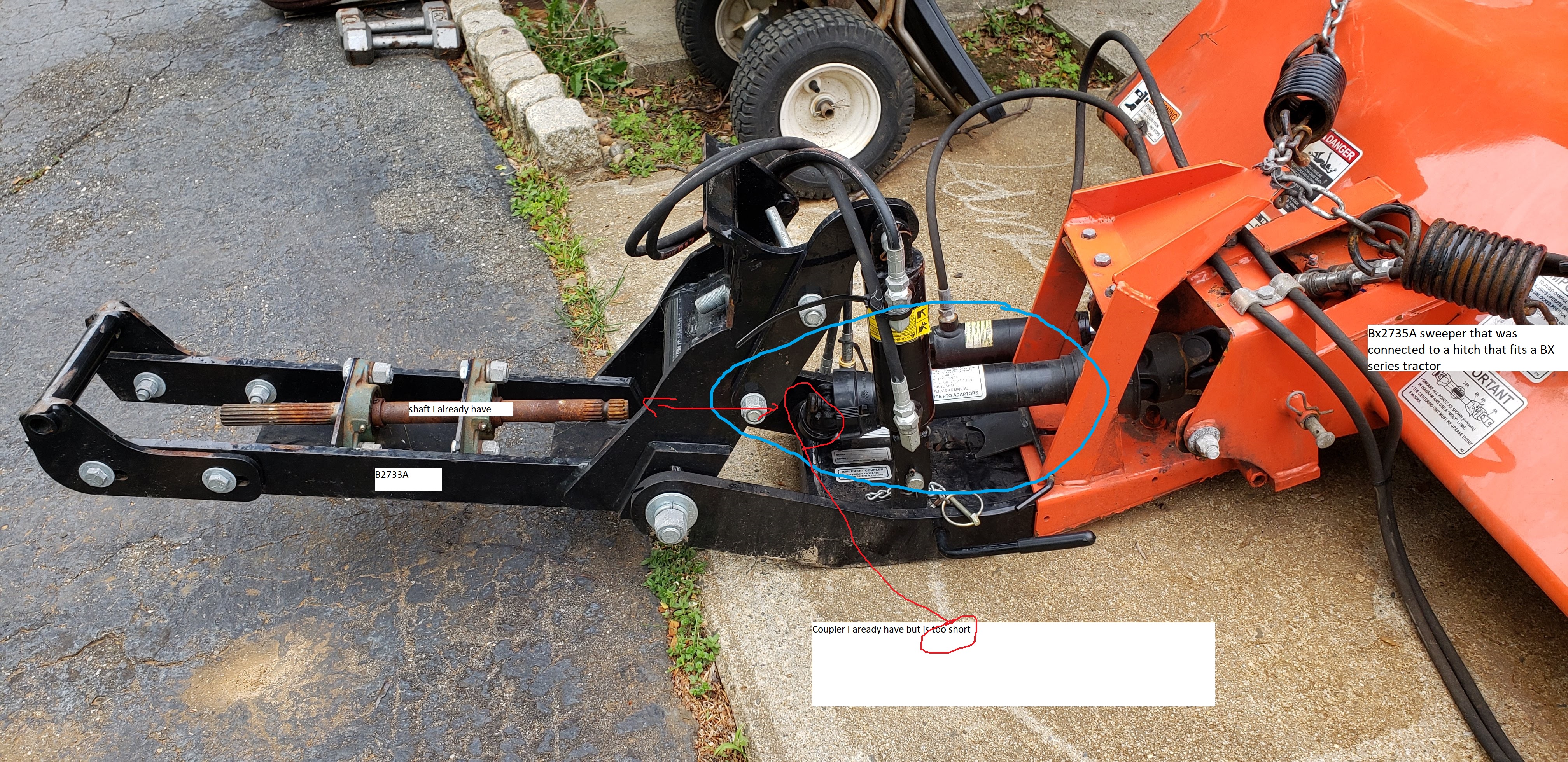

I need two parts. I need to replace either the front DRIVE LINE - MALE PART that is too short or the output shaft that mounts to the hitch and then I need the driveline that connects the output shaft to the mid pto, Please see attached pictures when you get a chance

The shaft with the black plastic shield on it should have some telescopic length in it.
A driveshaft shop could lengthen your existing male shaft.

Mid PTO to quick hitch shaft # on mine is B2734. The other shaft for the front on MINE is, BX2735, 1/2 shaft they call it. Good luck, Kubota sure does make this stuff CONFUSING.

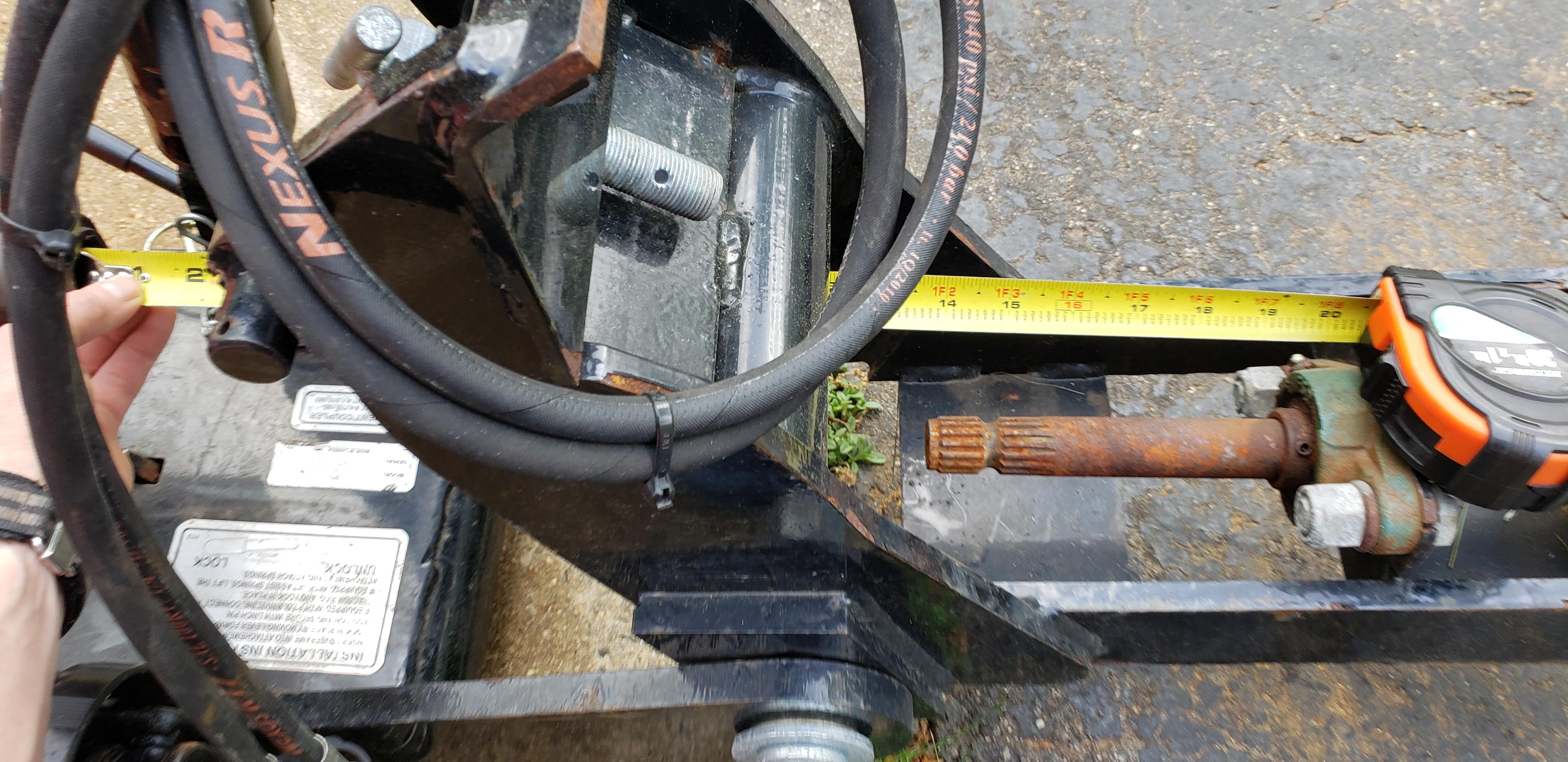

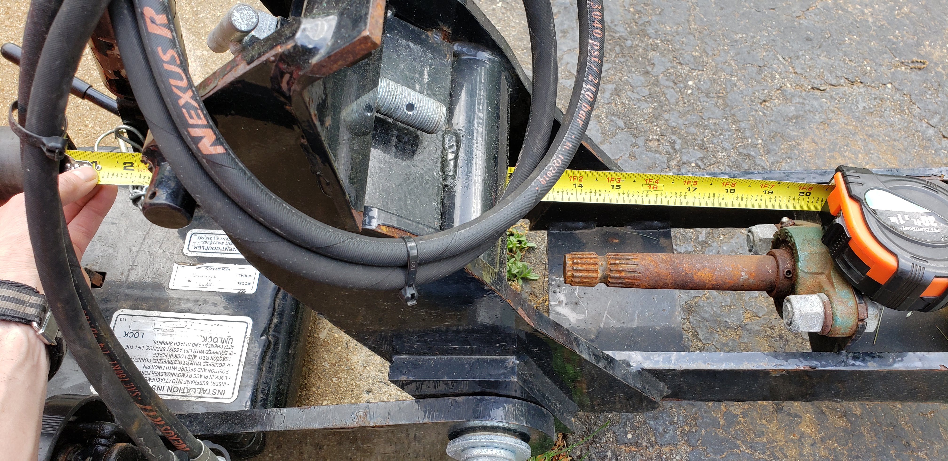

Hi SwampCat. Ok it sounds like you have the same setup. I really appreciate the help. I would like to beg you to measure the parts you have.
I put the B2734 part on my cart. it shows up as 70060-04541. Ill wait to confirm before I order.
On the front 1/2 shaft ... I think I have that one but its too short. Even if I use the full telescopic length as DaveM7040 mentioned before. If you can measure all the parts you have I will at least be able to have a shop make them. Maybe its possible that my output shaft is too short (the straight one on the quick hitch that sits on the two bearings). If you measure everything I might be able to figure out where it fails.
Mine, from mid pto to implement measure as follows (approximations) mid pto >44" to > 17" output shaft to >23" to implement connection. Im calculating these lengths with enough play for normal operation and also room to lock the parts together.
I really think I have a short output shaft...maybe there is a longer one

Lol! 350 mile measuring tape will be hard to come by. I ordered part KUBOTA BX2735 HALF OF FRONT DRIVELINE. Will wait to receive and check fitment. I you _or someone else_ happen be able to measure by then I would appreciate the feedback. I will update this thread when I know more

spirostats - I have a 2003 B7500 HSD-R that runs a B2781A snowblower through the B2733A Male Quick Hitch and Subframe. The Mid PTO Drive kit, from the subframe shaft to the mid PTO, is a B2734. Note the B2734 is a complete assembly which includes the P/N 70060-02186 Fixed Driveline and 24 other parts. My Half Driveline (Male Part), from the implement Half Driveline (Female Part) is a B2736. According to my Operator's Manual, The Half Driveline (Male Part) for BX implements, such as your BX2537A, is BX2735. Both the B2734 and BX2735 are "Wholegoods" which are ordered through the Sales Department at my Kubota Dealer, not through the Parts Department.

Sorry I've been away on business. I just got back and found UPS had delivered one of the parts. The KUBOTA BX2735 HALF OF FRONT DRIVELINE. It fits! Now I will try to figure out the mid pto driveline which according to "swampcat" is this one

spirostats - Glad you got the BX2735! My apologies regarding the information I gave you on the B2734, which is an assembly, however it includes parts that you already have on your Quick hitch. The fixed driveline only is P/N 70060-02186 according to my Operator's Manual. I just measured my fixed driveline and it is 44 3/8" overall length, with about 3" to overlap the mid PTO shaft. Again, sorry about the bad information.

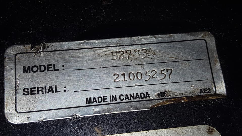

spirostats, I just checked my quick hitch, I misspoke, mine is a B2733 without the A. Dont know what the difference is between the 2 ? Mine LOOKS like yours, but why the part # change ? Will measure my B2734 shaft when I get the chance. Isnt Kubota research FUN ?
