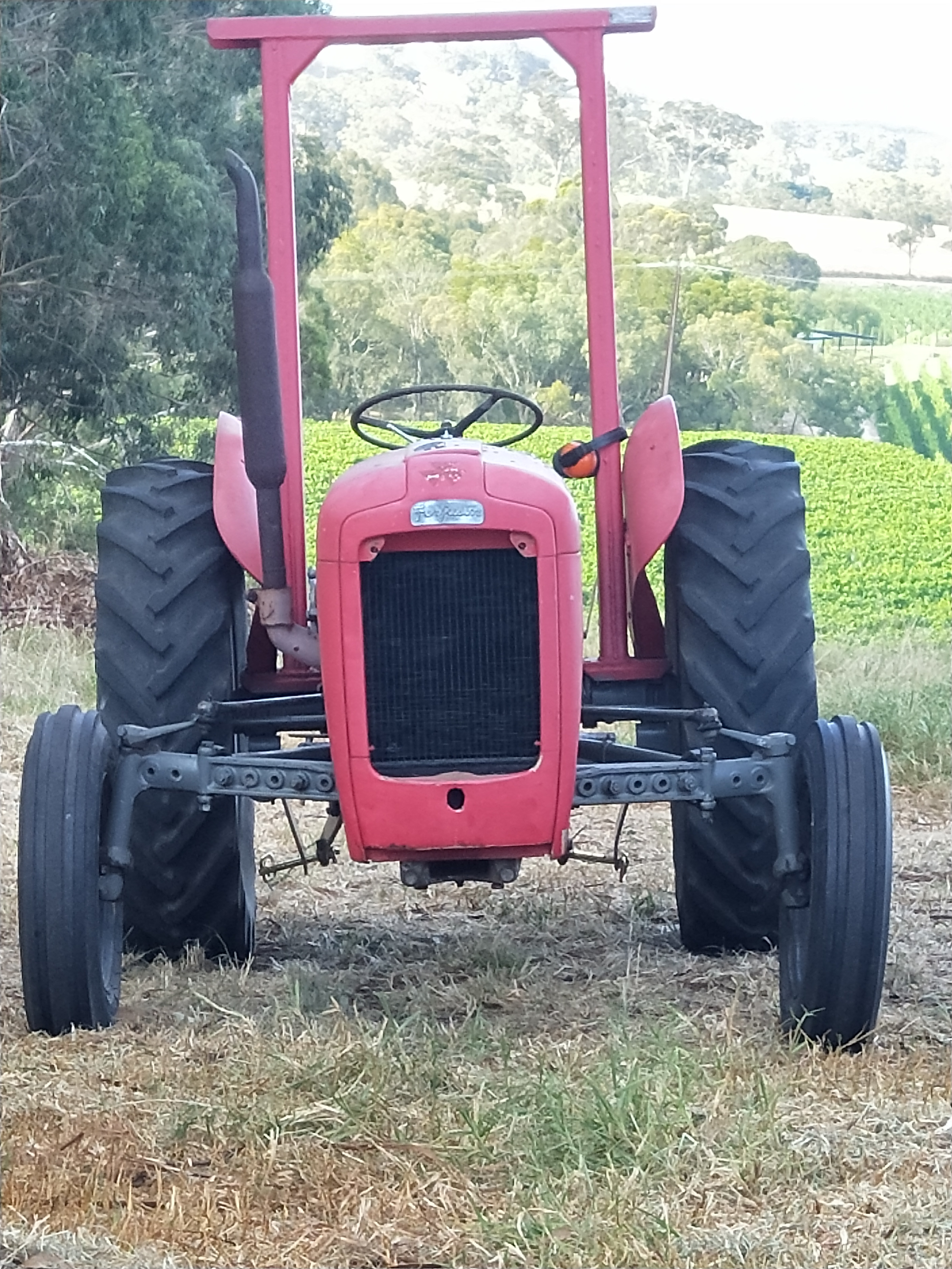

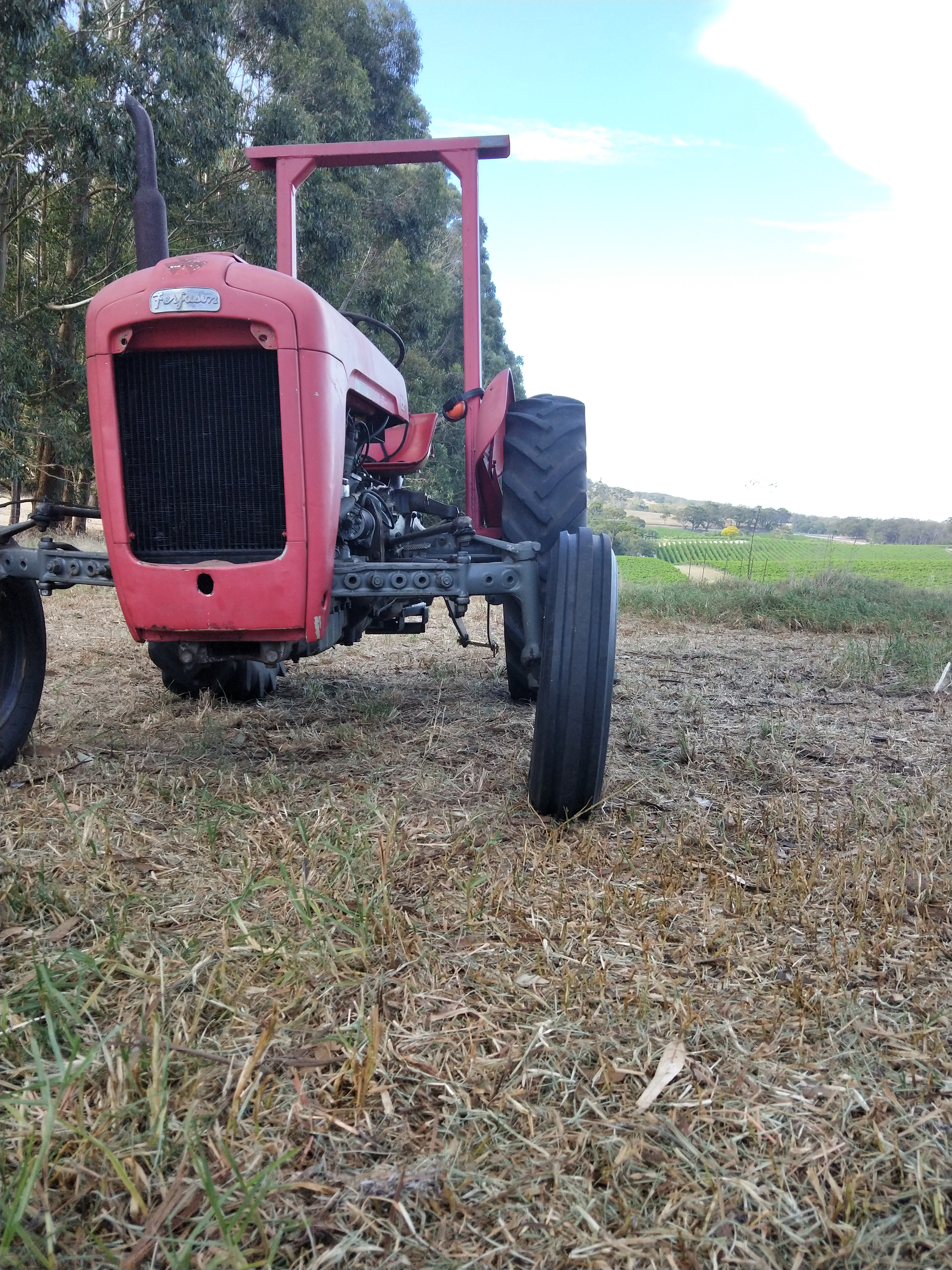

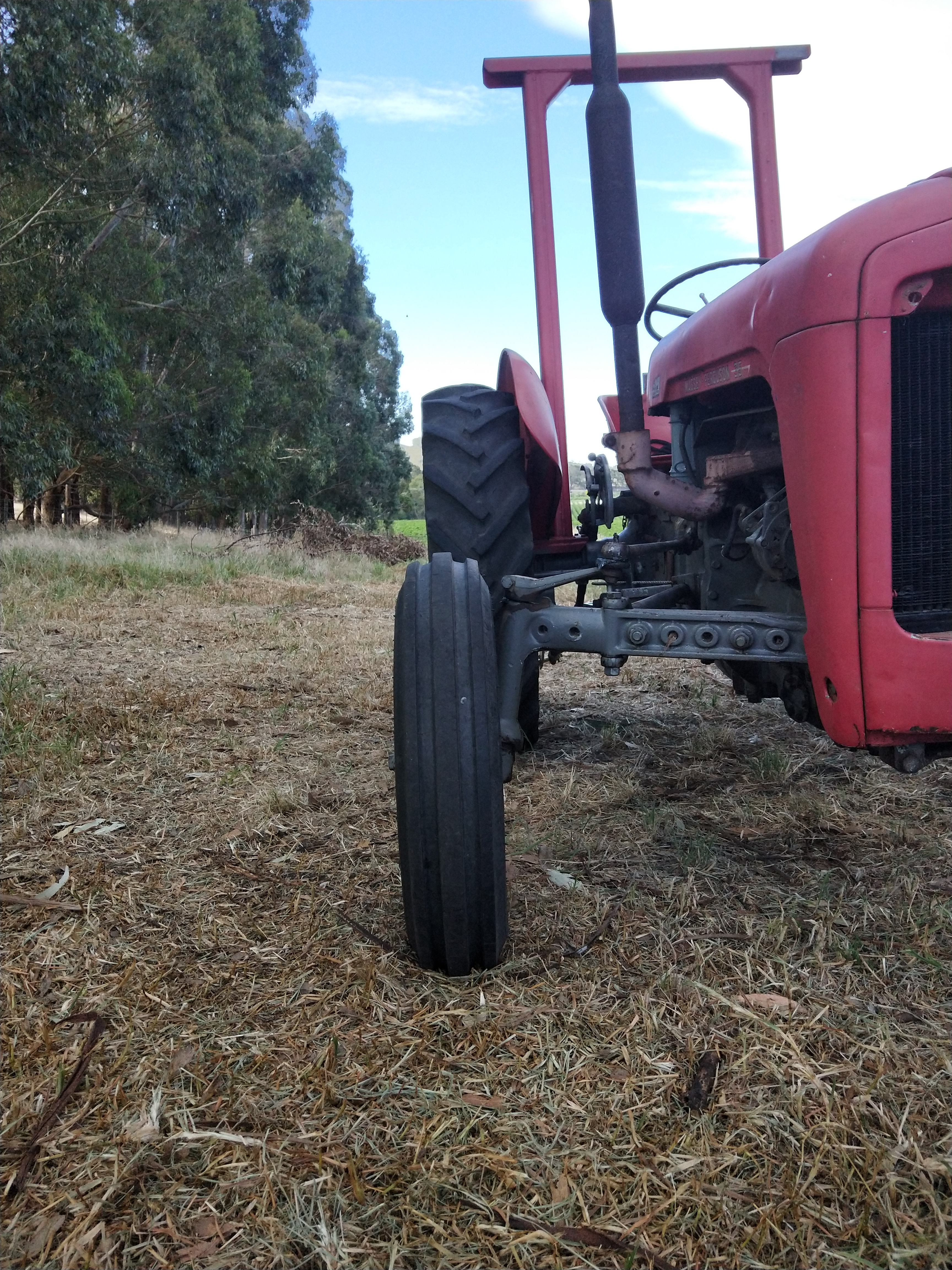

Hi people
I've recently aquired an FE35, the serial number indicates it's a 1959. Over all, I like it. However, I've noticed that the front wheels seem to be at odd angles, as per the attached photos.
Since these tractors don't have camber adjustment, what could be the cause? I have noticed that it also seems to have toe out, could this be a contributing factor?
TIA

You need to get an Op Manual and see what is recommended for your specific unit. Pictures can be very deceiving. Somebody will probably post here with the data you need. Just hang in there.

To me the right tire looks like it's taller than the left one. Are they both the same size? Check to see that the spindles aren't bent and that the wheel bearings aren't loose. I'm also thinking that the right front wheel is up on a bump for the picture which would also distort things. How does it look on a level surface?

Cheers oosik. I have all four manuals, and I can't find any reference to wheel camber. While the pictures can deceive, my eyes don't, The LH front wheel has a definate outward lean (positive camber). I'm wondering if the stub axle is a bit bent?

The only thing I can tell by those photos is you have it parked on unlevel ground. The only way you will be able to measure camber and toe accurately is to park it on level ground or better yet concrete.
You should probably start by jacking it up and checking wheel bearing play.
For doing home alignments I cut a piece of pipe that fits inside the rim beads and hold a digital level or angle gauge against it. Add or subtract from 90 degrees to figure out the camber.

All good suggestions, thank you. The right hand bearing was a bit loose, I've tightened that, and it's slightly better. i suspect I have a learning curve ahead of me.
