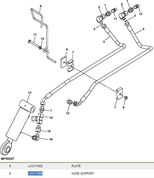

I thought I had read in my owners manual that front chains should not be used? Can anyone confirm this?
Did that metal loop that the hoses run through come from the factory? Mine doesn't have that loop just the webbing.

The metal loop that the hoses run through was on my tractor when I bought it.
I had looked and looked for something that would suggest that front chains not be used and couldn't find anything. If something negative happens I will be sure and report it here.

Mine does not have the loop either. My tires rub on the hoses enough that the mesh is wearing through. Looks like maybe the mesh "sock" was traded off for a loop?

I'm anxious to find this loop for my tractor. I had my dealer look and what he came up with was for a 59" blower kit. I don't think this is correct, but can't say for sure. It does look like there is an extra pair of hoses running out front for a hitch in Chuck's picture.
Being that Chucks tractor is a cab model there seems to be quite a bit of "different" plumbing going on. It would appear as though 2 hoses from the mid SCV ports are outside the mesh bag and 2 go to a point up and behind the SCVs

on my 3520 the square loop for retaining the hoses came as part of the front hitch kit that is necessary to mount my 366 front snow blade. hope this helps..............bud

There are some different shapes, but for my 455 hitch part number M96981 is what I use.
The model 3720 square loop is LVU17400
pictured here:

regarding the hose support------------------I did order a front mounted snowblower so perhaps the wire support came with that. We have had very little snow in northern Minnesota to date but the temperatures have been above normal right around 30 degrees during the day. That has resulted in very slippery conditions and I am very pleased with the steering control of the 3720 with front chains now. I am currently using loader arm mounted blade because the road is still wide enough so I don't have to blow the snow over and beyond the banks.
