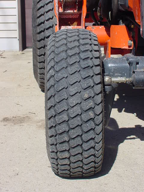

I have Titan Multi Trac C/S 24x8.50-14 front tires on my B2630. I ran over a stump and put a small tear in the sidewall. I looked online for a replacement and found the Titan tire store that said muli trac c/s are manufactured by Titan and Carlisle and they make no distinction between the two. So I order one from another place(because I can save $7). Not sure the Titan store sells only Titans.
I get it and it is a Carlisle, no problem it looks the same has the same load rating, tread pattern, made in the USA, everything. I get it mounted and on the tractor and it has a flatter profile than the Titan.
I got on Titans web site and they list all the specs like rolling circumference but Carlisle doesn't go into quite as much detail.
O.K. what do I do?
1. Run it
2. Find a Titan replacement save the Carlisle for next time
3. Try to patch it
4. Give up, sell the tractor

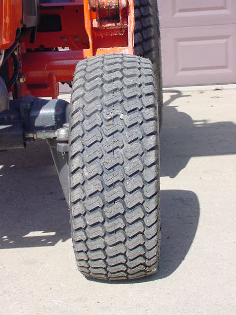

Got the tires mounted and measured. Carlisle is 22.75 inches high and Titan is 23.125 iches high. Not much difference but you can see in the pictures that the Titan is rounded a little more.
Bought another Carlisle and will be keeping Titan as a spare.
Lesson learned, replace tires in pairs.
Hope this helps someone.

Check the overall diameters when the front wheels are off the ground and the air has been let out. If they are the same, then one has a different pressure sensitivity. You may be able to run a differential pressure to keep the rolling radius the same (NOT rolling diameter). By any chance, is one a 2 ply and 1 a 4 ply tire ? Same mold would be used for the 2 construction recipes. That would explain a pressure sensitivity.
/ Front Tire Snafu
zzvyb6: Both tires are exactly the same spec on tire(4 ply). Both rated for 1230lbs.
LQPAPPY:I got the Titan specs but can't find the same in depth specs for the Carlisle

Do a rolling circumference and compare.
With the same air pressure in each front tire, mark a spot with ink or paint and roll back one full turn. Then measure from the first ink stamp to the second. Do this on both tires and compare the two measurements.
I would bet that the difference is insignificant or nonexistent. KennyV
