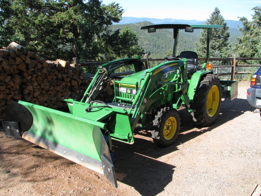

I put these on my blade. Added about 20". Don't know how it will work until we get some snow.
Buyers Snowplow Blade Wings, Model# PW22 | Snowplows + Accessories | Northern Tool + Equipment
thanks Mech, I used to have your same set-up and "retreated" back to. I may have to try these out as the Deere version is rated for light material only and costs more than these. They look better but if these are more heavy duty than the Deere version, I may be quite interested
   / Frontier 72" snowplow on a 200cx (2320) #28
I have never seen the John Deere wings, in fact my dealer said they didn't have any for the frontier blade. These are very heavy. They hook to the blade with three quick pins (same size as on my 3 point). Two to the outside on hinges that attach to the outside of the blade and one that goes through the blade (you have to drill a hole). This allows you to rotate them back and to easily remove them. I'm happy but with all the talk in this thread about the front wheels slipping I'm hoping it won't be too much for my tractor.
