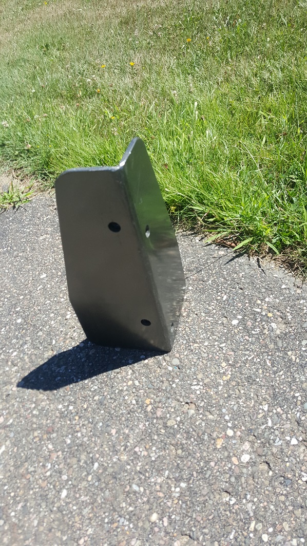

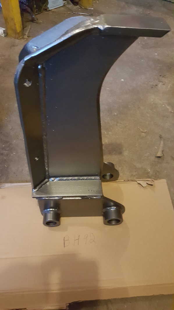

Bro-Tec replyed to my questions. They do sell a Ripper for my backhoe.
The Ripper is $480.00 plus shipping. You can buy an additional bolt on trencher for an additional $170.00.
Thanks to everyone for their help.

The blade is 17" tall with an additional 5" base for a total of 22". I've been in contact with Daniel Breau - Daniel Breau <bro-tek@outlook.com>

I got the trencher for but the price it ain't much so I suggest you save your money. Like I said for digging stumps you'd be better off with a tooth that has teeth and a cutting edge like the Talon from BX expanded. The cutting edge would really help tear through the roots. I'm pretty sure they'd make you one with the same dimensions you'd be sending BroTek. The BroTek is very dull and it doesn't do much with tree roots. Backhoe Ripper
They offered to add teeth at no extra charge. I asked for the teeth to be added. Thanks for your feedback.

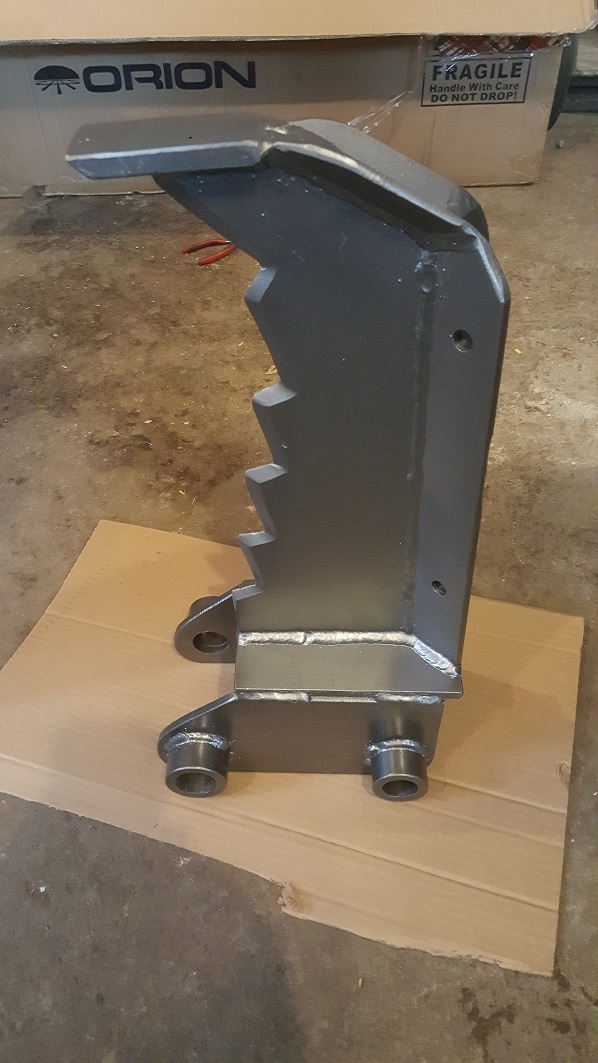

Here is a picture of the ripper with teeth.
/ Frost Hook #32
I think I would want the ripper teeth facing the opposite direction. When pulling up on the tooth the flat part of the barbs should be the part that catches the root.

I got a chance today to install and test the root ripper I got from Bro-Tec. Installation was easy and the root ripper performed better than I thought it would. The thing is amazing. My father-in-law previously wanted a stump grinder. Since seeing how well this root ripper works, no stump grinder in his future. Good job Bro-Tec.
