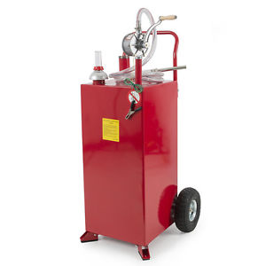

I got one of these at about the same price as listed (~$135). 3 Gallon Gasoline Fuel Diesel Gas Caddy Transfer Tank Container w/ Rotary Pump | eBay
Aside from the wheels being crappy, and the axles being a weird size making replacement challenging, it's been great. I did eventually replace the hose and nozzle with stuff from TSC, but what it came with was adequate.
I use it for diesel, not gas, I just put "Diesel Fuel Only" stickers on it to avoid confusion. I can get it into my pickup empty by hand, but when full I lift it out by the handle with a loader or backhoe. The handle is not confidence inspiring strength-wise, but I've never had a problem. Having said that, I'm very gentle when lifting it full. If I had it to do again, I would weld some lifting eyes in the top so I could sling it securely and not have to trust the handle, in fact, now that I think about it, if I were using it for gas, I probably wouldn't be lifting it by the handle.
The pump works well, and it both pumps and sucks.
Anyway, I'm happy with it considering the very attractive price. You can spruce it up with new wheels and accessories and still stay under $200 all up. It holds 30 gallons.
