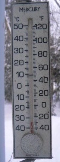

It sure is cold here this morning

It's warmed up to -10C here but it was -37C on Friday and pretty much -20C and colder all week. My shower in the back of the house has a frozen pipe so I am thinking my tractor, that hasn't been used all week, may have some gelling as well.
