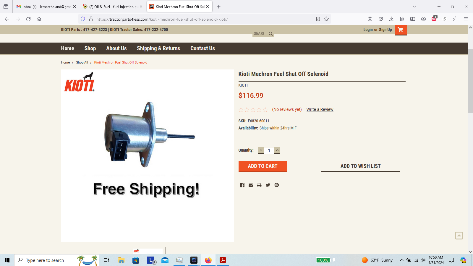

Does the solenoid activate when the key is turned on??
Remove it from the pump, ground the mounting ear to ground, turn the key to start and see if the solenoid activates.
   / fuel injection pump
#29
brand new solenoid....mechanic is coming here in the morning so Im going to let him do his thing
