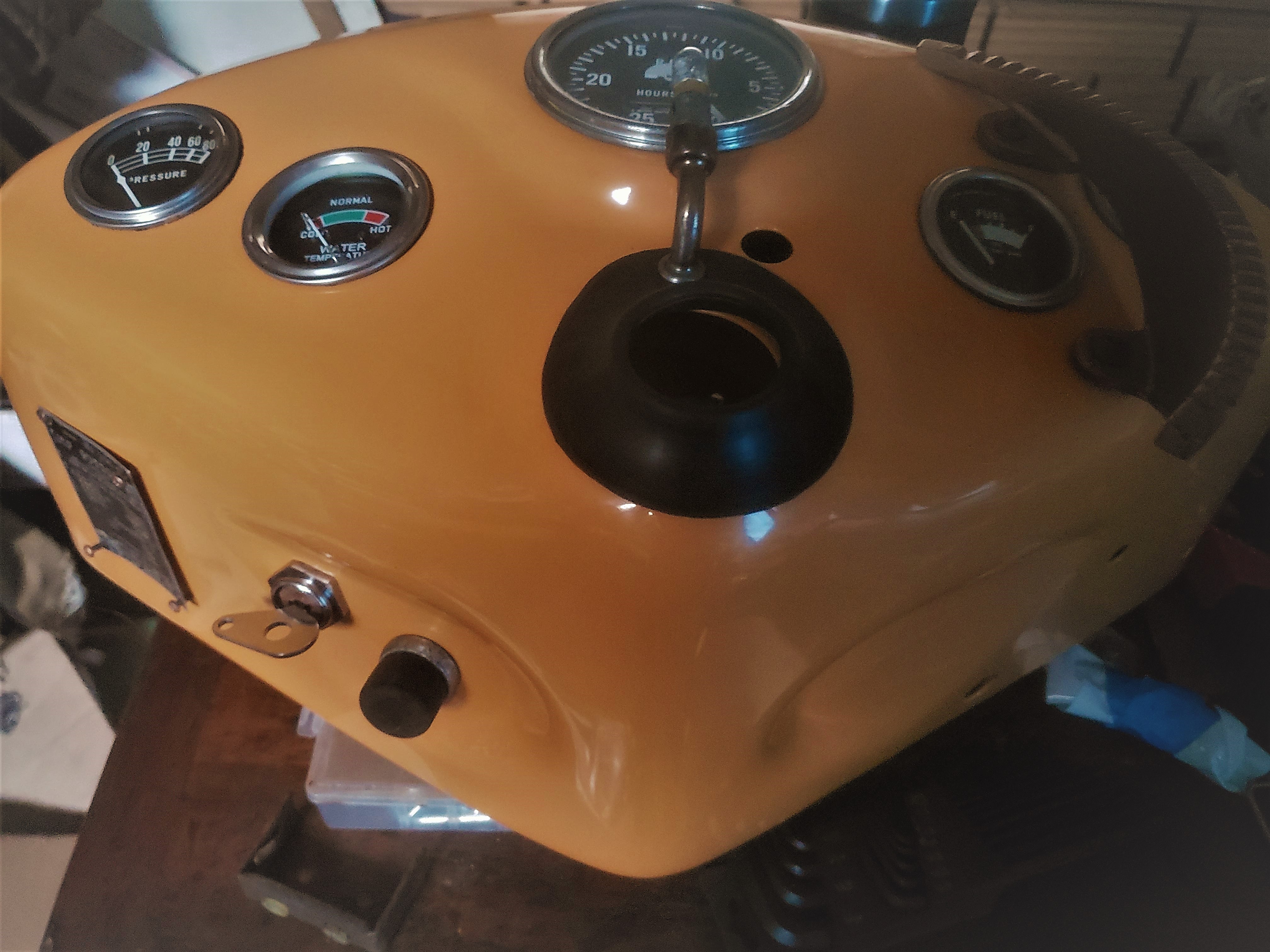

Here is a sample of the finish the Sheet metal is getting.
