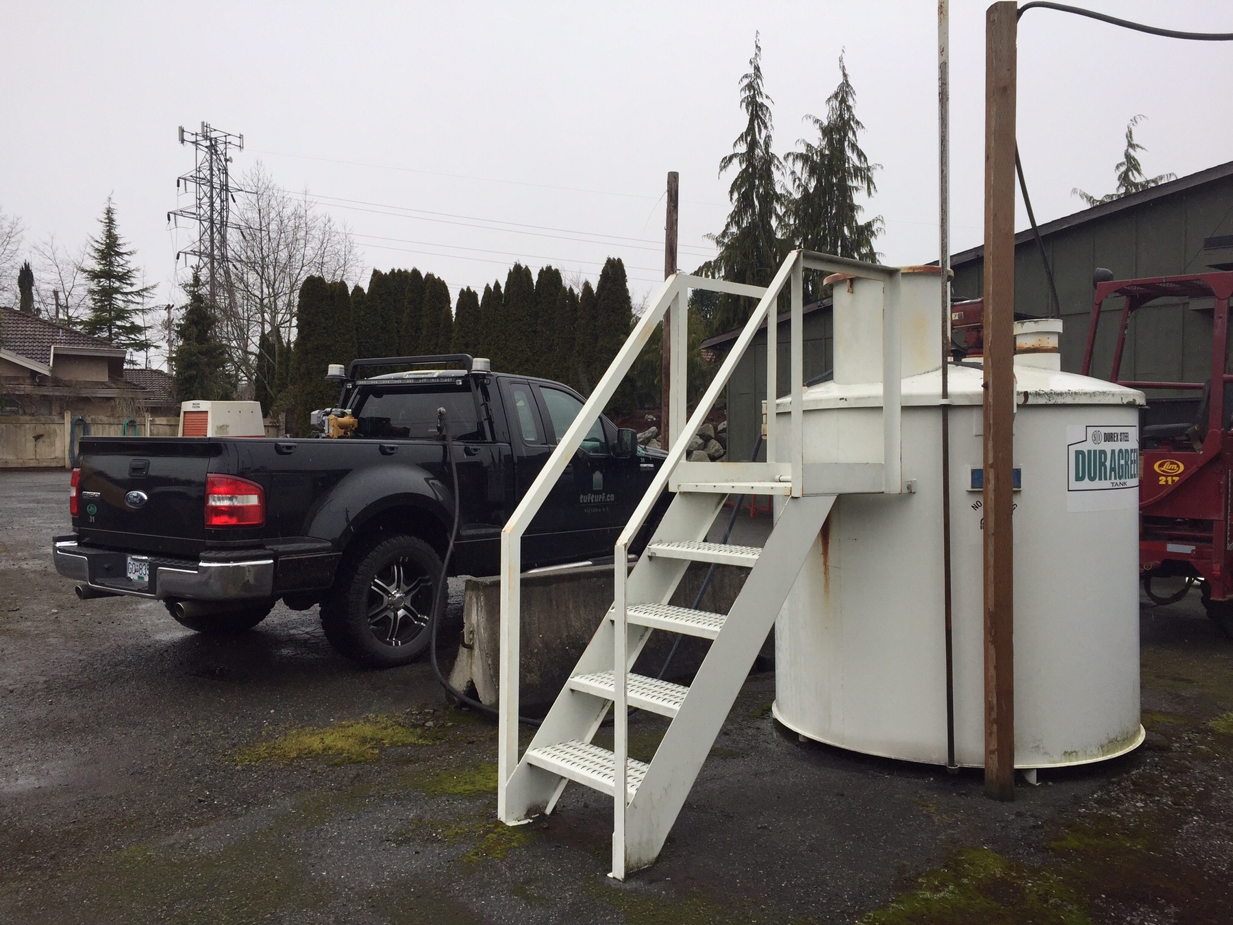

Just as a point of interest, here in the UK it is against the law to store more than 2 by 10 litres (about 4 gallons), of petroleum liquid, without a licence. Petroleum liquid is petrol, you call `gas` LPGs and other liquids like cellulose thinners. The licence is issued after inspection to satisfy the codes by the Local Authority, usually the Fire Brigade. Because of its lower Flash Point, diesel does not need a licence, however if it should get into the ground because of a leak, the Environment Agency all get excited, and often start prosecutions. If any contaminates get into the rivers or streams, well all **** breaks loose. As a point of note, the storage of `gas` in tanks above ground as shown above is `almost` a no no. There is only one storage facility in the whole country where `gas` is stored above ground that I know of, as the picture shows. Diesel storage above ground is common but usually contained by a `bung wall` to catch the contents in the event of a burst. Bung wall must hold the contents plus a third.

Pretty much the same here in Canada. Double containment walled tanks are required. IMG_1876.JPG

Pretty much the same here in Canada. Double containment walled tanks are required. View attachment 571768
They are actually required here also but nobody goes around policing private parties. If enough spills occurred they would pass laws making it illegal to pump into any container not meeting code. That would make the suppliers the regulators. Hopefully it won't come to that.
