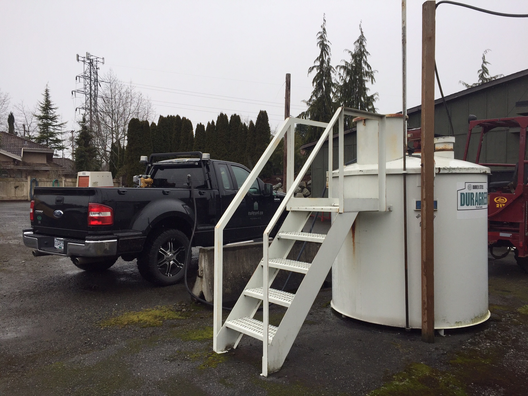

Pretty much the same here in Canada. Double containment walled tanks are required. IMG_1876.JPG

Pretty much the same here in Canada. Double containment walled tanks are required. View attachment 571768
They are actually required here also but nobody goes around policing private parties. If enough spills occurred they would pass laws making it illegal to pump into any container not meeting code. That would make the suppliers the regulators. Hopefully it won't come to that.

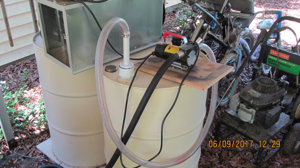

Dont use IBC totes. There for temporary storeage and none are rated for fuel.
Use a steel 300gal tank or even a 275gal heating oil tank.
Im setting up a 55gal drum for fuel.
/ Fuel storage #32
Sooo.. I've been looking for a small fuel "cell" to store more than 5 gals of diesel for my tractor and I am thinking about using a 250-300 gallon IBC tote. FYI, an IBC tote is a poly bulk fluid storage container sitting in a wire basket. Now keep in mind the basket is heavy duty, its got to support 250-300 gallons of liquids. I'm wondering if anyone is using one of these to store fuel and if so how to you have your tank set up to pump fuel? If you don't use an IBC tote does anyone use poly tanks or barrels? If you use this type of container do you get fuel delivered in bulk? I want to thank you for reading my post and your comments in advance.:thumbsup:
Now that I know that the popular blue 55 gallon drums are recycle grade 2 and the www tells me that one of the uses of that code is petroleum products the next time I need a barrel I will get poly rather than steel. Another supporter of using poly is the red plastic gas cans and yellow plastic diesel cans....bet they are #2s also.
On the tote, if over about 150 gallons (diesel wt x gallons </= 1000# to stay under DOT Has-Mat plackard requirements. I use 3 steel 55 gallon drums in an old trailer that's dedicated to the function. When empty, hook to my truck and go to town. Around here you can get sealable, clean steel for 20 bucks. Stick a TSC elcheapo 12v fuel pump, put a battery in the trailer that you have to charge ever so often and you are in business. If you feel frisky get an even cheaper hand operated pump. That will get old fast if you have any usage to speak of.

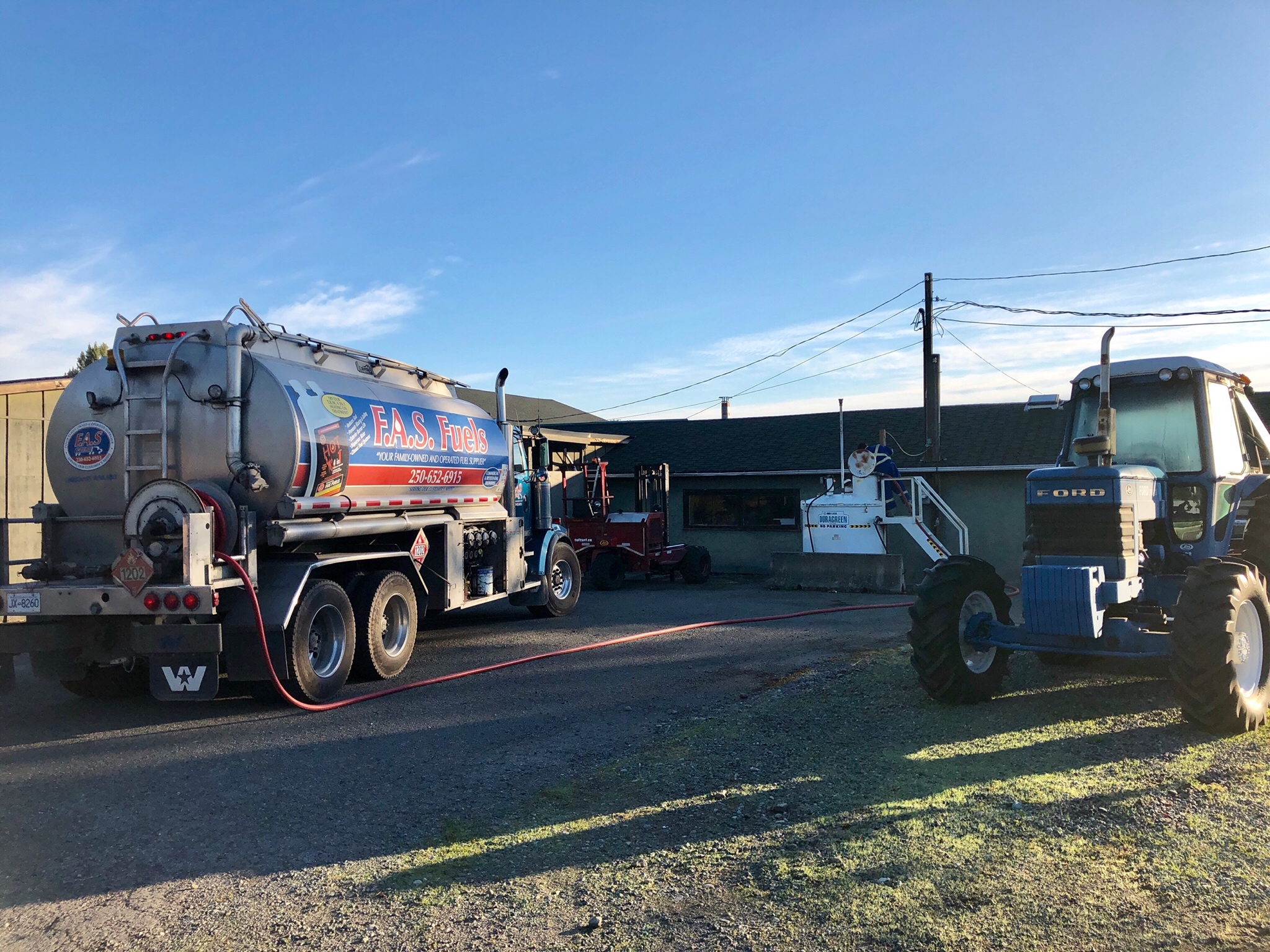

^^ How much do you expect to use in a year? Do you have any immediate neighbors that also use Diesel?
If your usage is enough and/or others are willing and able to share, consider have a fuel delivery company place a tank and deliver low sulfur off road tinted in bulk. Most farmers in rural areas do that. Generally a 500 gallon tank, but they don't get it filled each time. Bulk rates are sometimes 50 cents a gallon less than retail.
I'm buying that from a neighbor farmer for $2.50 a gallon right now.

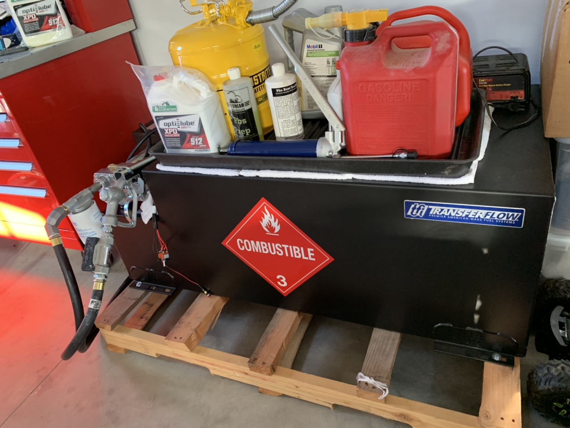

This is my new solution. I sold the cheaper thinner gauge TSC version and went with a Transfer Flow tank that came with a pump. Just added a 10 micron goldenrod filter. Sits in my garage on the pallet it came on in case I need to move it. Holds 110 gallons which is nice because as long as I order 100 gallons of off road diesel there is no delivery charge.

Here is what I purchased https://www.northerntool.com/shop/tools/product_200609589_200609589
I put it on a pallet for easy loading and unloading in the truck. It works great. I purchased this about 3 years ago with no regrets. Personally I hated using 5 gallon jug to fill with. I also at times rent an excavator or other equipment and this purchase just seems that much better. It looks like its gone up in price since the last time I purchased.
