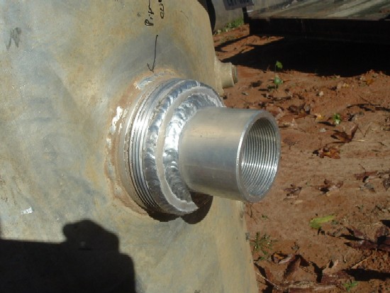

I did a few more things on the trailer the other day.
I bought some fittings to run two hoses from the bottom of each tank. When I put the tank into it's bracket to mount it, I realized I didn't take into consideration how far down the elbows would be. ooops.
I added a 2X4 undet the 4X6 cradle and replaced the eight inch bolts with ten inch ones.

My thinking is to fill one tank and have the fuel flow through the hoses into the other tank. This will balance itself out and allow me to keep the pump on one tank and the fill cap on the other.
Here are the hoses on the pump tank after the spacer was installed.
