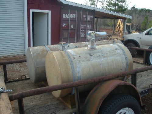

#47
Both tanks are mounted and straped in. The pump is installed. The main thing left to do is put in a filter.
I've been to Tractor Supply to pick one up twice now, and they're sold out. I think they just don't keep some stuff in stock. I saw some in my Northern Tool catalog, but would prefer to get one local so I know I can get new filters for it without any delays or problems.
Anybody have a suggestion on were to buy a fuel filter assembly that fits 3/4 pipe fittings?
Thanks,
Eddie
/ Fuel Tailer
#49
Napa had a filter that I think will do the job. I had to put a 5 inch galvanized pipe on the pump to clear the tank.
