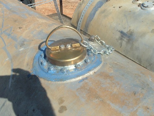

#44
One of my delays with the trailer was finding a fuel cap for it. I spent the better part of a day running around Tyler and Longview trying to find one. Finally I gave up and ordered a racing cap from Summit.

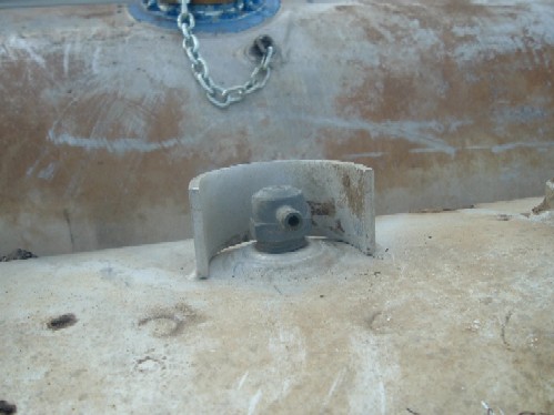

The two tanks are connected with two 3/4 inch fuel lines at the bottom of each tank. The tank I fill in doesn't need a vent, but the tank with the pump will need one so the air can adjust to the amount of fuel in the tank.
It came with this fitting on top that must have gone to a filter of some kind.

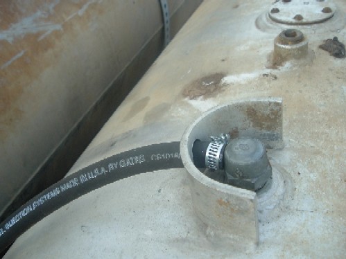

#46
I took it out, drilled a 9/16 hole in the plate and fit a fuel line in it to keep moisture out, but allow the air to vent.

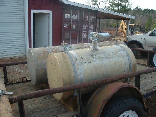

#47
Both tanks are mounted and straped in. The pump is installed. The main thing left to do is put in a filter.
I've been to Tractor Supply to pick one up twice now, and they're sold out. I think they just don't keep some stuff in stock. I saw some in my Northern Tool catalog, but would prefer to get one local so I know I can get new filters for it without any delays or problems.
Anybody have a suggestion on were to buy a fuel filter assembly that fits 3/4 pipe fittings?

   / Fuel Tailer
#49
Napa had a filter that I think will do the job. I had to put a 5 inch galvanized pipe on the pump to clear the tank.

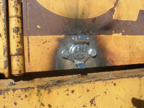

#50
For power I'm useing trailer connectors. I like this style since it has a little flap over the plugs and it bolts to the tractor.
This is the back door to the batteries on my dozer. It's 24 volt, so I connected the wires directly to the terminals on one of the batteries.
