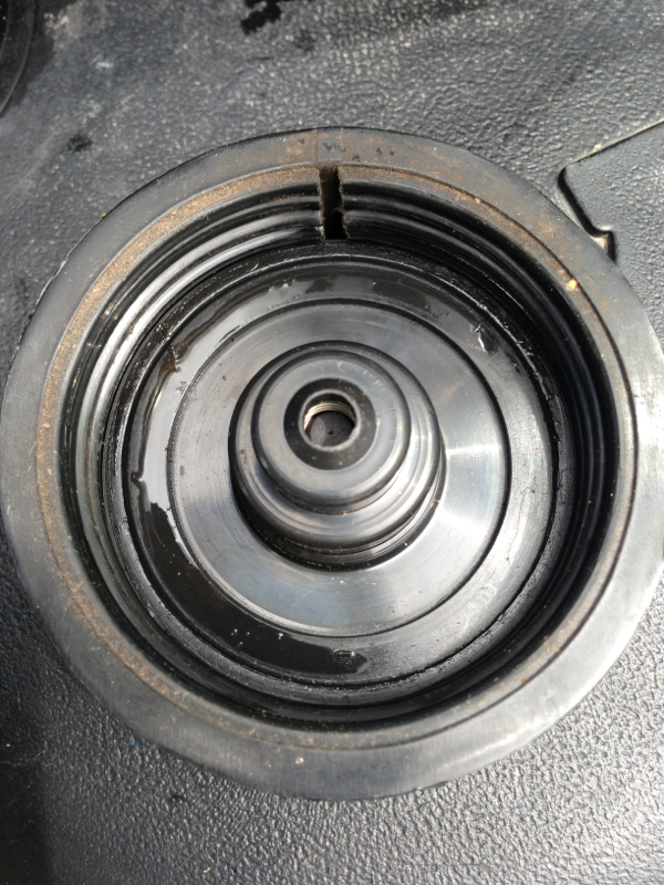

I do believe you will find that there is preasure in the tank not a vacuum. The carbon canister on gas units vents the tank into the air inlet. Part of the emission tests for a gas unit is the checking of the cap to be sure it holds the proper preasure.
Just a thought!

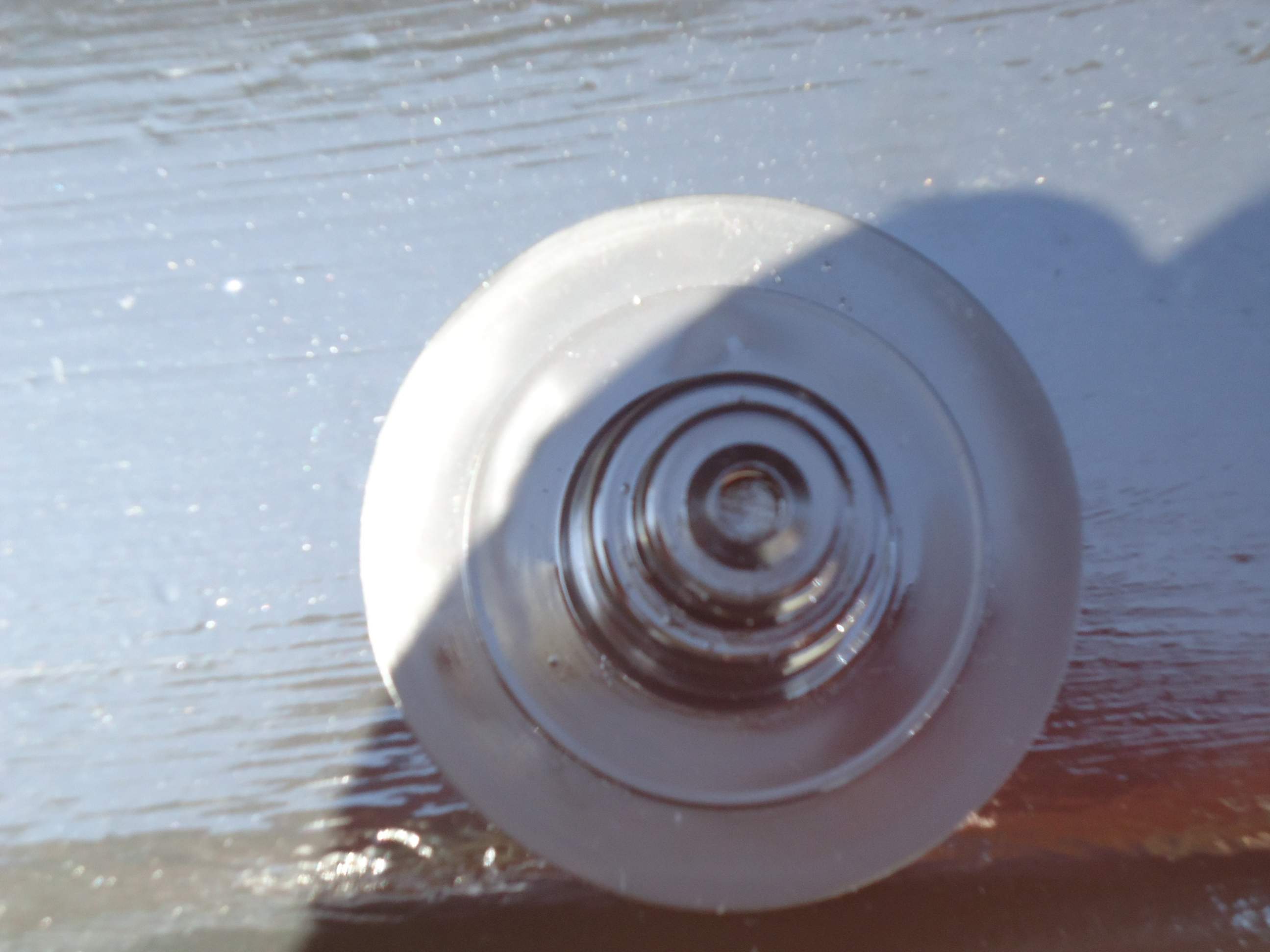

My vent is in the tank's cap.
Thanks --- I see it. I'll check my cap to see if it's the same ---- on my cap, that disk that has the vent hole in it will freely fall out of the cap. Is yours the same?
/ Fuel Tank Vacuum #14
It's in there tight. I don't see coming out unless the cap was broken in 1/2

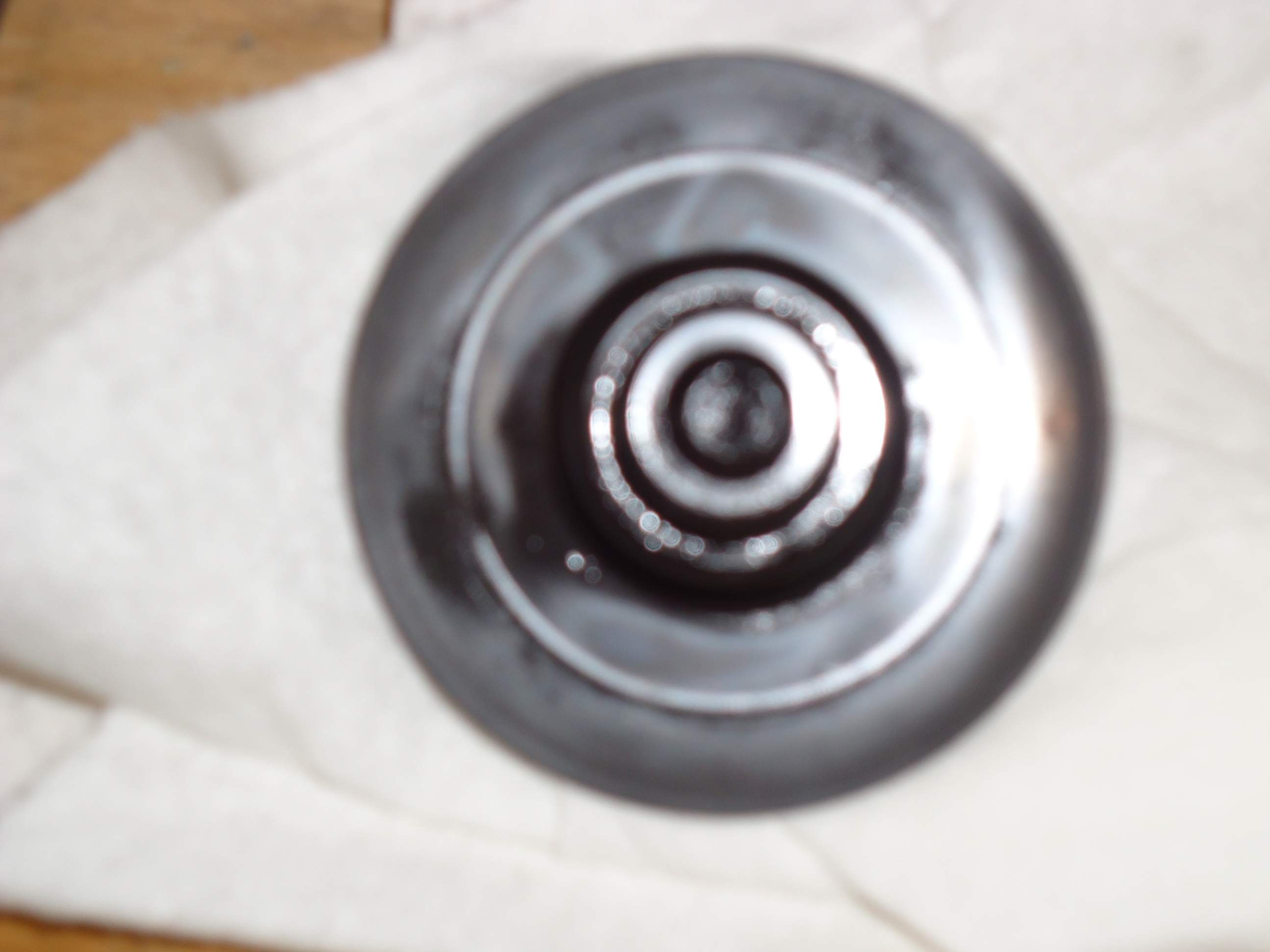

OK --- I took that disk with the vent out of my cap. It looks like yours definitely has a pin hole in the center of that soft, flexible membrane that's dead center of the disk. Mine has no such pin hole --- it's a solid, soft flexible membrane. Maybe that's my problem ---- picture below without the cap.DSC00184.jpg

Lousy pic --- hopefully, this one is better.
/ Fuel Tank Vacuum #17
<img src="http://www.tractorbynet.com/forums/attachment.php?attachmentid=317206"/>
When you look into the center of the disk on mine, that light colored gray is a spring.
/ Fuel Tank Vacuum
#18
So, there's no pin hole in that membrane?? I could swear that I see a pin hole in that first pic that you posted --- And, I agree --- the light colored gray around the outside edge looks like a spring to me too.
