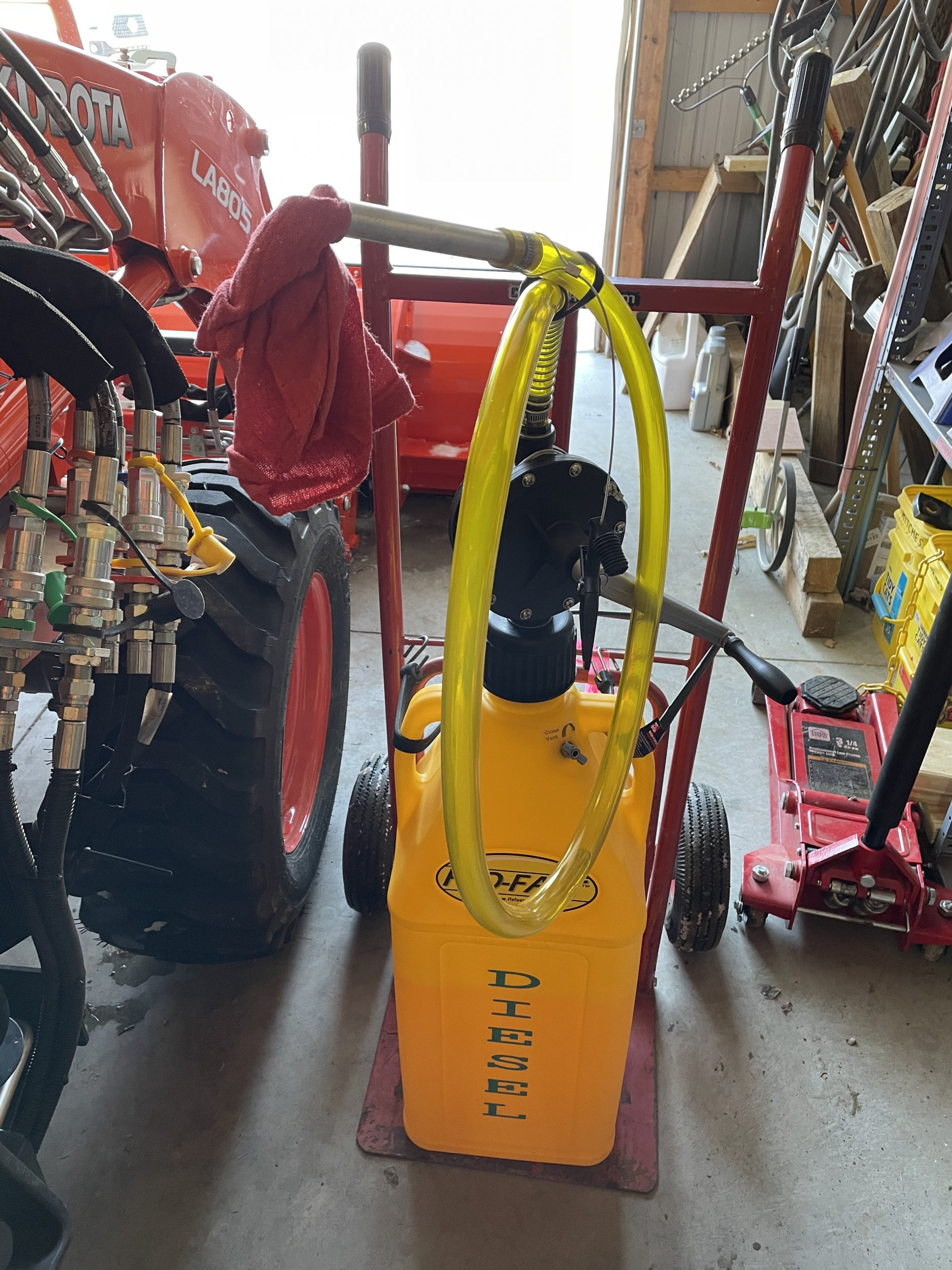

Flofast 10 gallon and the rotary hand crank. I can still lift full jugs into and out of wife’s SUV.

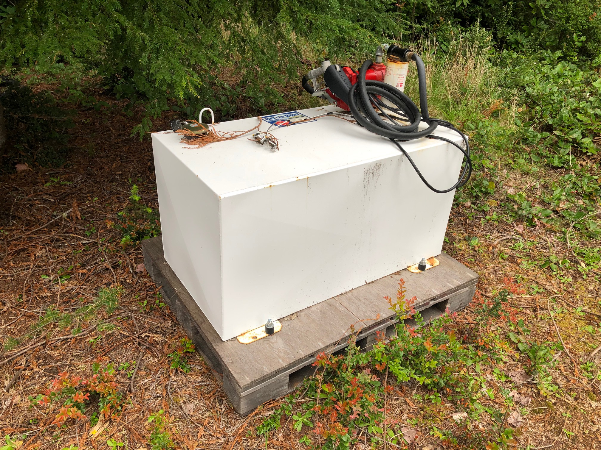

I got tired of 5 gal cans so got this 100 gal transfer tank and put it on a pallet. The pallet is reinforced with plywood for stiffness. The tank is mounted on rubber bumpers that allow the pallet to flex without stressing the tank. To avoid cracks.
I put it in back of the truck to take to the gas station, and then put it wherever it is out of the way when not in use. The fill-rite pump runs off the tractor battery. Works fine.
