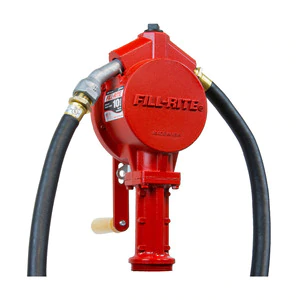

I've used one of the old school hand pumps (mine happens to be from the 50's) and installed a filter on the outlet side of it. Snowing like crazy now so I don't have a picture but pretty much the same as the picture below. Easy, no power needed, fairly fast. Uncomplicated.

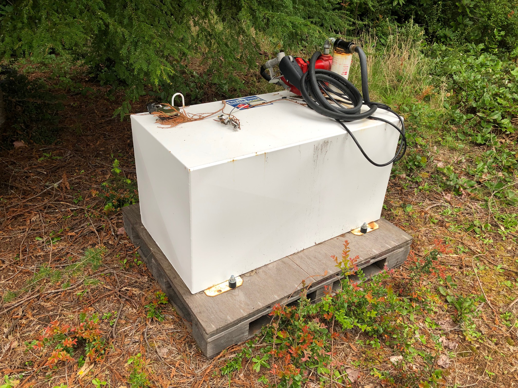

I got tired of 5 gal cans so got this 100 gal transfer tank and put it on a pallet. The pallet is reinforced with plywood for stiffness. The tank is mounted on rubber bumpers that allow the pallet to flex without stressing the tank. To avoid cracks.
I put it in back of the truck to take to the gas station, and then put it wherever it is out of the way when not in use. The fill-rite pump runs off the tractor battery. Works fine.
