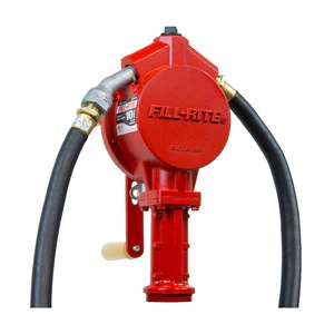

I have a plastic (lighter weight) 55 gallon drum with a hand cranked rotary pump (Harbor Freight) that I take to the fuel dealer a couple of times a year. I put in 25-30 gallons each time because that's about the max weight an old guy (78) like me can manage down the ramps from my pickup truck on a dolly. That much is too little to have delivered, but enough to bush hog about 3 acres every couple of weeks throughout the growing season, and plow a few hundred yards of driveway a few times a year. Each bush hog session, it takes about 50 cranks to refill the tank. This is a "vintage" MF35 with Perkins diesel.

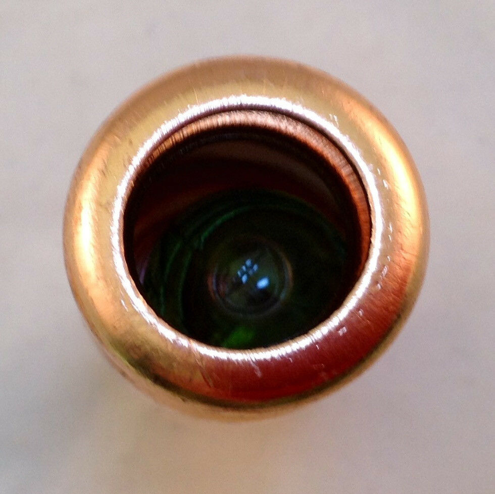

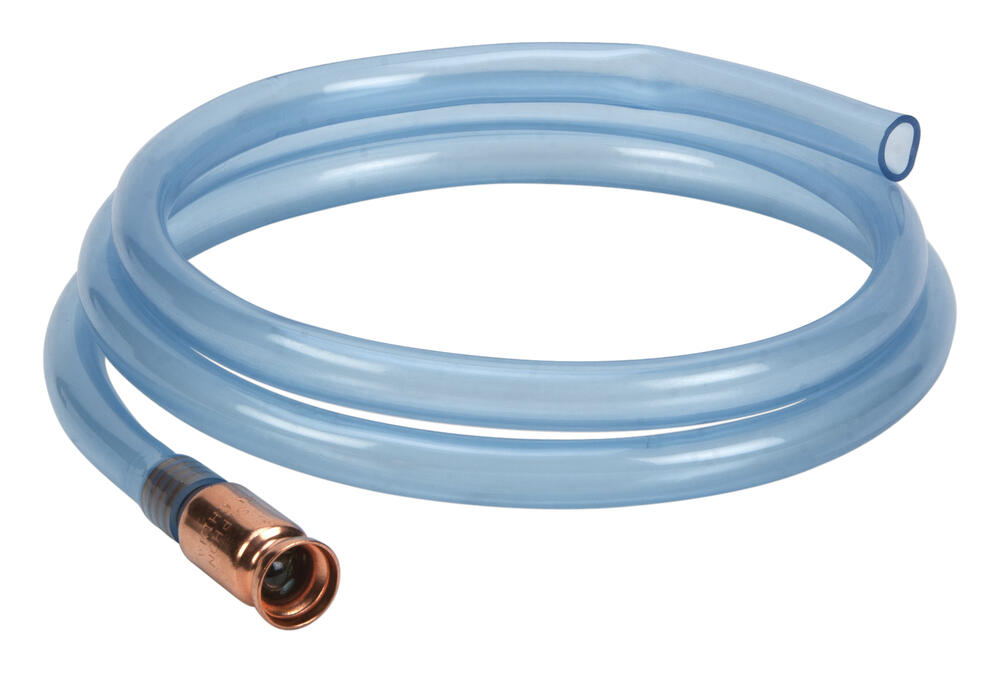

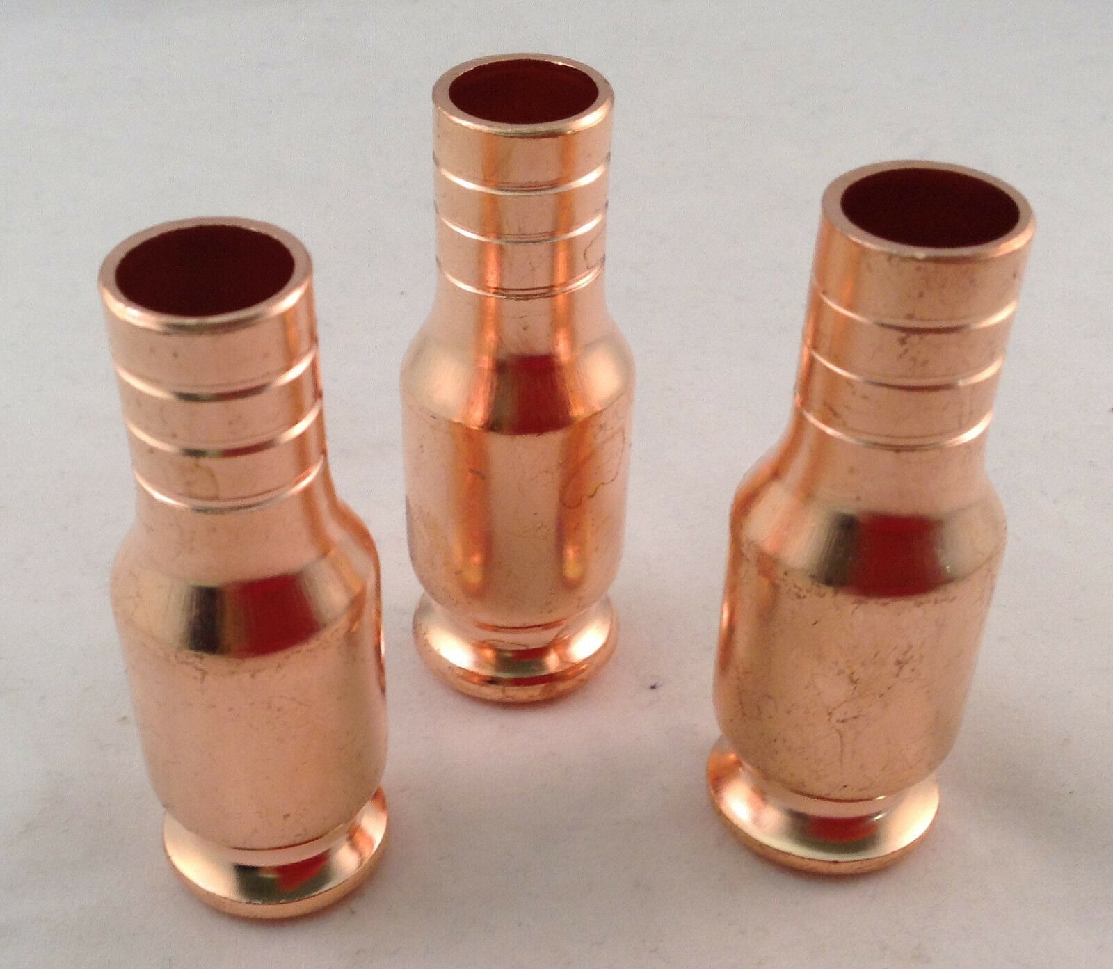

I use a siphon with hand primer from an outboard fuel hose. Set the 5 gallon jug on the hood, run siphon hose from jug to tank, pump it a couple times and it's running. Takes about 3 mins to drain the jug.

I use a couple of 55 gal barrels with a small 13gpm flow-rite for Diesel - use 1-2 barrels red fuel a year - and an IBC tote (275 gal) filled w/~150 gal for unleaded also w/a 13 gpm flow-rite but with auto nozzle (wife wouldn't use manual nozzle). I usually have the co-op fill the unleaded every 6 weeks or so but at the beginning of this year I filled the tote to the brim.

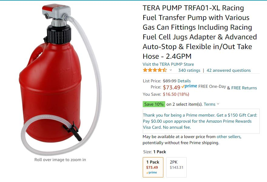

This is what I use. I also purchased the "Ideaworks JB5684 JB4840 Battery Operated Liquid Transfer Pump, red, blue, black" but even though it is less then $20. I don't like it.
/ Fueling tractor #96
I didn't read the entire thread, but this is what I bought since I have the 15gal versions of that jug pictured
