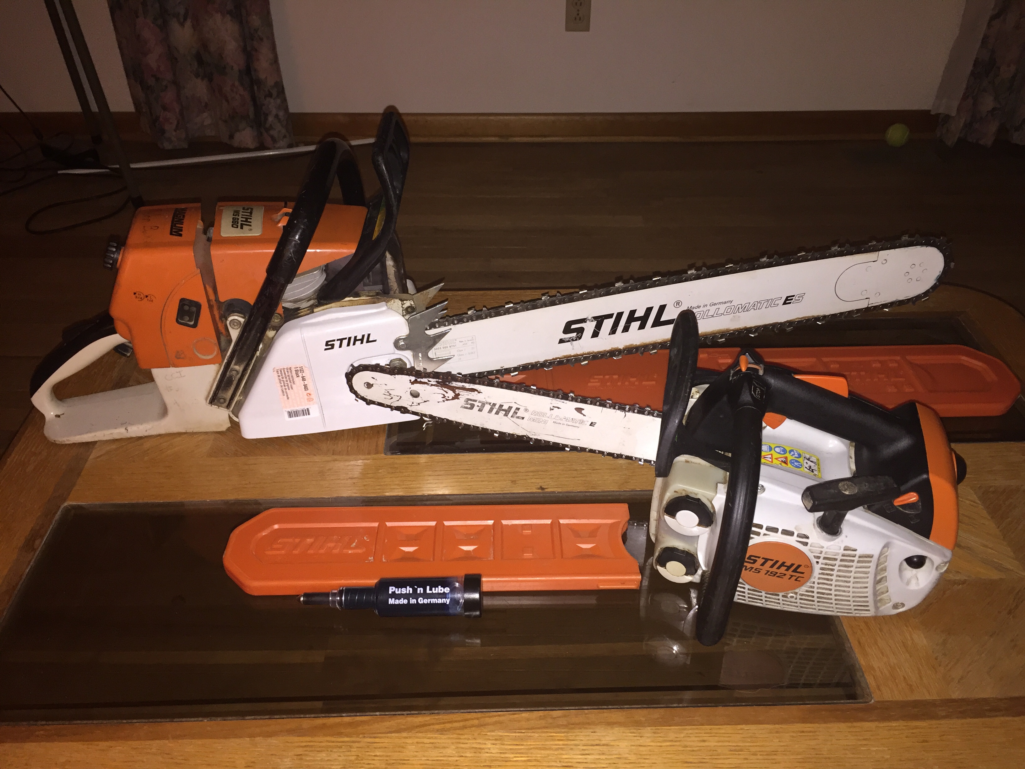

I had to put a bit of money into it but I bought a used 05 660 magnum for $500 about 6 years ago, it had a worn out 36in bar and a shot 3/8 chain. I pulled the bar and chain off, took it into my local Stihl dealer and told him to go threw it, put on a .404 25in bar and sprocket, put on duel logger style bumper spikes and replace the cracked sprocket cover, I think all that was 200-300 bucks but the end result is the best saw I have ever ran, it's so balanced an smooth it's mind boggling.
I have cut idk how many cords of wood with it in the past 6 years, it cuts so straight I haven't even rubbed the paint off the bar. The .404 chain stays sharp a crazy long time, my cousin has 25in 3/8 bar on his newer 660, he can cut slightly faster than I can being he's not cutting as wide of a channel but my saw stays sharper longer.
Just last week I pulled them out, cleaned, greased and blew out the air filters and sharpened the chains, all time two fav saws right there. I have ran a lot of diff saws.
