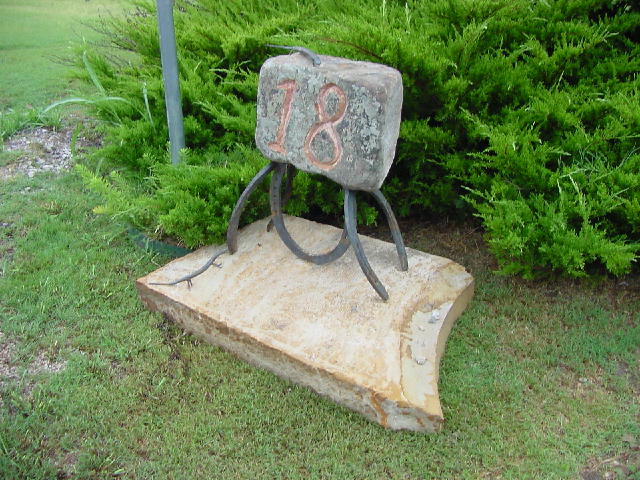

One of the really fun things to do in life is going back to see how things worked out over time.
This morning I got to do just that.
This was a project covered in pages nine or so of this thread.

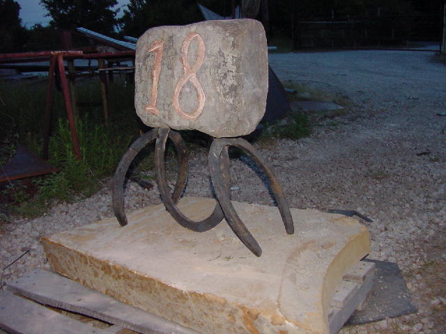

/ Fun at work
#130
It's funny how time can be so generous with somethings and really mean with others. It does seem to enjoy aged iron and stone especially.
