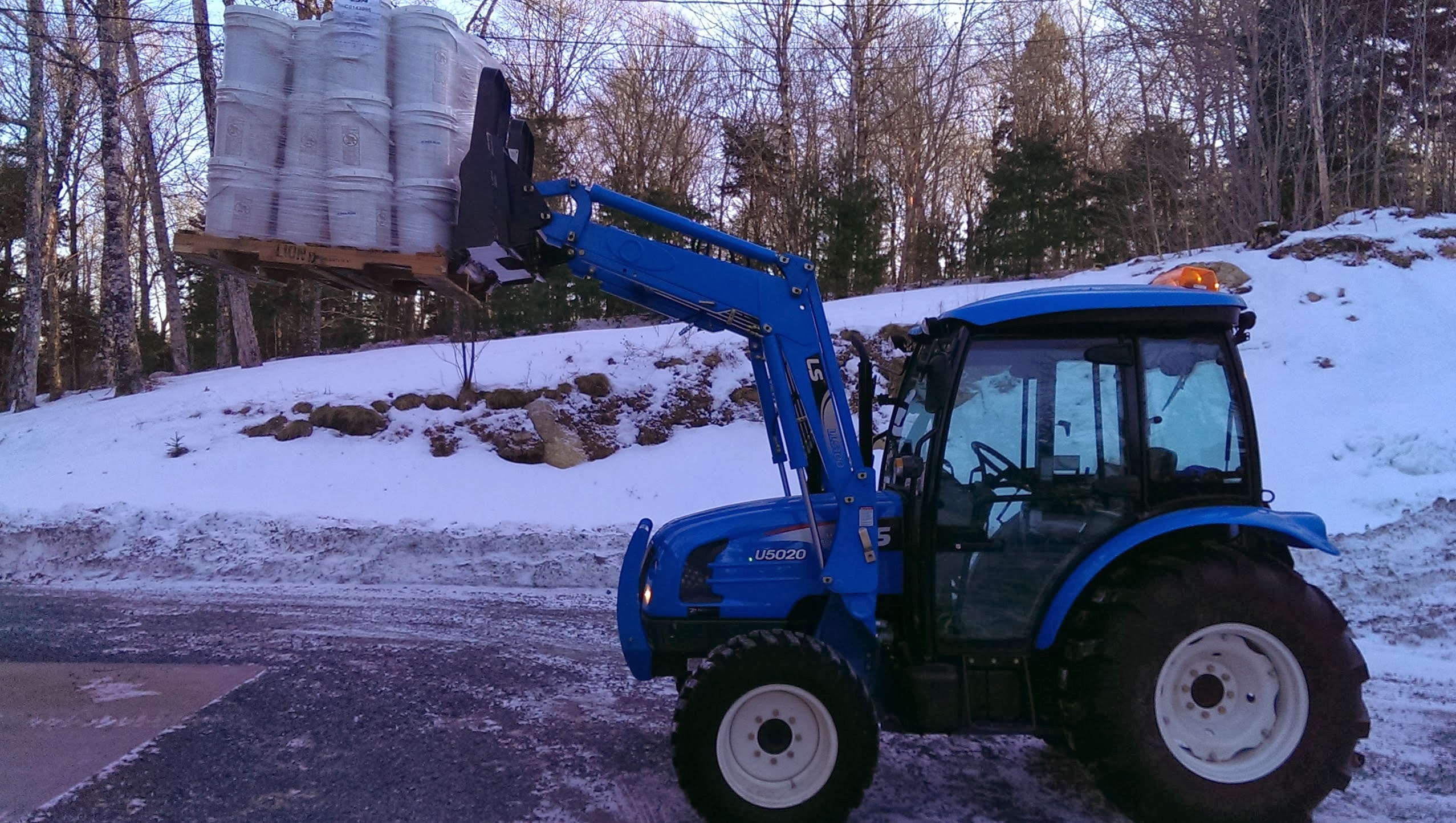

2014 LS 5020C with loaded rear tires and a LL5100 loader rated at 2650lbs at the pin will easily lift a ~1860lb payload. 42" HLA heavy duty forks with skids the quick attach. Haven't tried anything heavier yet. P.S. It lifted this from various heights to max height and curled any time all at idle . no other counter weight other than the loaded tires.

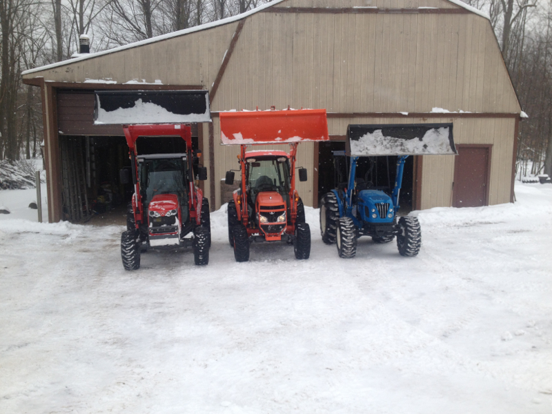

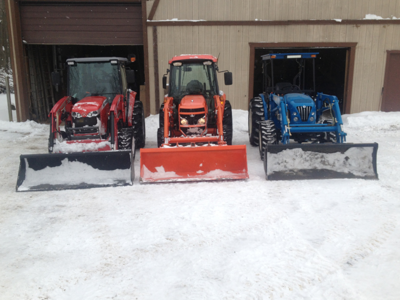

Lifting Heavy
As everyone has said, the farther back the better
A little extra help - Curl bucket - relax curl and lift - repeat until you have the height needed.
The bucket going down lets lift come up. Try it, just a little coordination needed.
