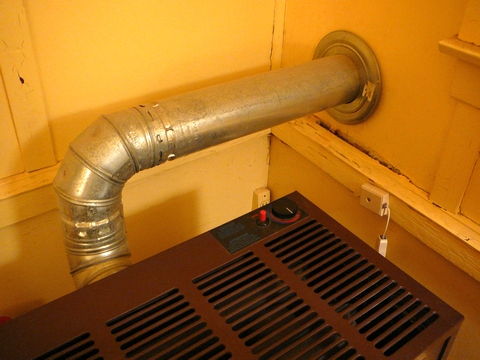

must be on a natural draft furnace, and not a vent motor assist type. Does the B vent run up through the interior of the house and exit the roof, or does it go through an outside wall, and run up the outside wall of the home ?
The latter. I just now looked in old photos that I made after we took over the ranch in Y2K.
'Cozy' space heater, if you're familiar with them. It's all we need for this 700 sq ft simple farmhouse. Our home in town is normal but everything at the ranch is farmer-designed/installed with no regard for code.
That's about 3 ft horizontal.

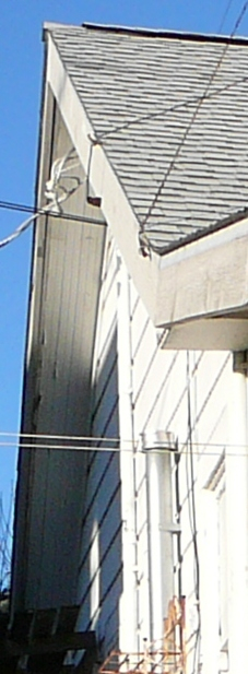

And (old photo below) the exterior stovepipe, as it was back then.
The pro took one look at that, said 'There's your problem!'.:) Then he added an offset, that extends above the roof.
No problems since.
Occasionally its worth what it costs to get someone in who knows what he's doing. I never would have thought that was why the vent safety device was tripping - because it needed a taller vent.
No problems since.
Brand really doesn't matter. Down here we call them circulator heaters. Usually, you would go up off the back of the heater to establish draft. Yours off the draft diverter with 2 90 deg. ells which in it's self can cause problems.
But that ''pro'' is correct, that vent should go above the roof, but I have seen them operate just fine like your's is vented
