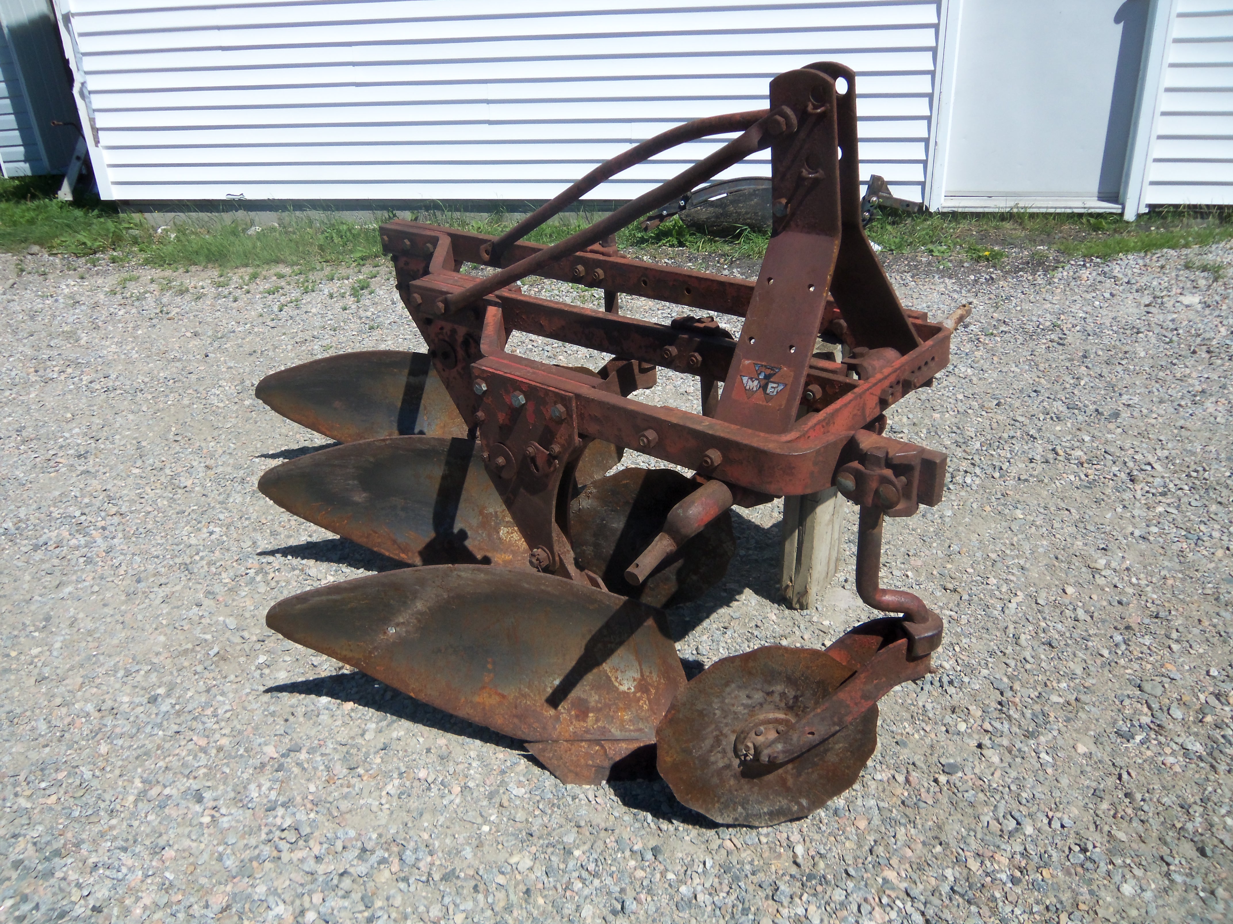

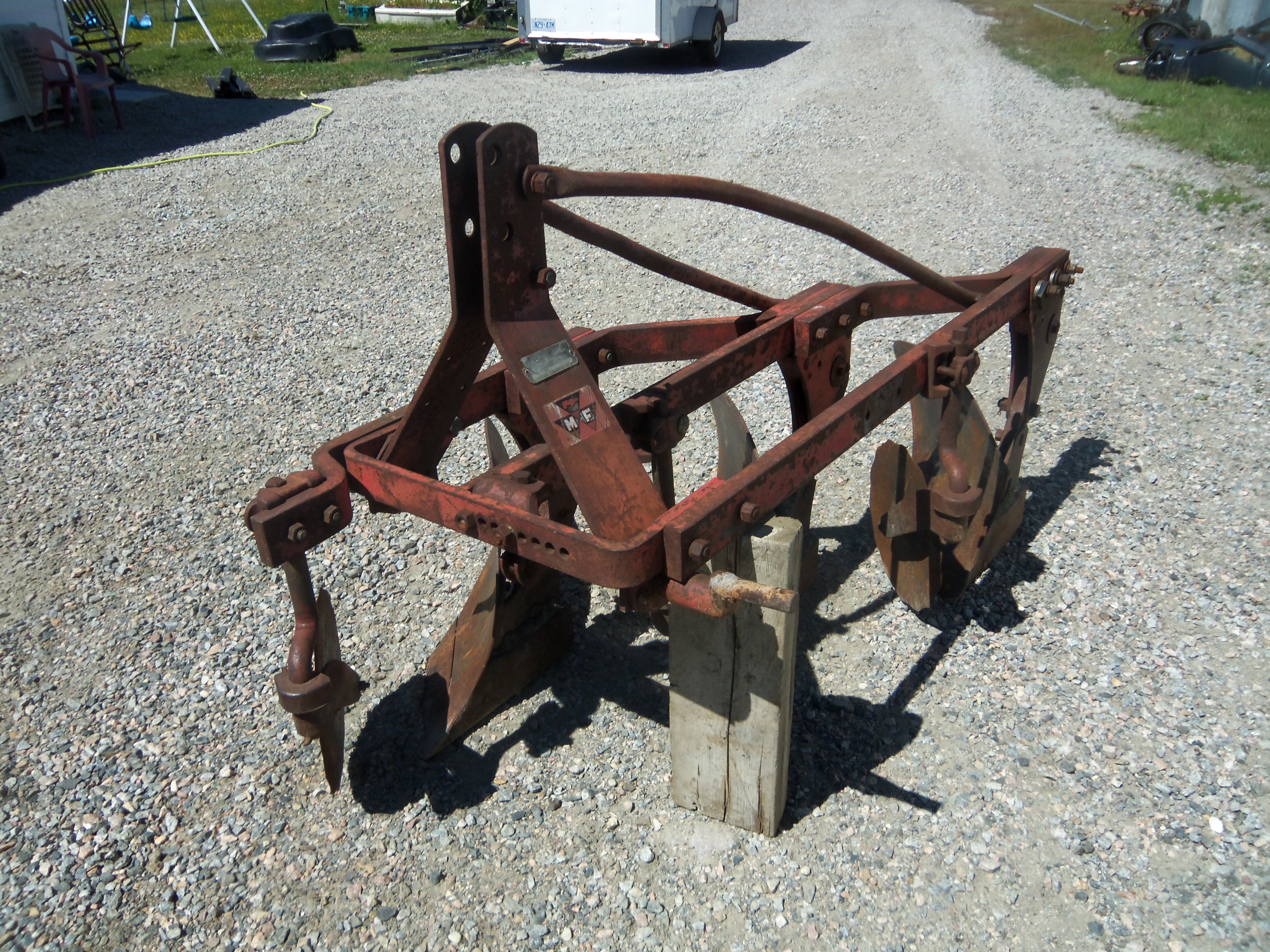

Now a L4060 had B2650
Just pick up this nice massy furrow plow today. When I got home started to look at it closer and notice the 3 pth are to big for my b2650 the pin are 1 1/8 big and the plow is very heavy . Now wondering if I can make it fit , can my tractor pull it whit 003.JPG001.JPGhout braking anything. The plow a model 70 3 furrow. what do you think

Unless you have light easy pulling soil I doubt that a Kubota B2650 would pull a 3 bottom plow.
Not sure but it might lift it.
   / furrow plow to big #3
You could always remove one of the plows (left side) from the frame. The Cat.II pins are your big problem.
Myself, I would look for a better set of 14" two bottom plows with Cat. I hitch pins. Smaller and lighter, which would make it a much better fit for your Kubota.
   / furrow plow to big #4
I don't think this is going to work. It's wayyyy too much plow for your tractor. If you can get it attached to the tractor I don't think you'll be able to lift it more than a few inches off the ground at best. Your lift arms are going to be most of the way up by the time to hitch it.
If you park your tractor beside this plow it will start weeping..... ;)
Edit: I pull this same plow with my Ford.
   / furrow plow to big #5
Nice looking plow-but way too big for any B. 2-12" plows are all that are recommended for my L3560.

Thanks guy I but the plow back up for sale .After seeing how big it was beside the tractor I was sure it was to bit. So tomorrow am going to see a 1 furrow massy plow I think this will be a better plow for my tractor.

Nice plow, and I'd like to have it but it's about 3 times too big for your 2650. Indeed, my L6060 with draft control would not touch that plow in my ground.
If you really want to plow with a 2650, look for a 1X12 plow. Better yet, get a roto tiller.

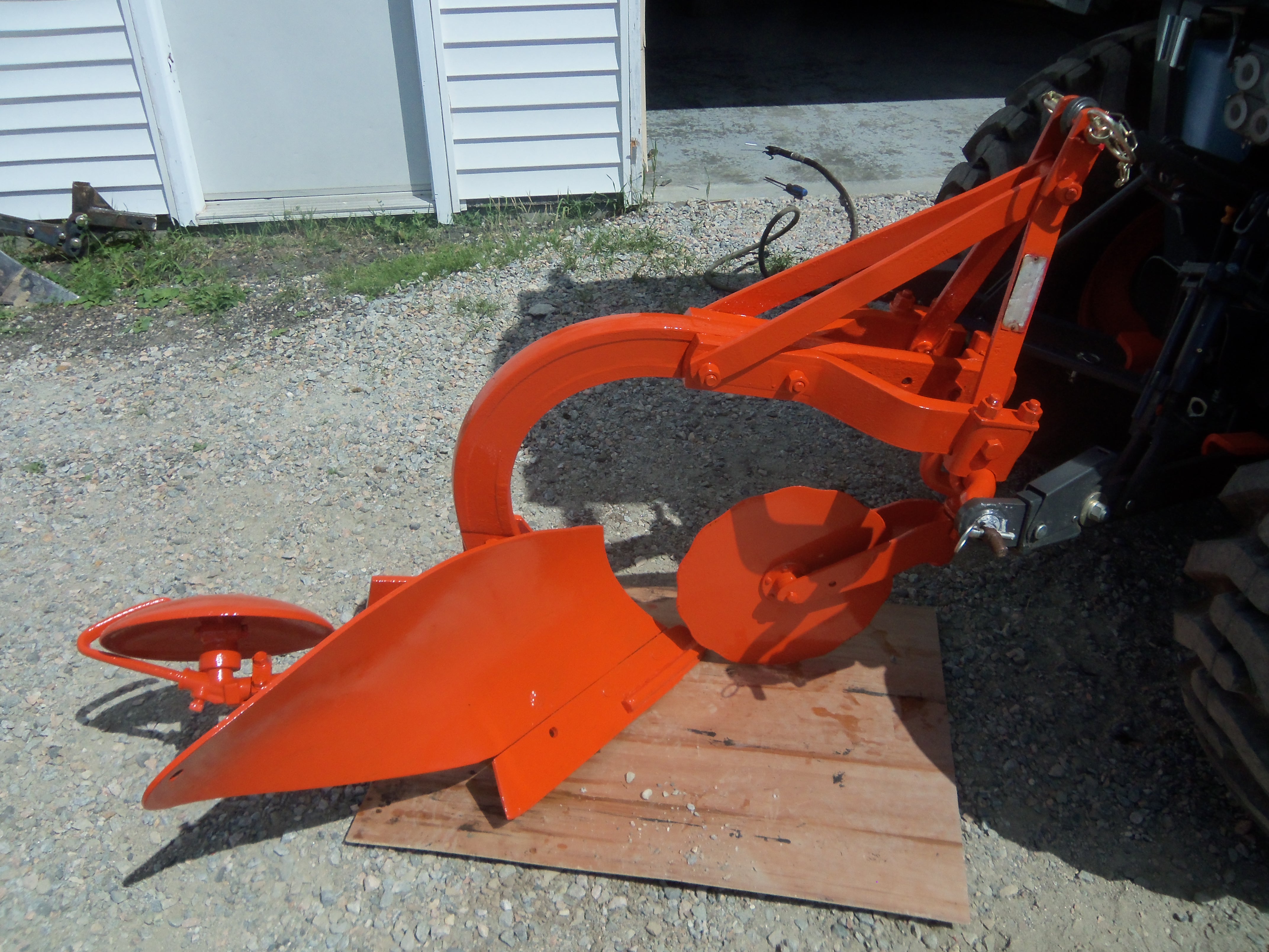

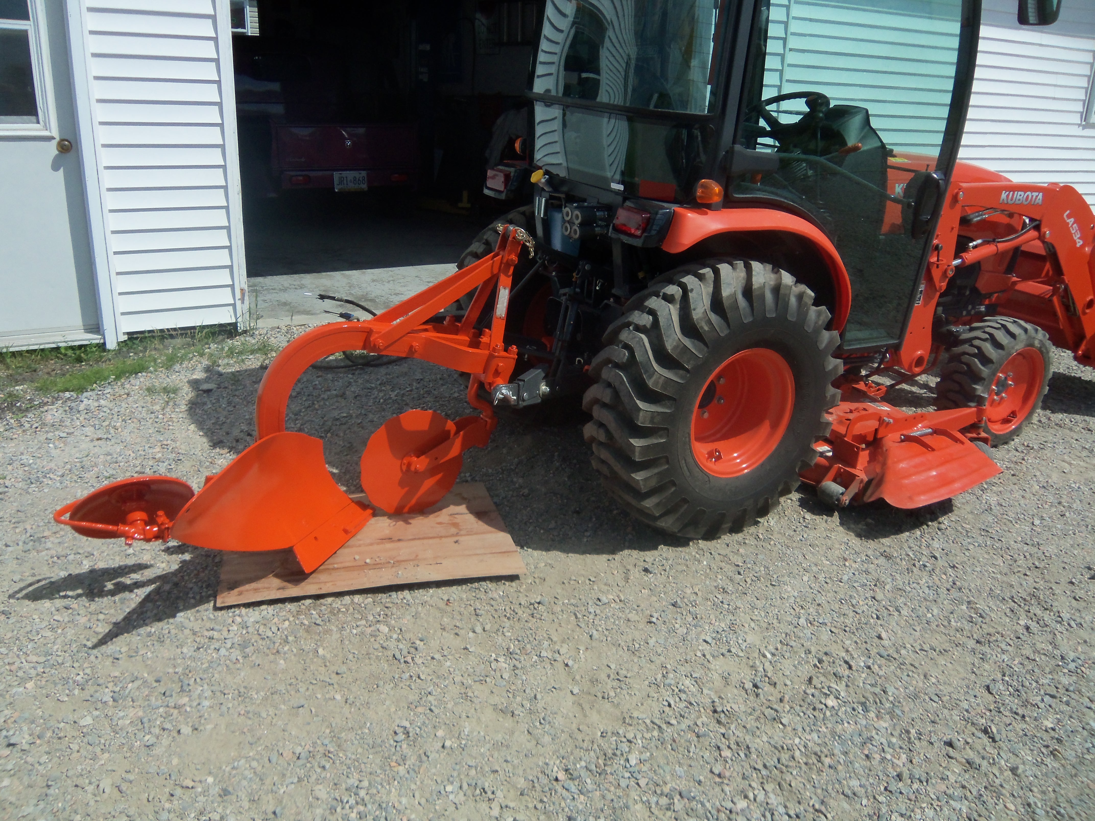

Well here is what I pick up yesterday for a good price 100.00$ .The front wheel was not on it I had one here look like it going to work and I just had to paint it orange you can call it massy orange lol.

There you go much better!

The plow is actually Category II as the OP stated the pins are 1.125" diameter. Category I is 0.875"
Nonetheless, the plow is too big for the OP's tractor. A single bottom 14" (preferred) or a 2 bottom 14" (ok) would be better.
The old 19hp Farmall C can pull 2-14's.
The new single bottom plow you got is nice! I have the same one but a little older...my A-frame is all cast iron where yours is fabricated steel. The front "wheel" is called a coulter, by the way! I just re-bushed the furrow wheel on mine last week...check to see if it's wobbly on its shaft. If it is, you need to bore it and install a bushing...it's just steel on steel with a grease fitting. I ground the rivets off the hub, chucked it up in the lathe and indicated it true, bored it out then made/installed a new bushing with a very LIGHT press fit...worked like a champ.

Nice , and your 2650 will be much happier .

yep am sure it will .I dont like to abuse my stuff . I know it can take a lot but like to take good care of it .

OK, let's see it in action now. Drop that thing in the dirt and let it rip. Did you mention what implement you will be using after the plow and what you'll be doing with the ground after it's worked?

Soon it to dry right now ,I try it a bit when I got it I cant wait to give it a real try .I just got a piece of land in the back yard about 100 x 200 that id like to get nice and strait afteram done plowing I have a set of disk that am going to run over to brake it up. Am planning on doing a RC track for the kid well and me.
