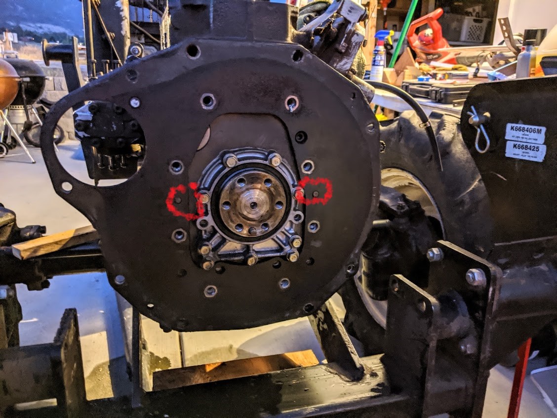

Looks like dowel pins in red circles. If so, they are probably holding some.
