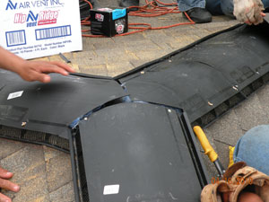

You do not install both "systems" in the same application.
You do soffit and ridge vent or gable vents. Pick one but not both.
I am a fan of this type of ridge vent not the rolled SOS pad. hipridge-install2.jpg
