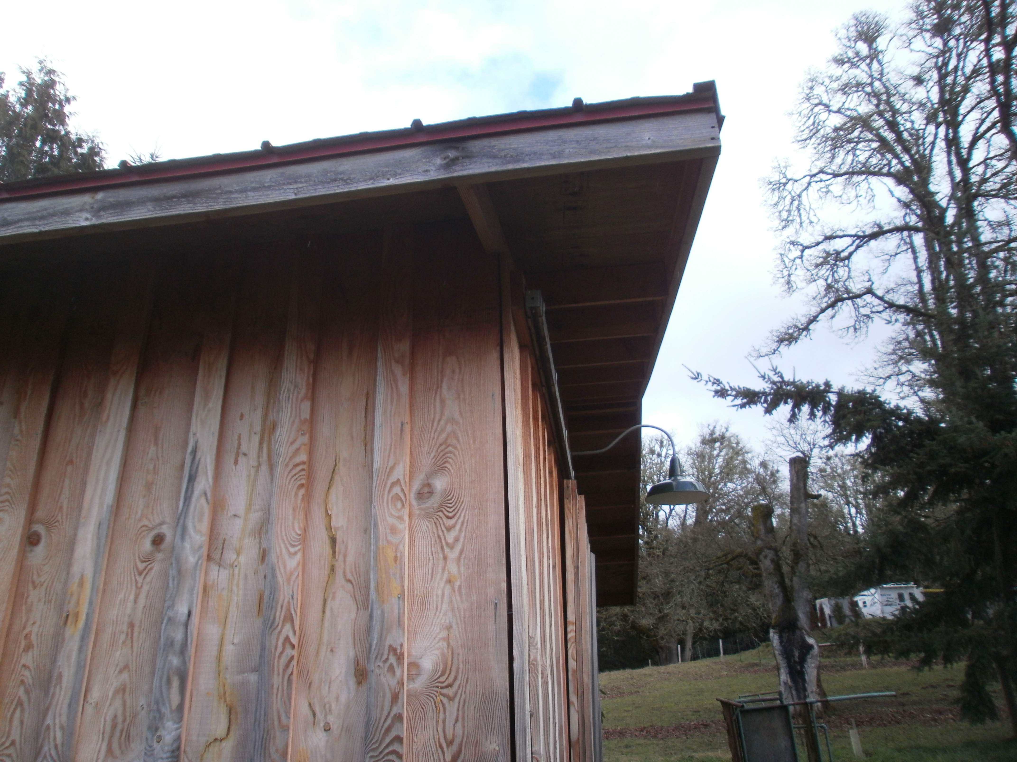

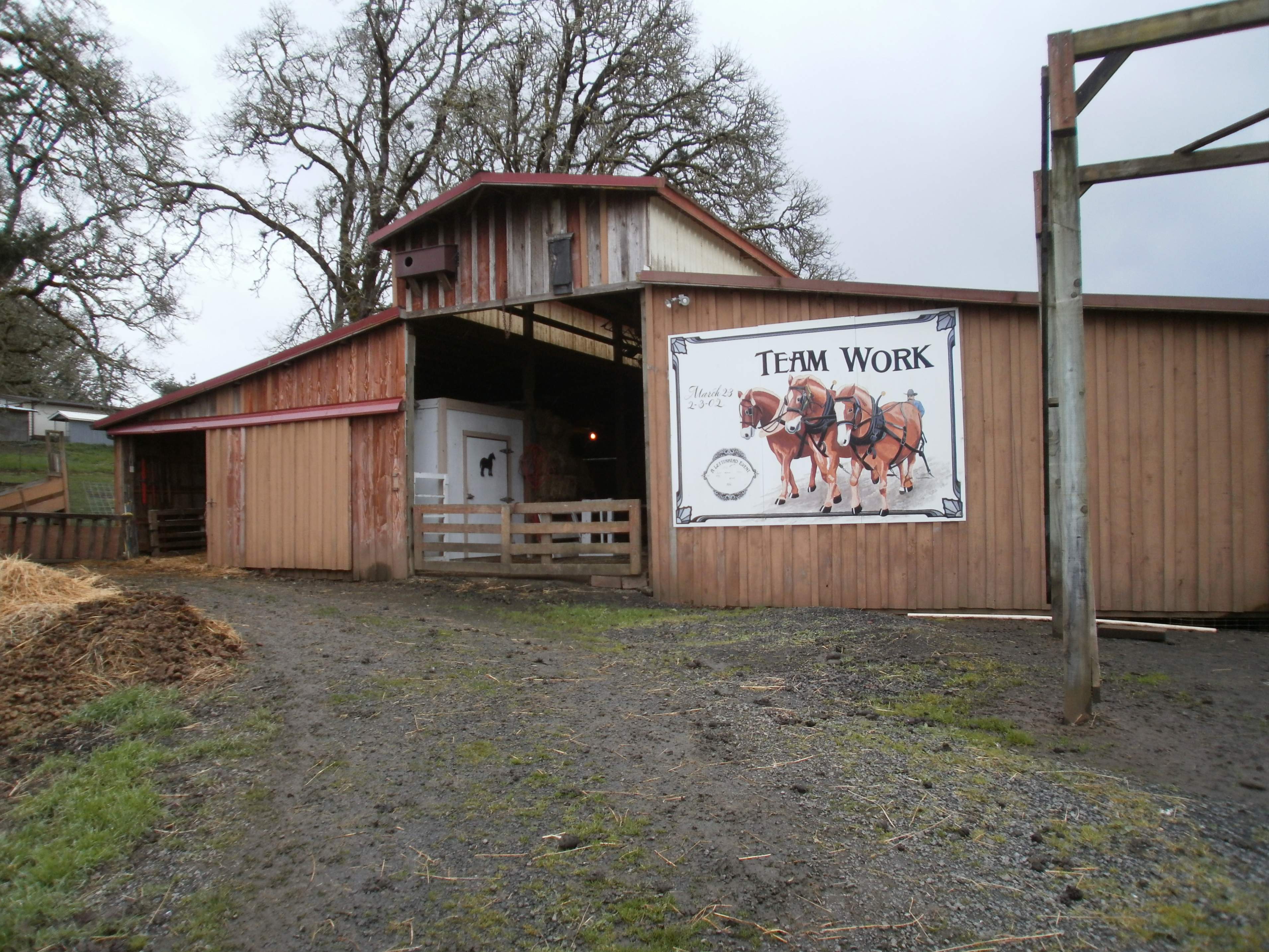

I like eaves. eaves are a friend of mine
the big barn was built over a period of years and I stuck small overhang on it. I said next time I will put proper eaves on the next building, and never regretted that. I like'm.

yep that is a bat house on the right side, in the photo. On the left side is an owl box. We have had moderate success with this owl box so far,it took them a while to find it, two years to be exact. We have had a nesting pair the last two years.
The bat box really shouldn't have been placed where it is. Sometimes the barn owls will intimidate and or eat the bats. Best to have the two in much different places.

To return to thread-related topics, the benefit of wider eaves is made obvious by your pictures, the siding protected by the overhang of your eaves has very little weathering, and no water staining or damage, in contrast, below that where the wood no longer in the rain (and sun) shadow created by the eaves, the weathering and water damage is easily seen.
This why we are trying to extend at least the side wall eaves on our house another 16" to get to a 36 total overhang (not counting the gutter) when we get it re-roofed later this year- if we can find any way at all to afford it.
