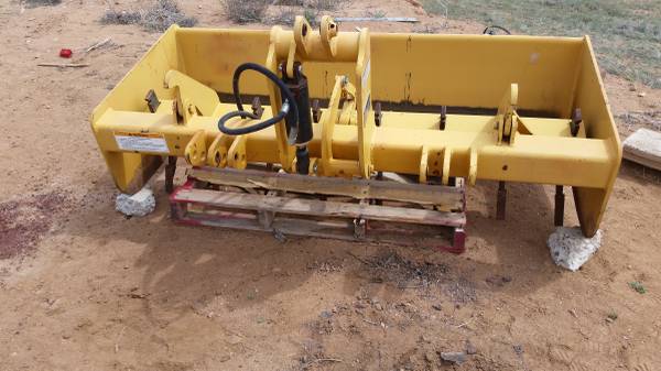

Thats a pretty descent price my 88" gannon was $3750 plus tax and hoses. As others mentioned its not qh compatible. Possibly if you turned the cylinder around. The top link pin is also about 6-7" higher than a standard qh.

IMO, if u can find a good used Gannon that will fit your tractor and save $1k+, jump on it. I don't see them come up often. Mine is a 78" and only extends abt 3" outside of the tires. Wish it was 84" but at $1.3k I jumped and am so glad i did every time I use it.

That is a fair price for this box blade. I suspect it is a 7' model not a 6'. It is not quick hitch compatible as is. You can modify it to work for quick hitch as mentioned. I have a similar model for my 4520 and this should be a good match for your new tractor. \

I believe you are right! I count 8 scarifiers on it.

Are you sure that's a Gannon? It looks identical to a Frontier branded blade I saw.
edit: I see Jenkinsph's blade is labeled Frontier but looks identical to the CL ad blade from the OP. Are Frontier and Gannon the same blades?

Most certainly a Gannon, another pic shows the name.
I may or may not try to convert to Quick Hitch. If it ends up being on most of the time like I think it will, then it probably won't matter so much.

That is not the same blade as steve's. His has a hinged high back.

It has the hydraulic rippers. But how hard would it be to make this compatible w/ a cat 1 3PH? I have quick hitch too.
It is not QH compatible (the lower sidelink ears need to be slightly extended), but you can make it work and if the price is right, snap it up.

The Frontier's that look like Gannons are made by TuffLine and are QH compatible. However, the TuffLine/Frontier scarifiers are stamped, not forged.

Recently I think Frontier has switched suppliers for box blades. My box blade was made by Gannon and is a 2004 or 2005 model BB1284 which has the tailgate and weighs 1260 lbs. It has 8 ripper shanks.
