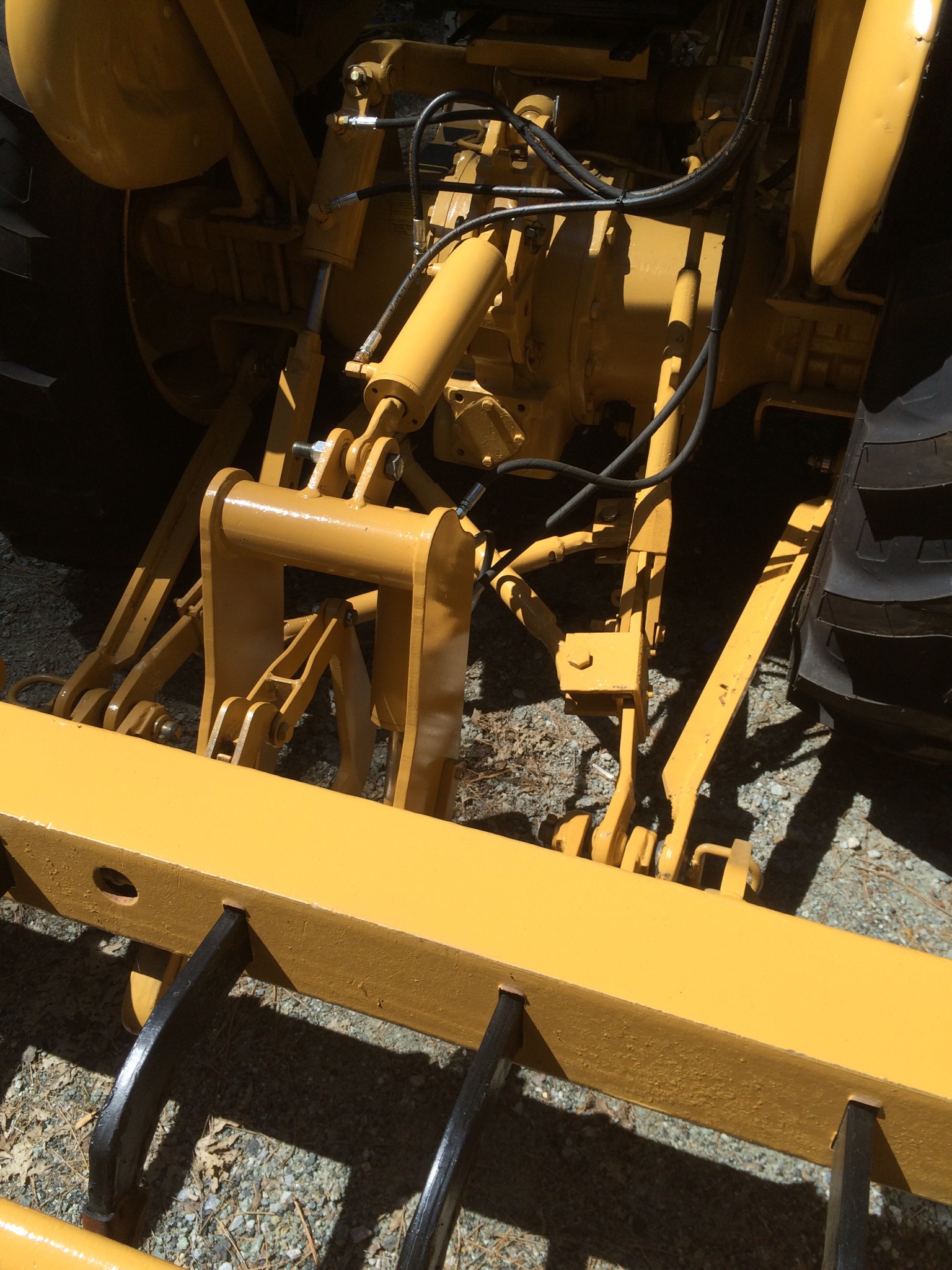

What I'd recommend would be to go with Surplus Center or baileys for a couple of inexpensive cylinders and and depending on how many remotes you have maybe a diverter valve setup mounted right on your box blade.
Cylinders such as these;
Tractor Top Link Hydraulic Cylinders | Hydraulic Cylinders | Hydraulics | www.surpluscenter.com
Any of these for your top link and something like the last one on the page for your sidelink.
This would get you going then order the nicer setup such as MtnView has with all the necessary valving and quick connects you may need,
One thing I would recommend when getting any valving you may need to add I would recommend that at least one be a front end loader type with a joy stick especially with the fore and aft movement having a float position and your left and right movement can correspond to any angle or tilt you are working with that way you have at least one control that you don't have to keep in mind that forward is left and rearward is right or whatever combination you end up with.

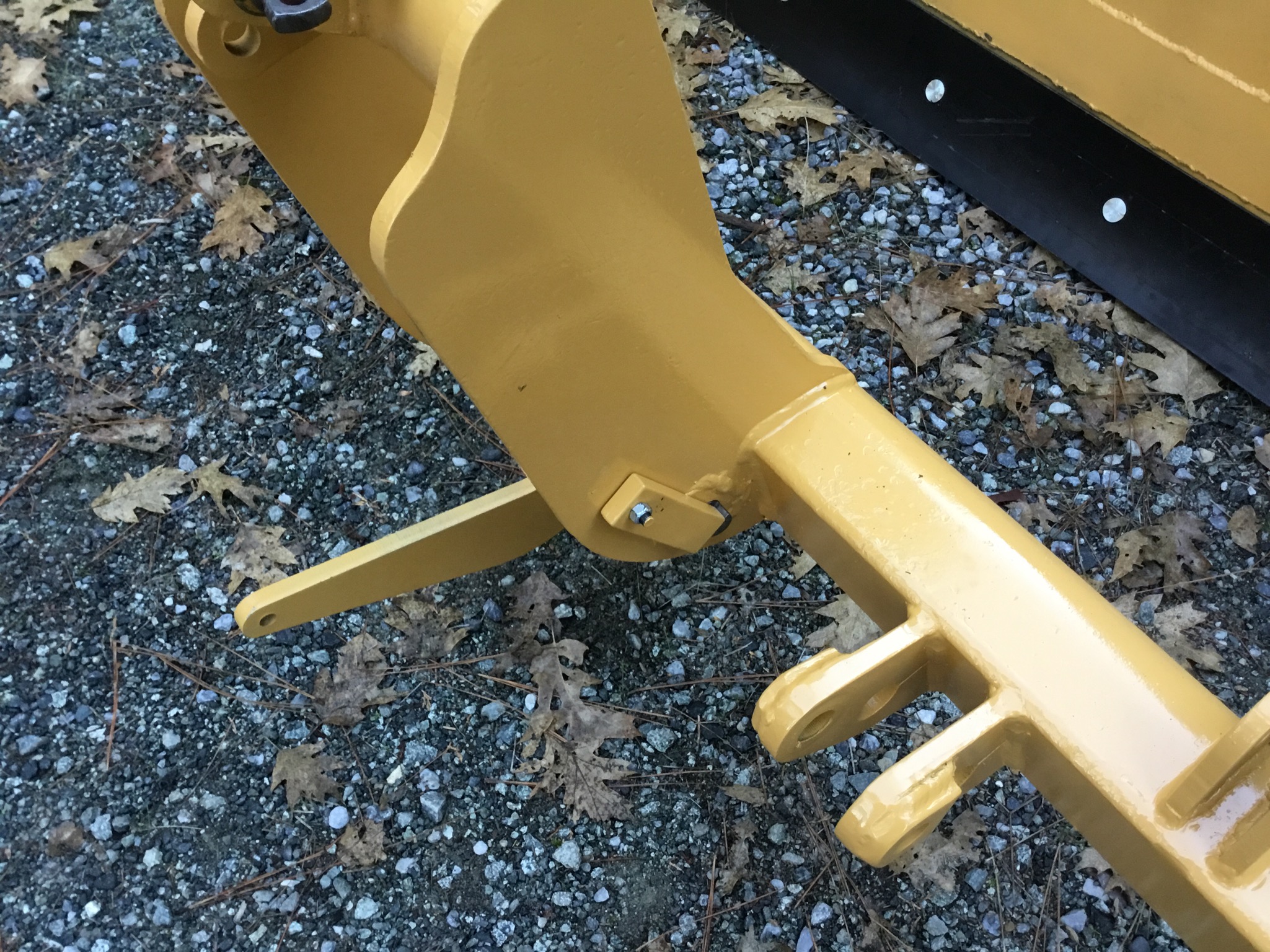

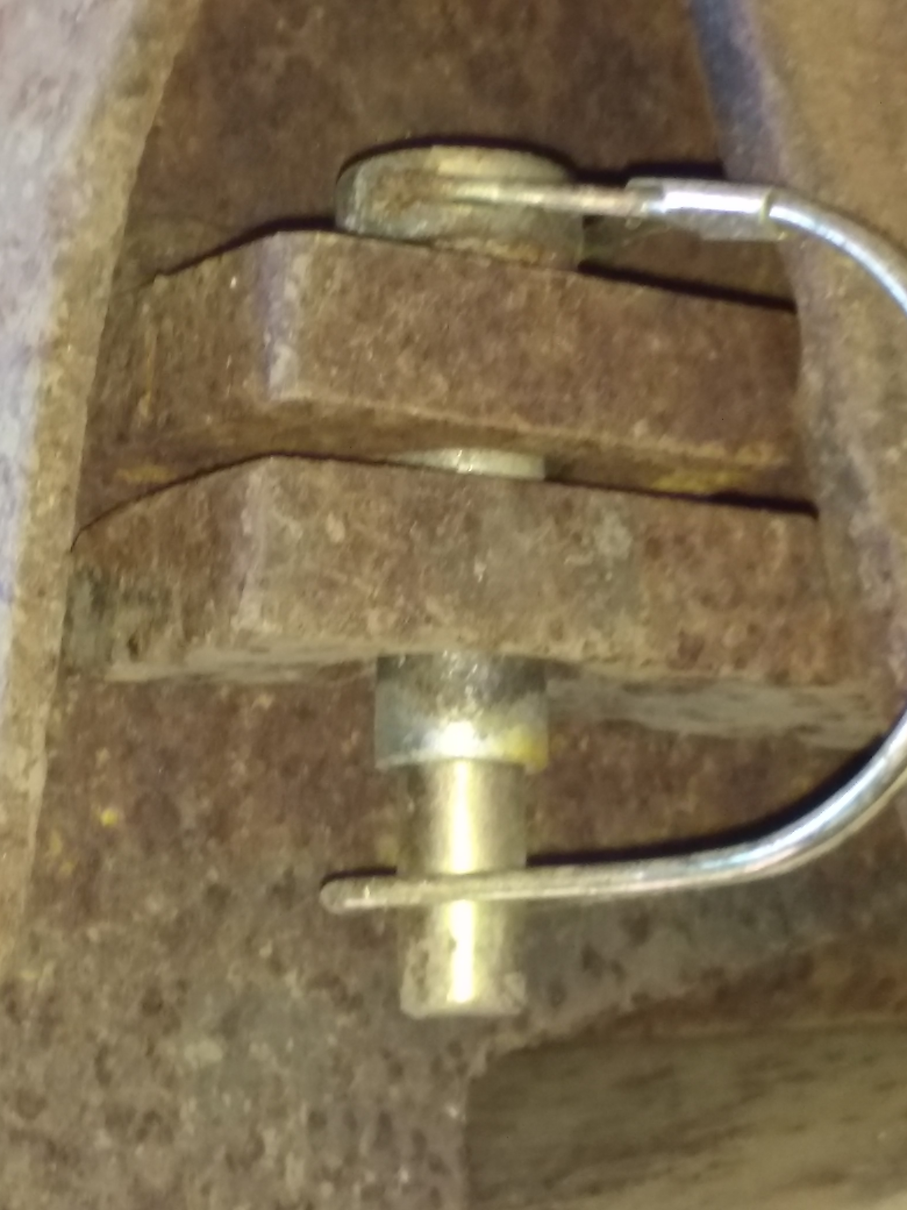

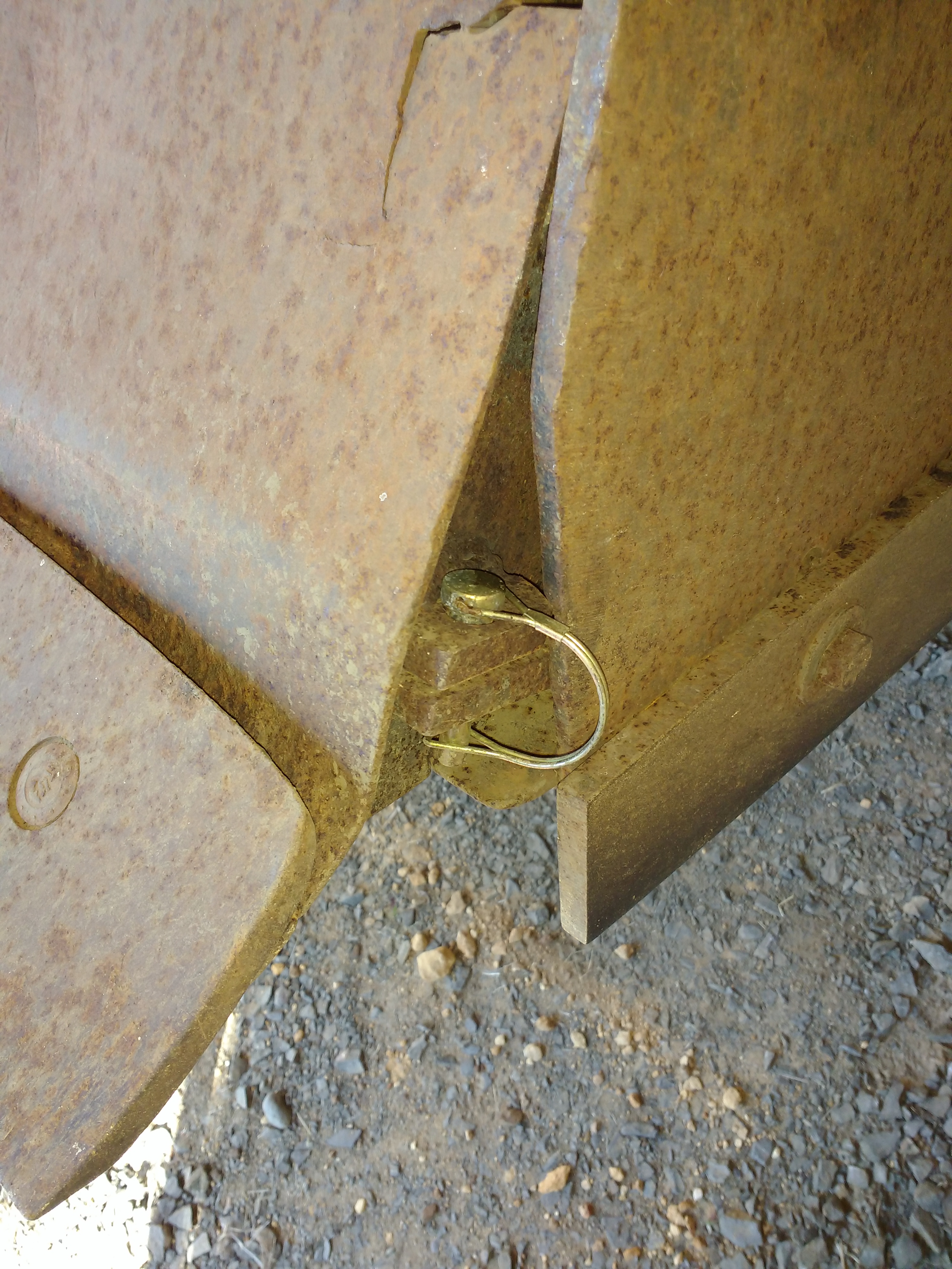

"I don't see any way to lock the tailgate on this box. Not sure why I'd want to lock it, but have watched the EA guy explain pros and cons of locking vs floating. Any input from the folks here? "
Looking at your pics, you may only have part of the pieces - at the bottom rear corners where the corner of the back blade and box are near, there should be two tabs; one on the hinged blade, the other on the box - there should be a removable bolt on each end of the hinged blade connecting those two tabs to each other; this locks the rear blade to the box.
Nope no tabs, etc. on either piece and nothing to accommodate them on the gate at least. I can fab something up if needed, but for now I'll learn to use it as is.
   / Gannon/Woods HD4272 hydraulic box blade #55

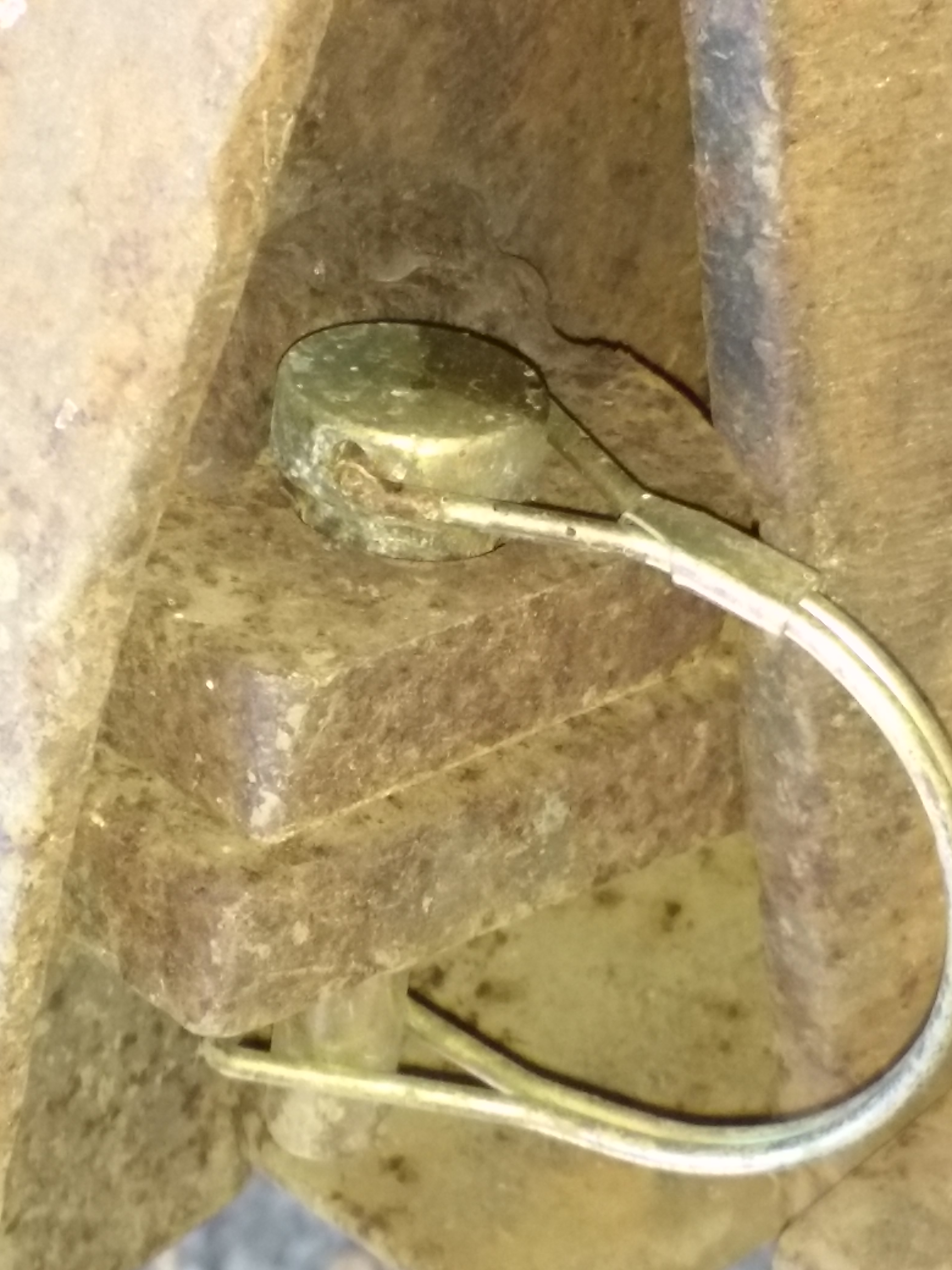

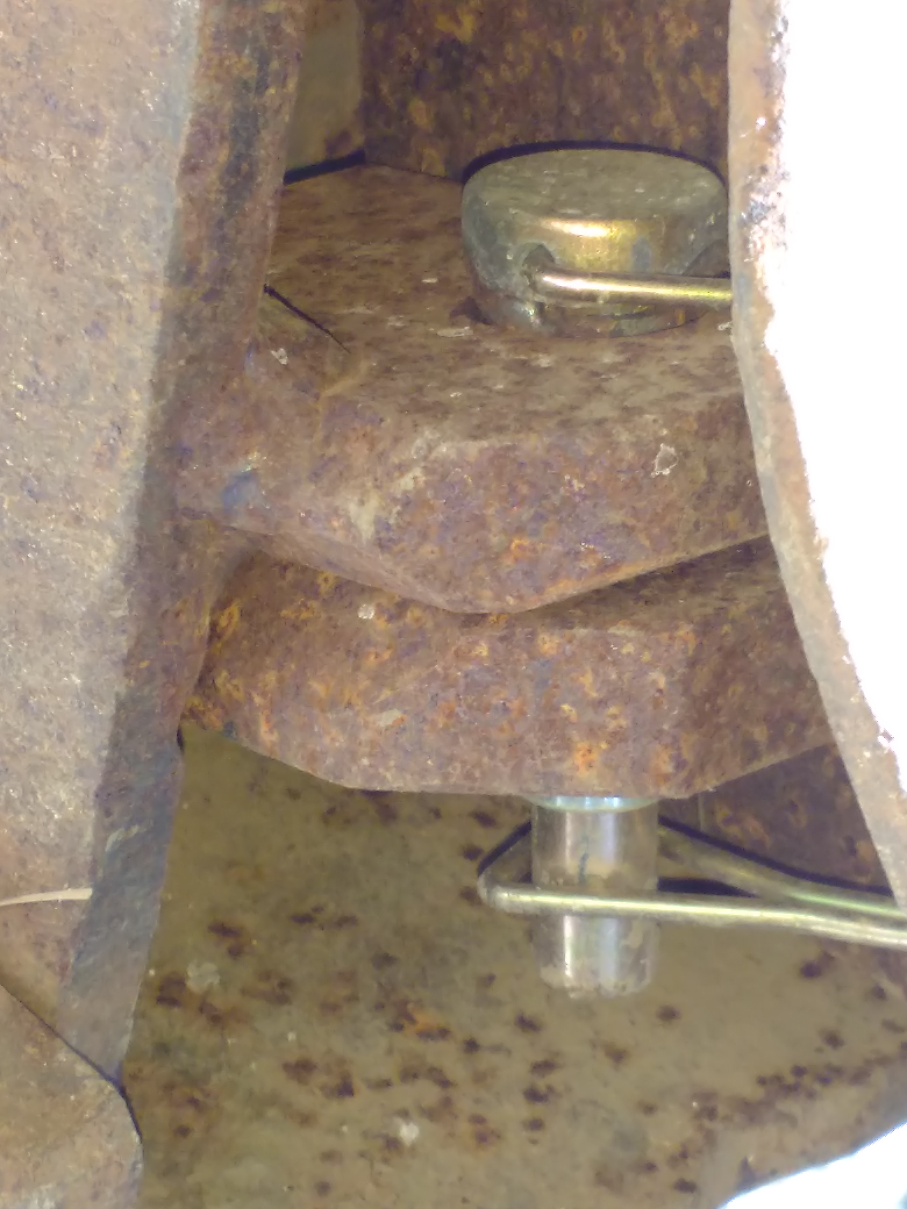

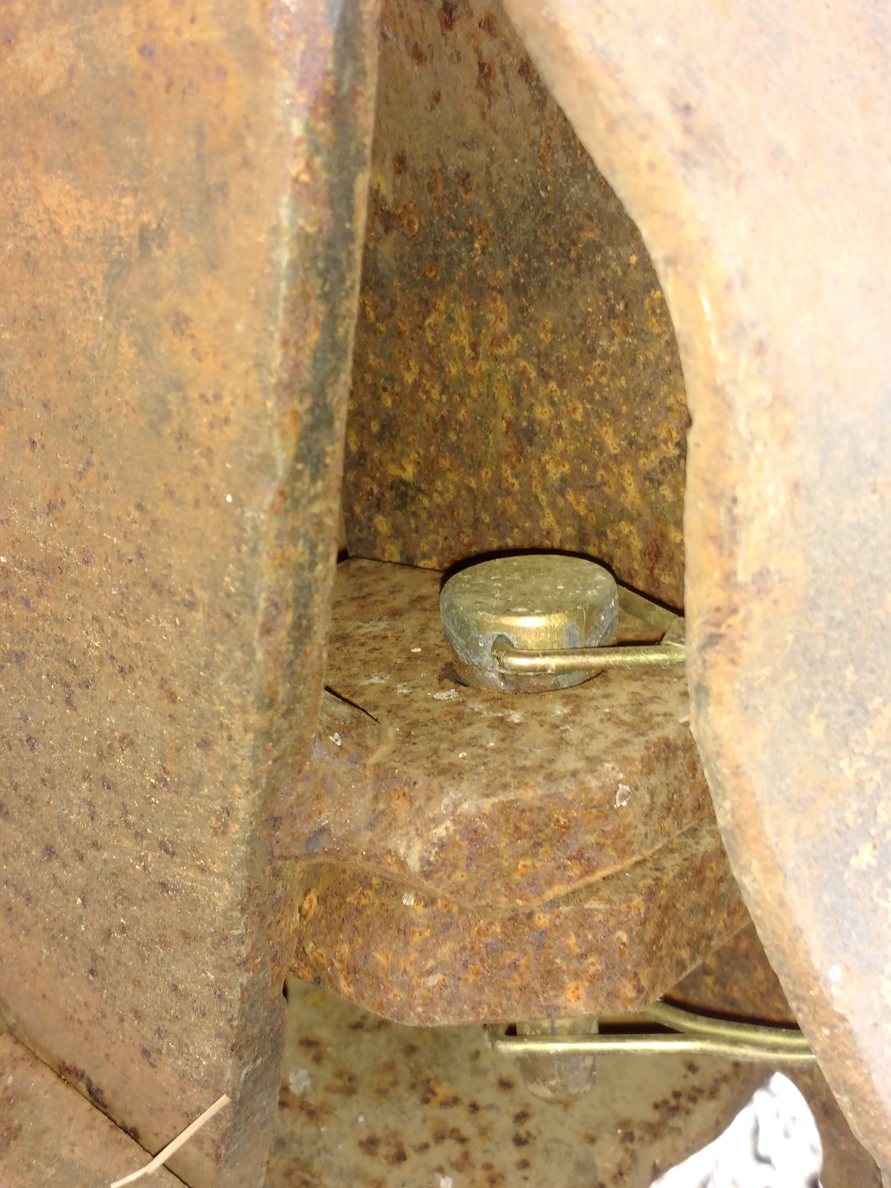

Yours may have never had 'em - not sure on all the iterations of the Gannon, but I've seen various box blades that have fixed rear, hinged rear, and hinged LOCKING rear - when I get a chance I'll grab a couple shots of mine and post 'em... Steve
   / Gannon/Woods HD4272 hydraulic box blade #56
As promised, here's a few shots of the rear blade latches on my old Gannon... Steve
