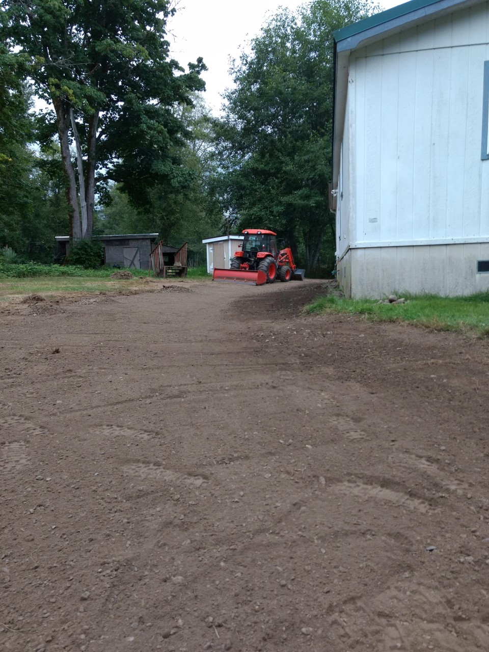

Yup! the weight plus the cutting edge will really get a bite started and then just keep pulling down. I've moved along making rolls of sod as I went (curling up and on to the front of the box blade, thereby adding more weight for more bite). Slow and steady is the mindset to use. Going slow allows you to make fine adjustments to the fore/aft pitch for a more smooth grading. I find that finish grading works best in reverse: and this REALLY requires one to go slow! Here's some recent work I did (I am grading in a drainage "V" at the back of the house as the ground at the back slopes down to the house [I used a manual landscaping rake for smoothing and surface rock removal]):

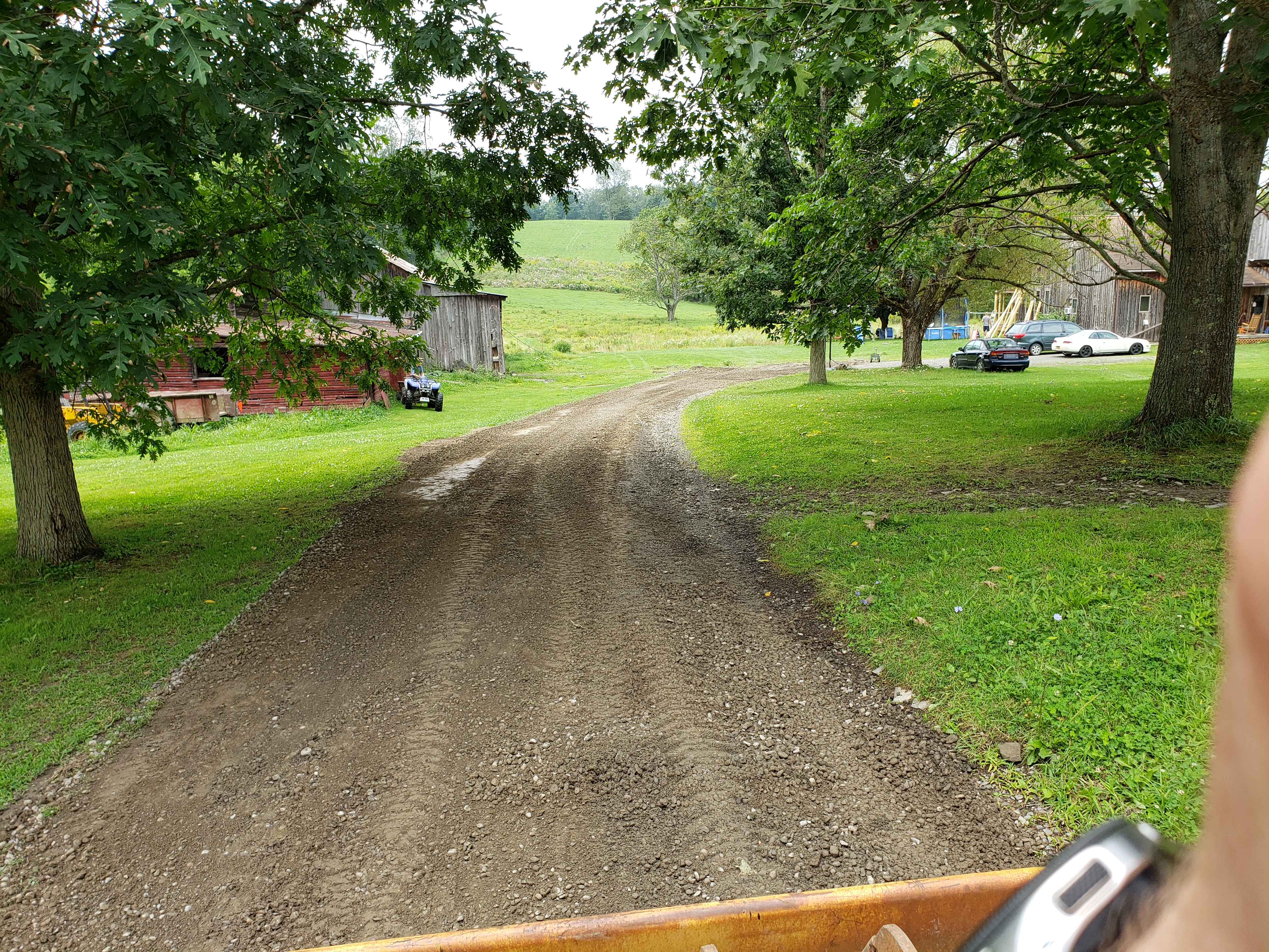

A little video of the beast in action. I had forgotten to disengage the parking brake during this run. Seems to work very well. That high back box holds a lot of material. When it's loaded up, the tractor does work a bit, but I lose traction on the front wheels before I run out of power. I was only running around 2000 RPMs, Low gearing and pretty much wide open on the pedal. Next step on this driveway is angle the box to cut a pitch on this driveway to the left side (see photo) so water drains off instead of running the right edge of the driveway into the parking area.

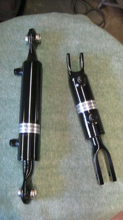

If you want to be able to tilt an equal amount to each side, this is what you need. Pretty sure no one else provides this capability for your model of tractor.
$885 plus shipping costs for a complete top & tilt set.
20 week lead times, so get in line ASAP. ;)
