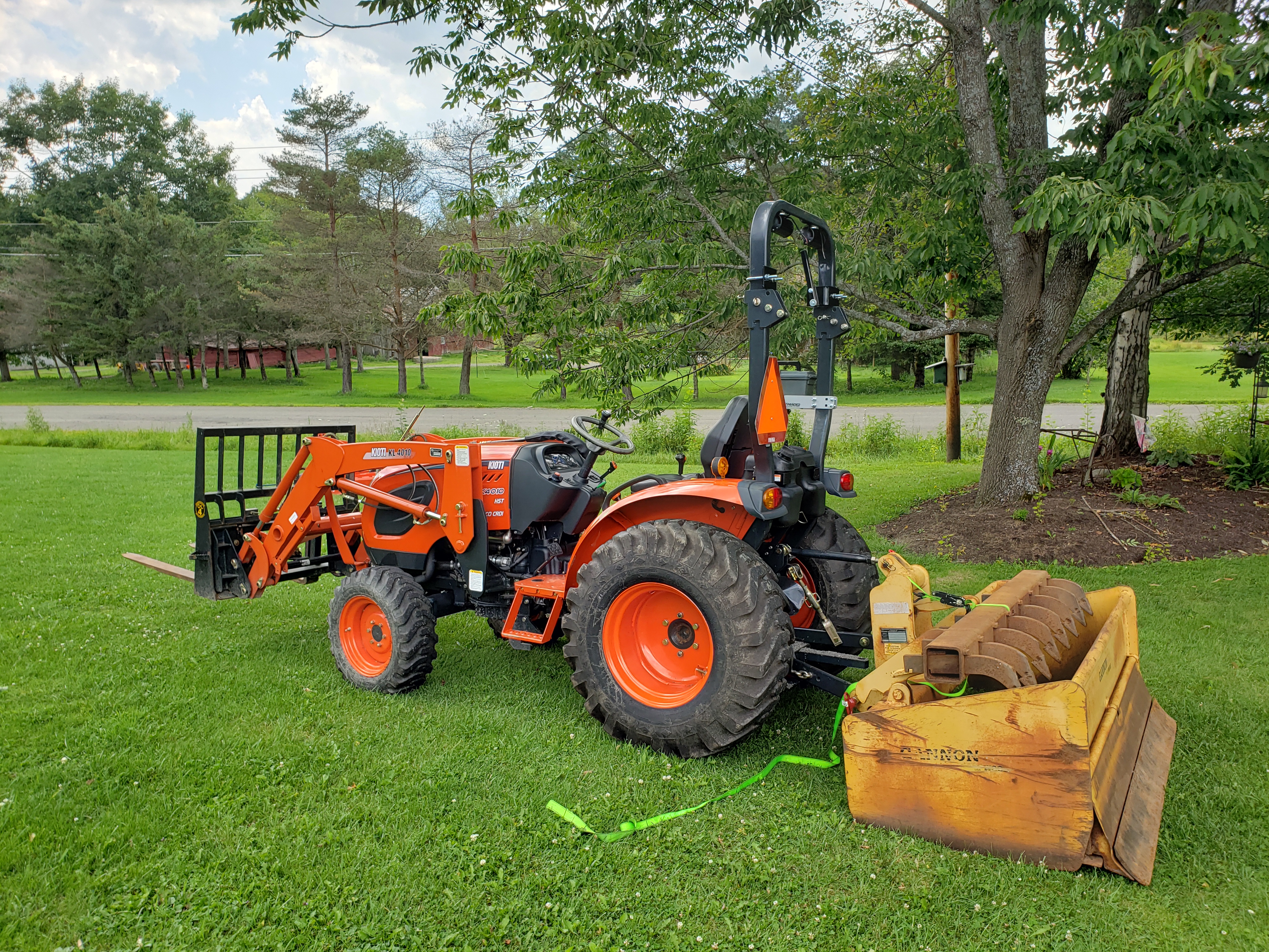

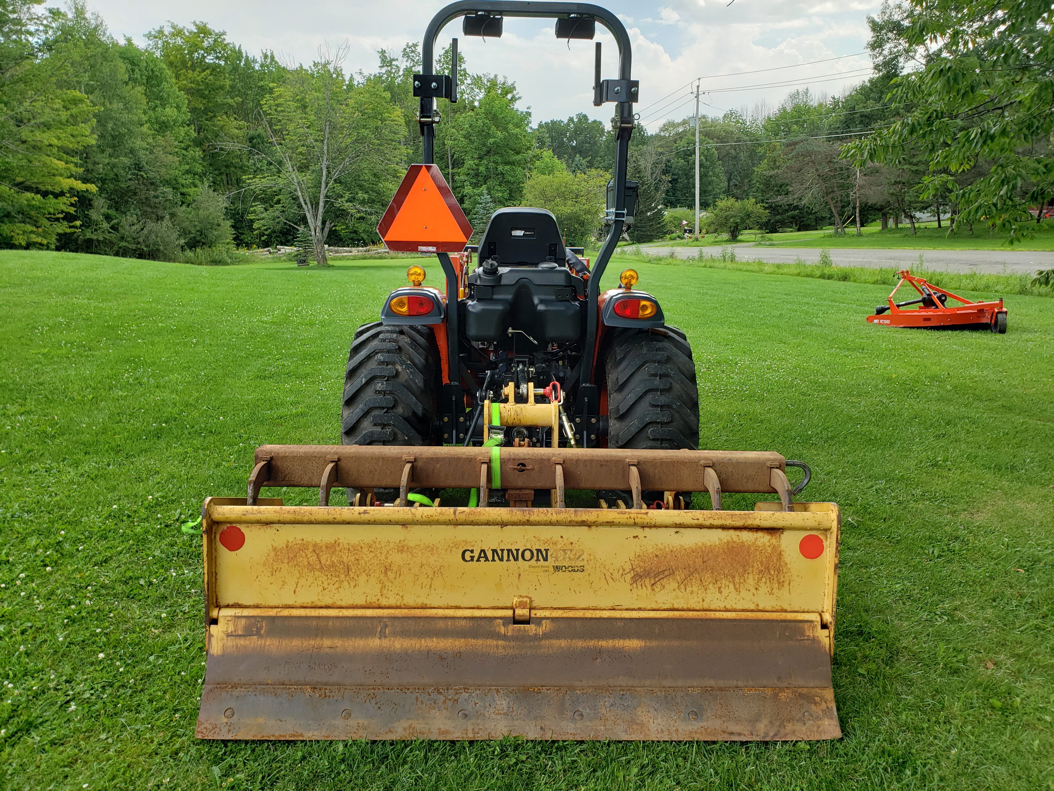

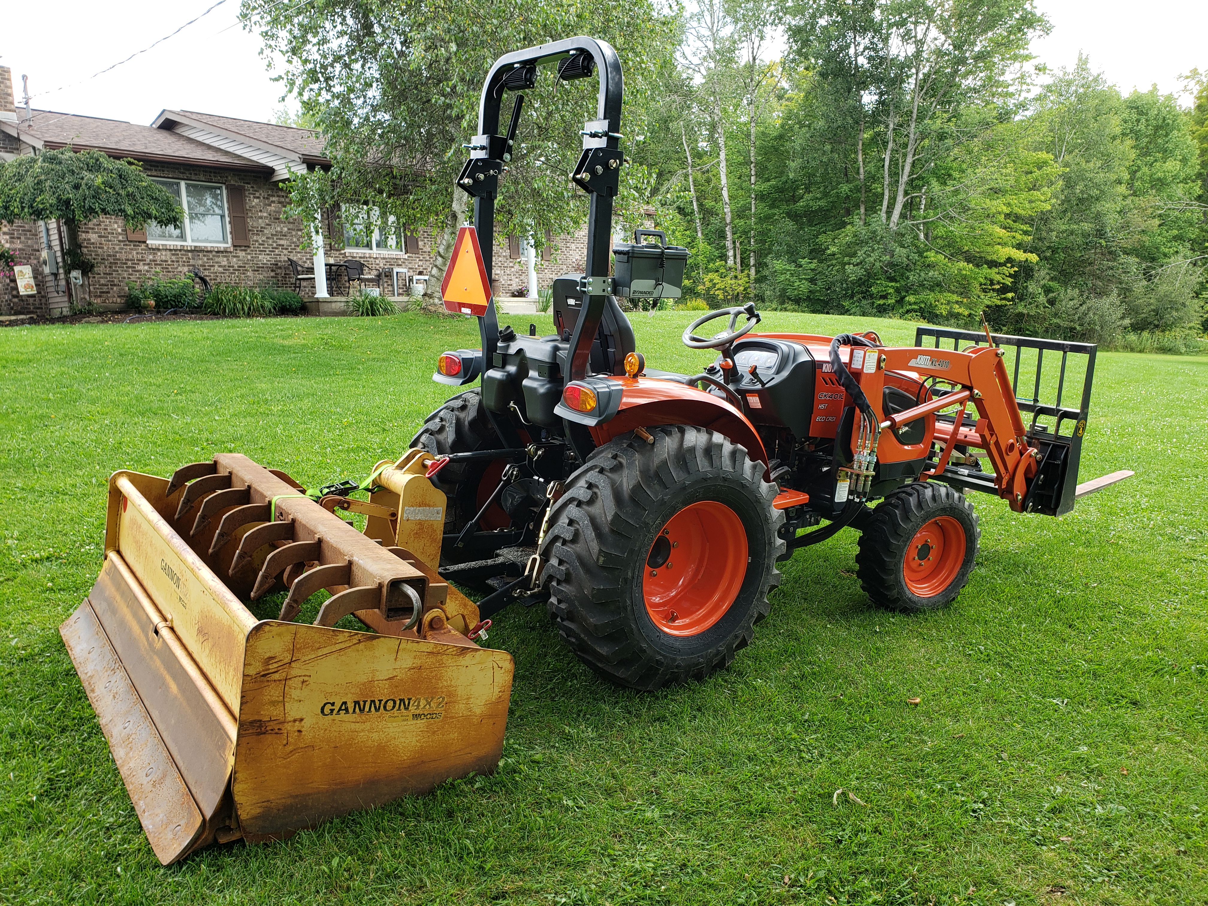

Well, we got it out of his truck (was ridiculously easy once we thought about it a little) I had new hoses made up as the old ones looked brittle and I put it to work this evening. It's amazing how well these things work. The hydraulic scarifiers are such a wonderful addition. I started grading a neighbor's driveway and before long I had made a huge improvement (pics coming later on) I need to learn how to tilt this using the manual tilt link as this thing is so heavy it's hard to get it to move. Must be a technique I need to learn to make it easier and yes..I know a hydraulic tilt would be the way to go. I'm researching them as I go along. So far very pleased with this and the extra weight does seem to be a big benefit.
I had the ram removed in these pics while new hoses were being made up so you can see the ratchet strap holding the scarifier bar up so I could get the lower ram pin out.

Holy cow. That thing is big. Surprised your tractor can lift it!

Kioti says 1700 pound lift on the 3 point. This weighs 1140 according to Woods.
It cuts wonderfully even when taking small layers off. That extra weight is a big benefit. I just go slow so nothing gets jarred too much when I hit a big rock, etc.
