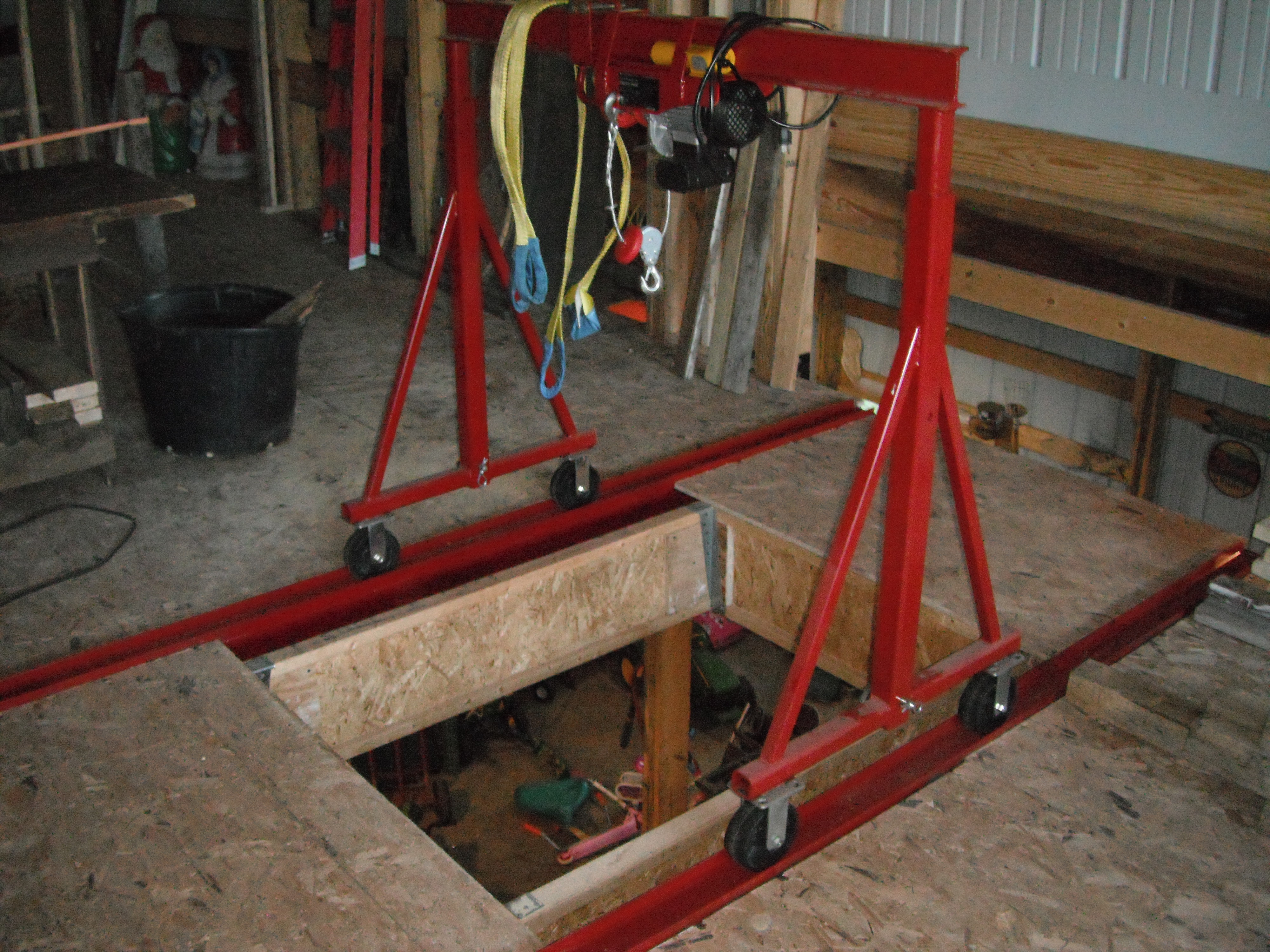

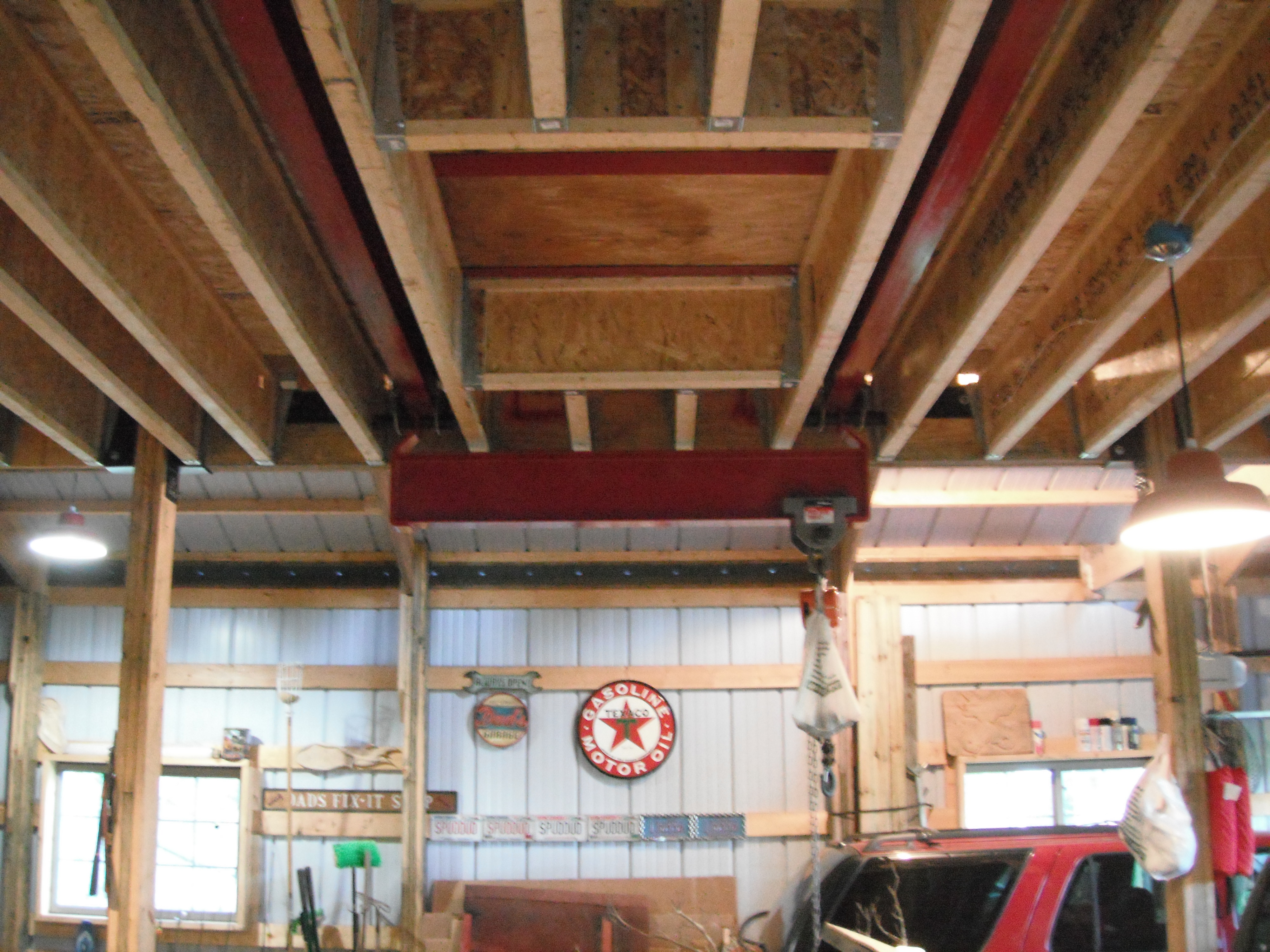

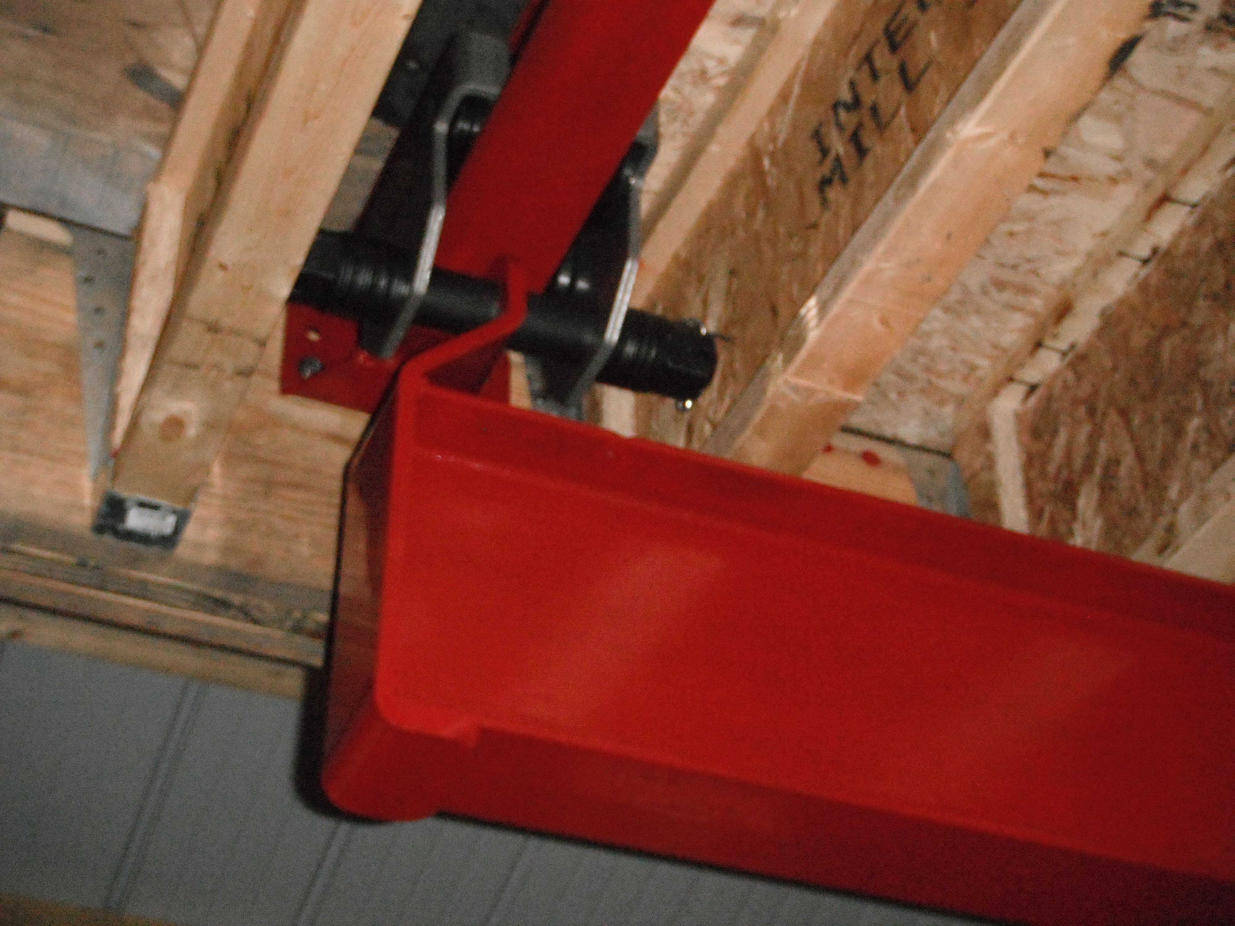

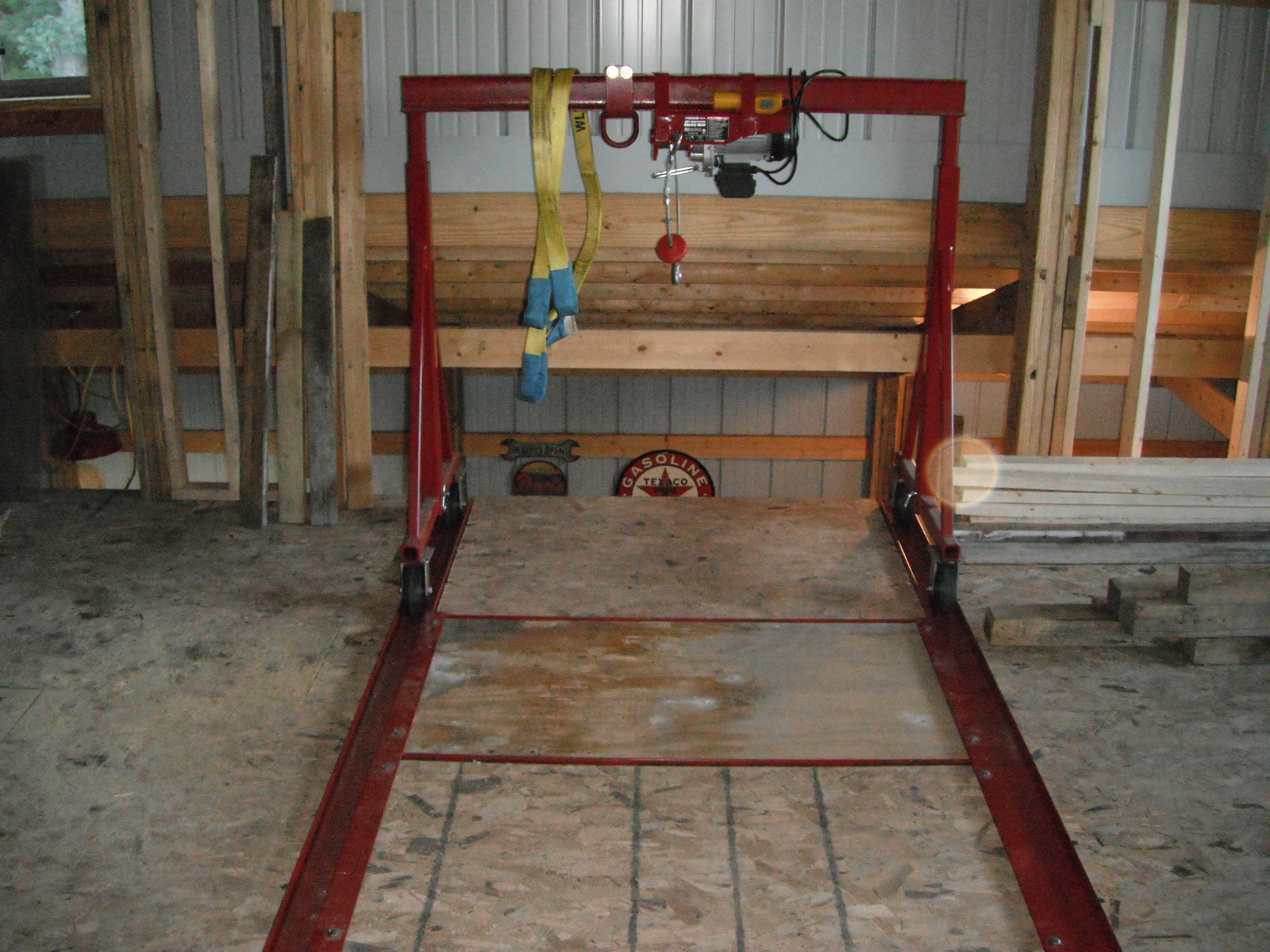

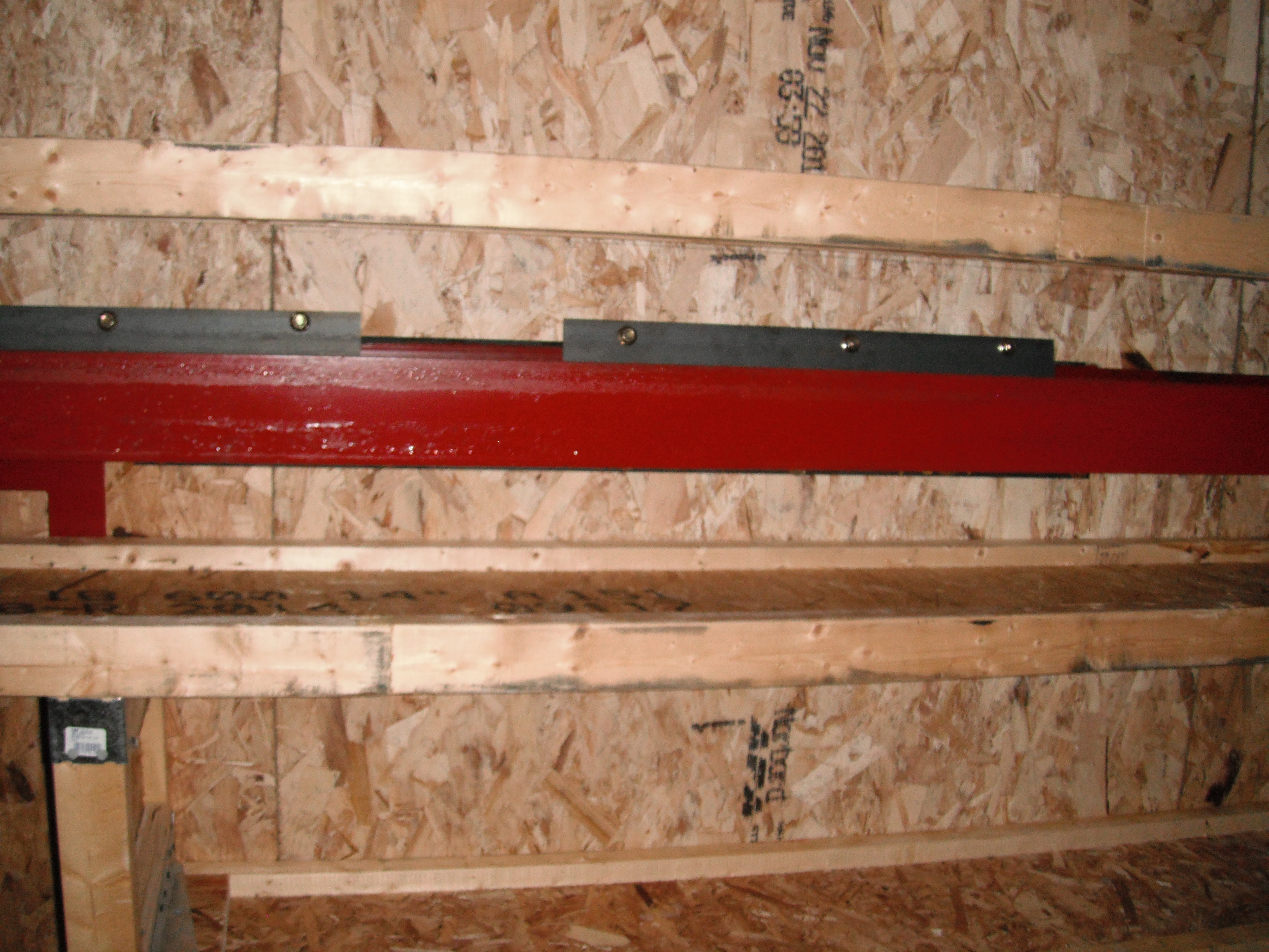

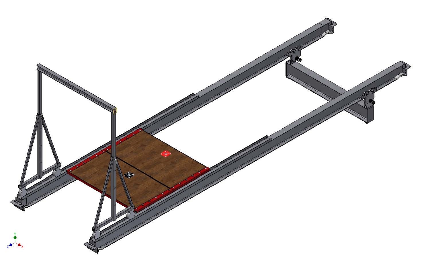

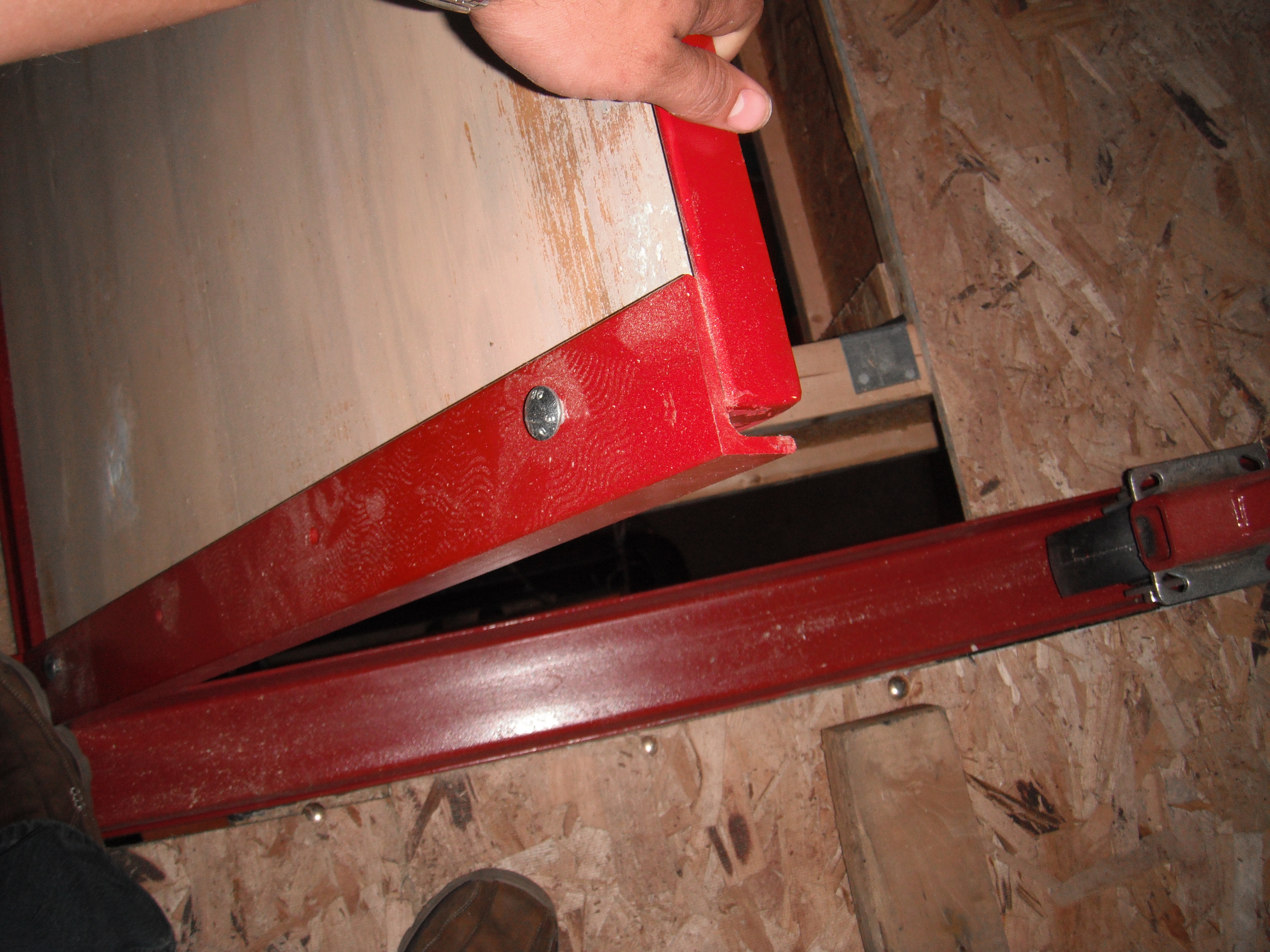

The crane I built in my shop I've tested (FEA) to 4,000 lbs with a deflection of only 1/4" at a span of 21' and a track width of 60". I chose a narrow track because I have a gantry in the loft above the bridge to lift things out of my truck and into the loft trap door (the gantry I tested to 2,000 - way more than the floor would handle). I used S8 - 18.4 for the 22' runners and S10 - 25.4 for the 5' track.
The new crane is for loading my plasma table with 3/8" to 5/8" plate steel. It's going to be made of 36' long - 4" channel for the runners anchored every 12' on one side and 8' on the other. the center track will be 10' long made of S6 I beam. I will be modifying the HF trollies to push the track up higher within the runners and use one side of the trolley in the C-channel with a reach-around hand to keep the trolley in the track (safety first!).
I will be posting pictures of the cranes in the next day or so but if you need close-ups, just let me know.

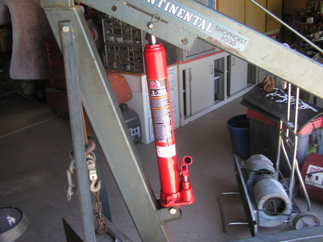

Thanks for your concern, but I know its limitations. I have only been using it for over thirty years.
Had to replace the jack in July of 2016:
   / Garage Bridge Crane #18
Looks like it was designed to reach up, not out.

Good to hear, is it used more for "up" it looks like it could fall over just sitting there otherwise.
