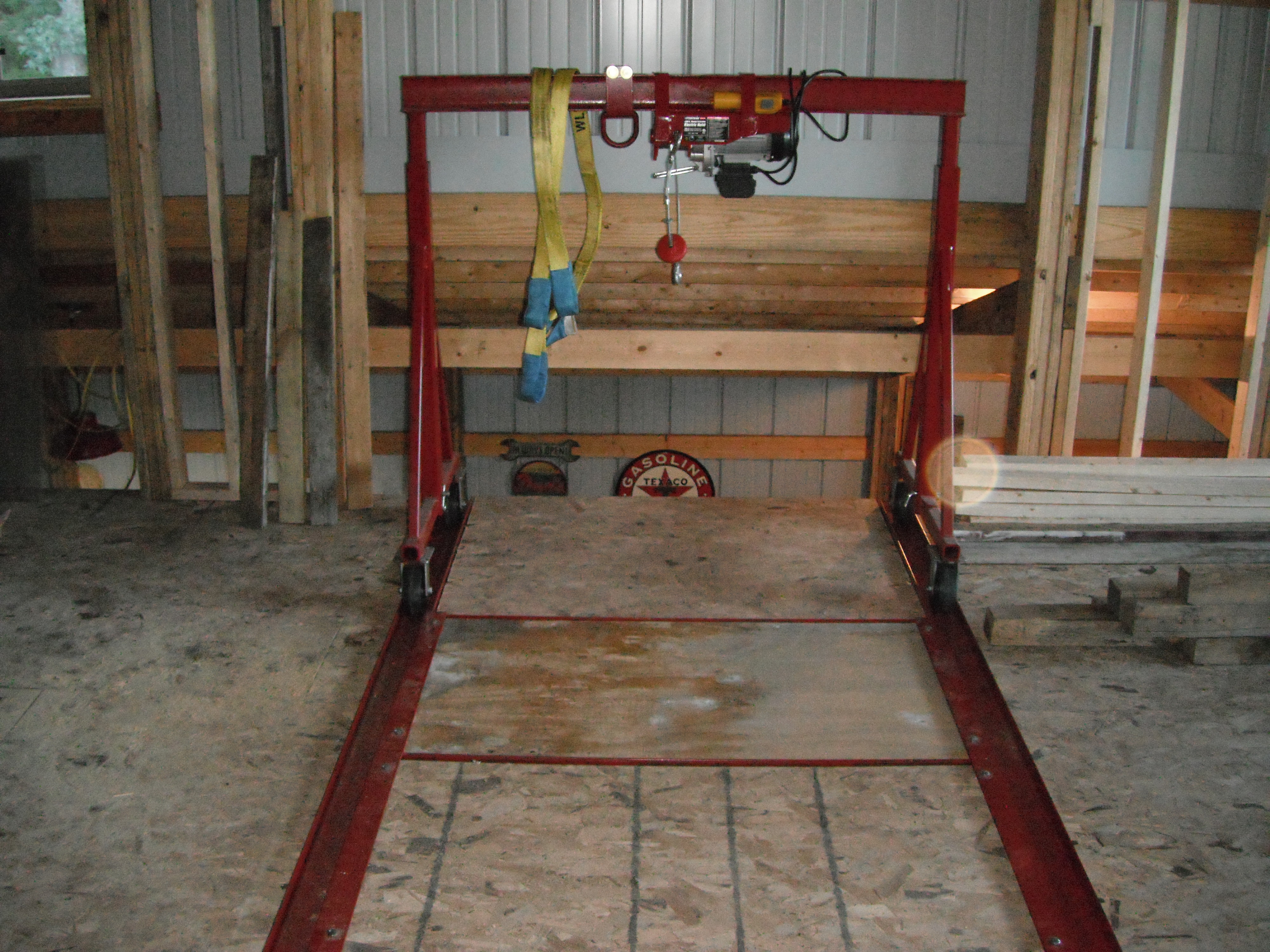

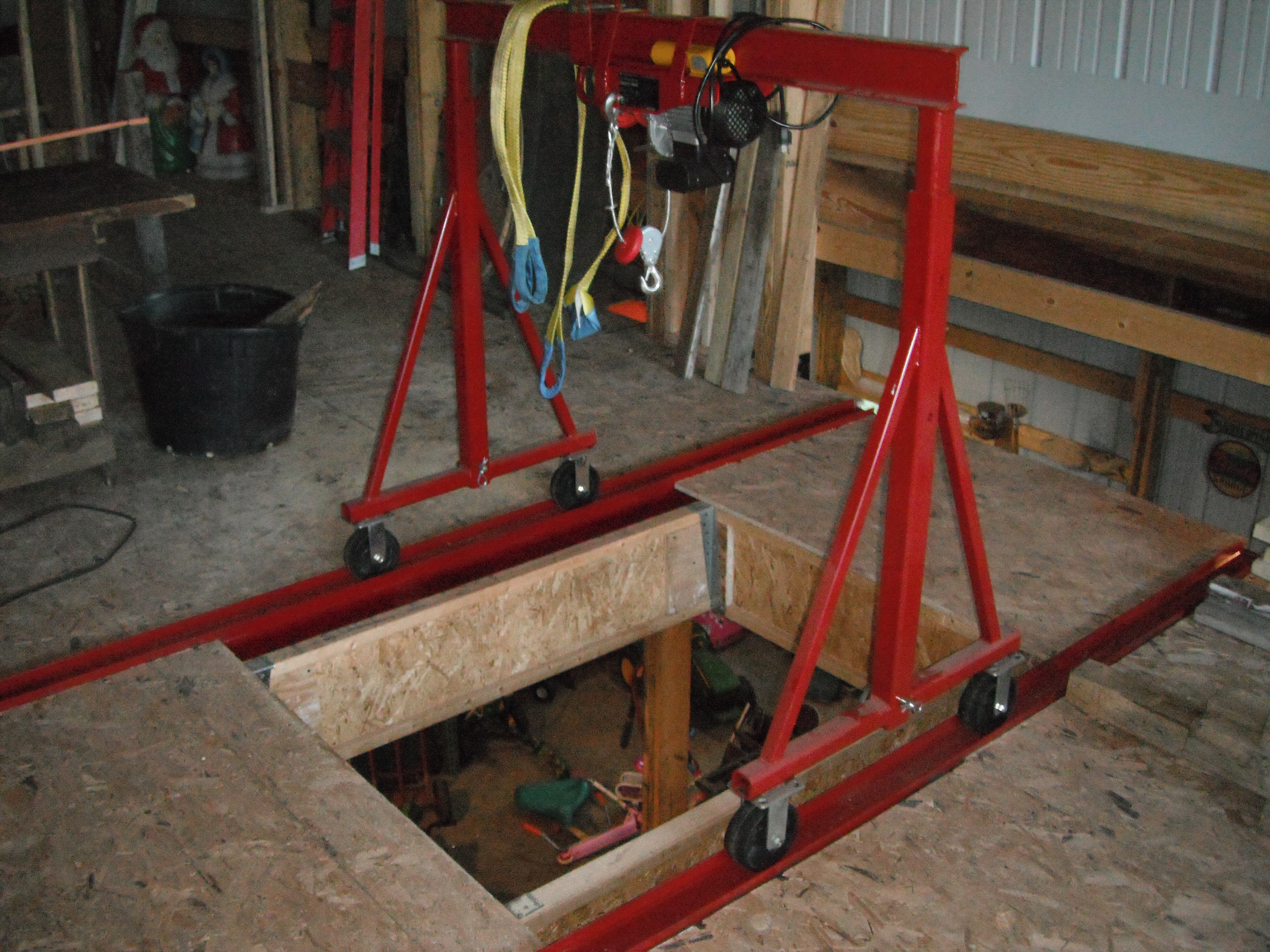

Here's some photos of my big crane.

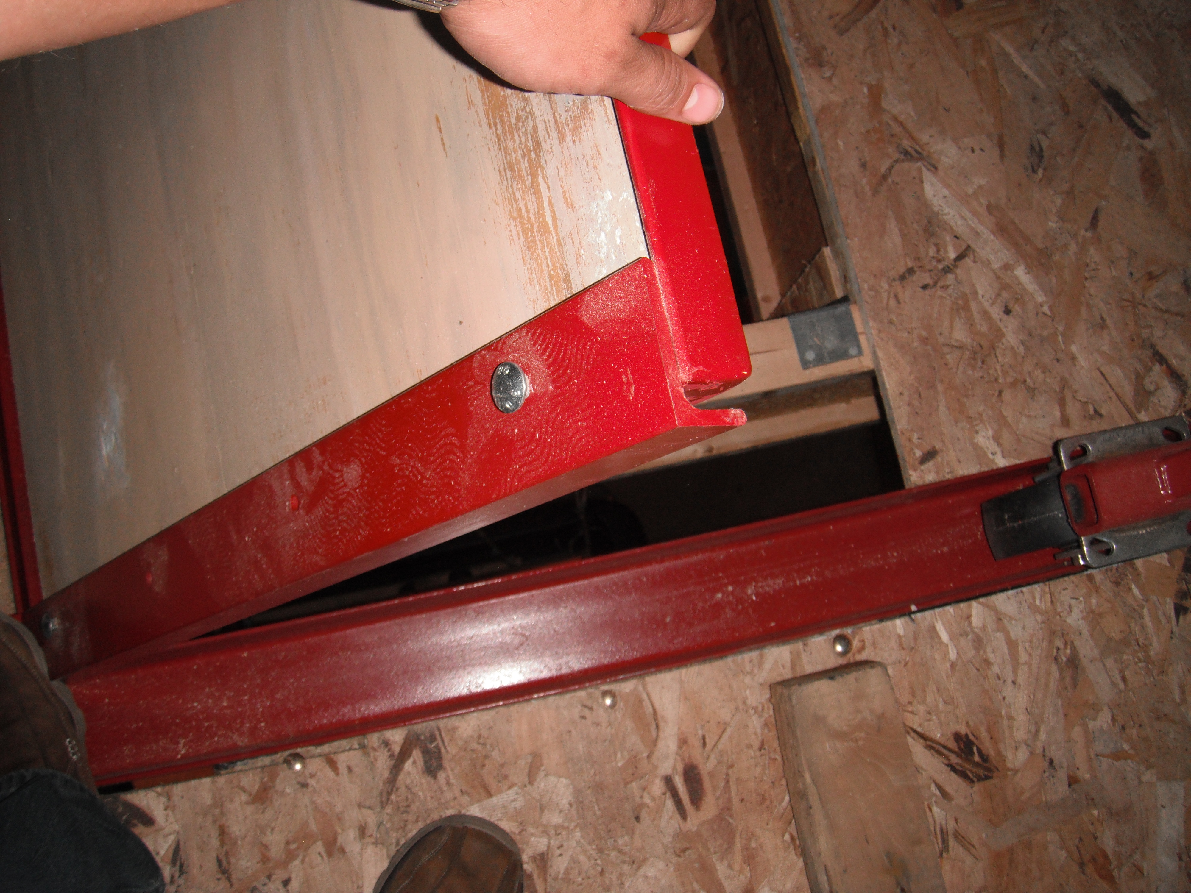

Spudd I REALLY like that setup. Awesome. Did you design/build? Are other loft floor panels removable?
Or just ONE panel, to get stuff up to the loft?
   / Garage Bridge Crane #23
Or just ONE to get stuff up to the loft?

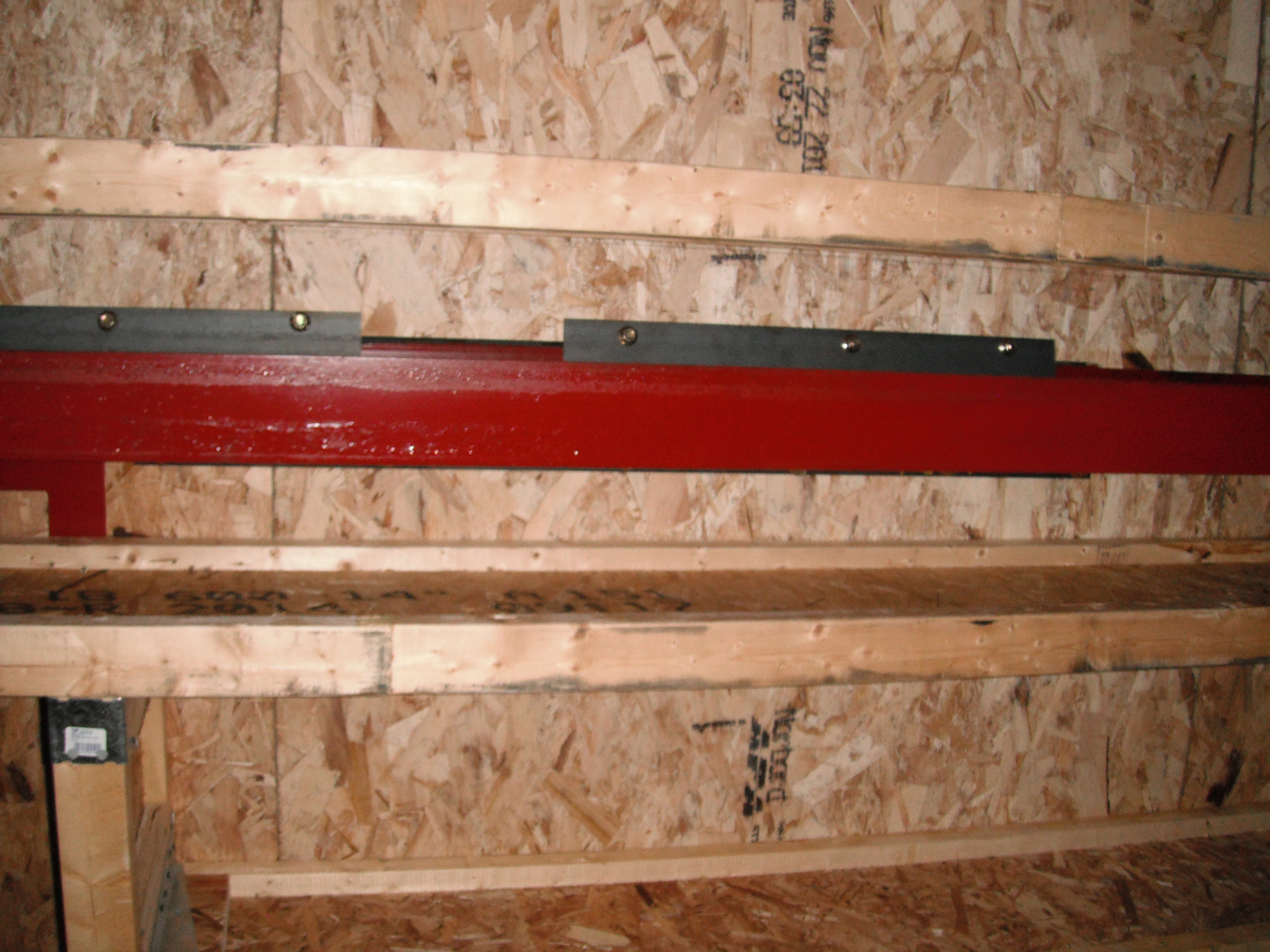

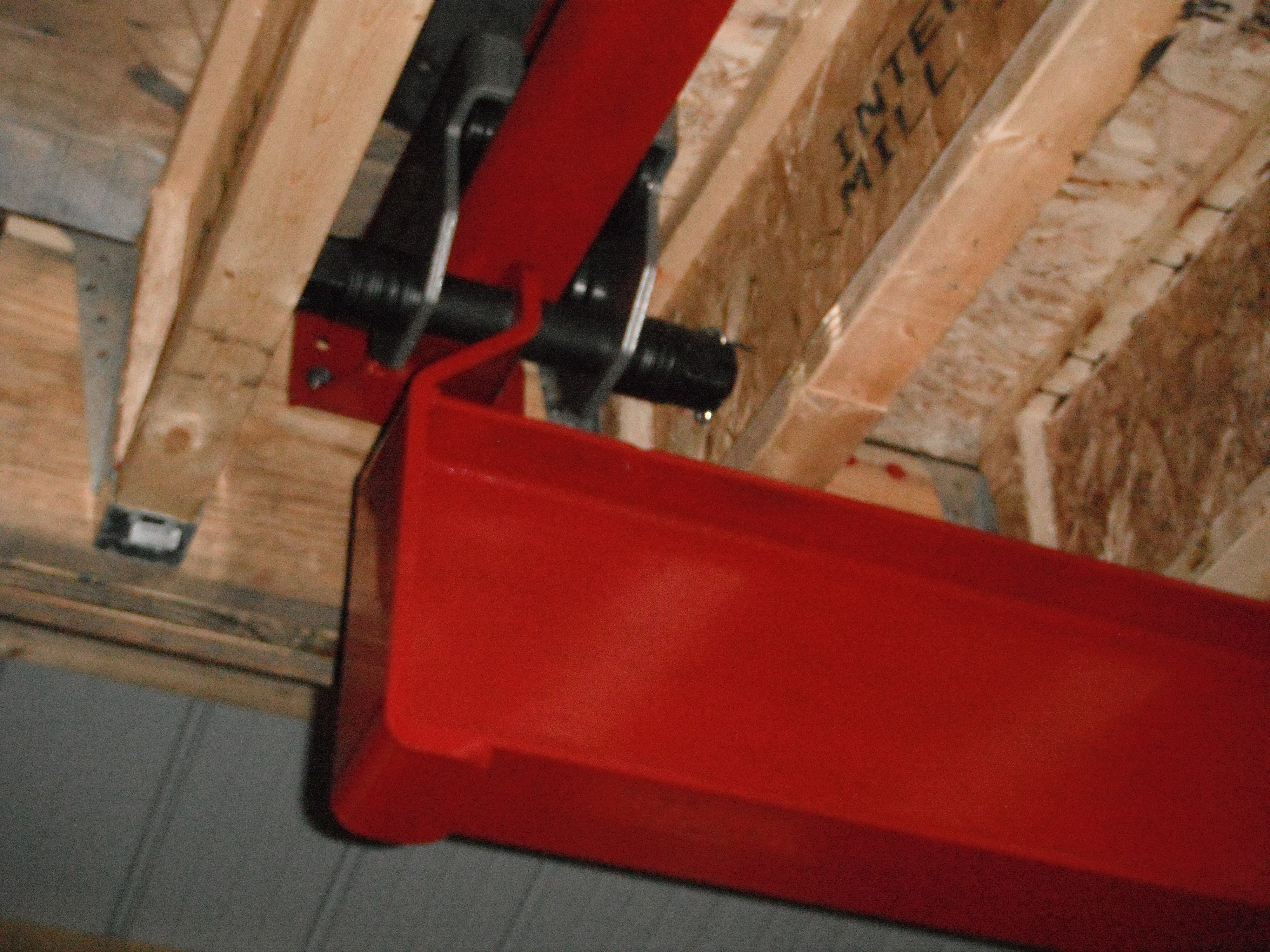

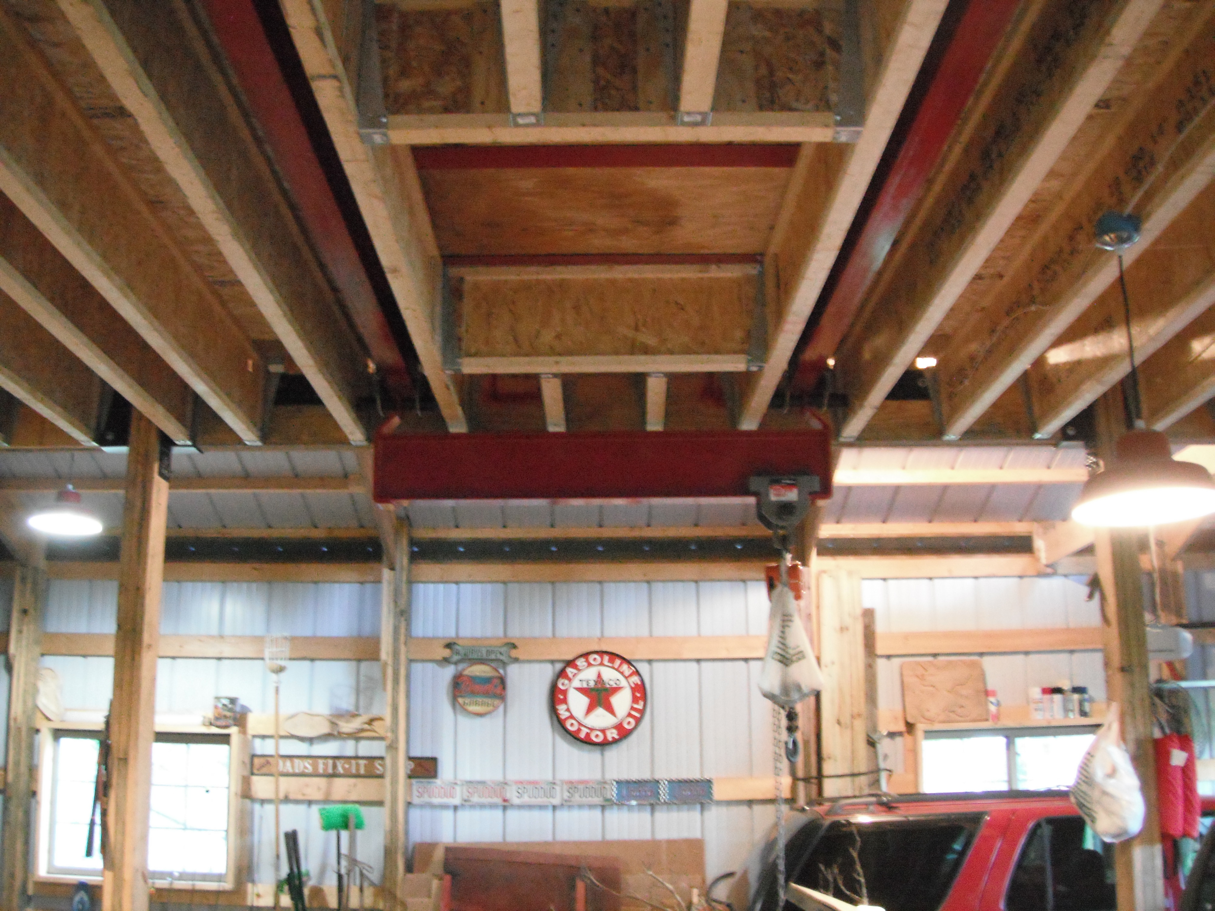

The 2 panels you see in one of the pictures are fully removable to allow a full size pallet of whatever to be lifted up. The panels are 1 1/2" thick (2 layers) of plywood with angle around the perimeter. I have 1/2" bolts that clamp another piece of angle to the panels and locks into the upper rail. I ran 2 floor studs under the panels for a failsafe and so one day I can finish it all off upstairs and down.

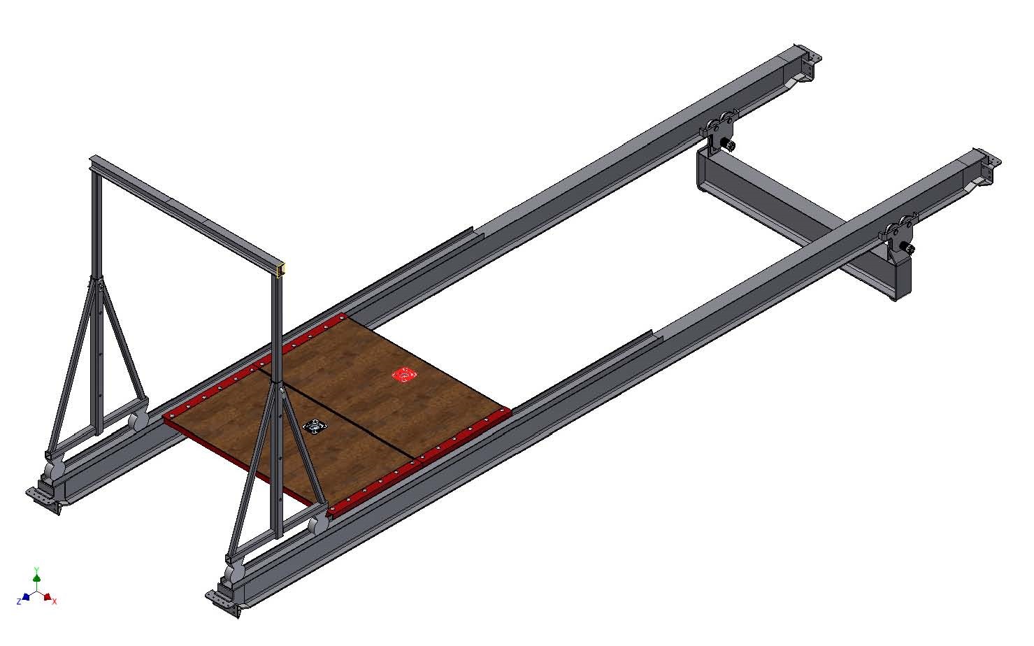

And Yes, I designed the crane myself before I had the shed current shed built so that the footers would handle the load I was shooting for. I designed it In AutoCAD Inventor and at the time had the plate parts cut and bent at Dynamic Fab and Finish in Eau Claire Wi. I bought the steel for it from Steel Towne in Colfax which they delivered to the house.
After the runners were all welded, it was quite the mouse trap but I lifted the 2 beams up 10' into the loft with ratchet straps, a come-along, and nerves of steel! I would have used a loader or folk lift but I didn't have access to one but I was able to install it all myself.

I've actually used my big crane to lift the front end of my '55 Ford C-700 to turn it around in the shop. Something I don't think the kit cranes would do.
Anyways, does anyone have any questions about crane building? I would love to help if needed. I have access to Finite Element Analysis (FEA) if anyone would like to virtually test a their crane design.

WOW, they sure engineered that to death on that thread!! If/when I get to it, I'll post on that thread for you. Just looking at the sizes and layout it looks like you did it right.
No worries if you dont. Just figured if you were bored and wanted to do an FEA it would give you something to do.
I did the numbers on the beams and rails and am confident in my numbers and assigned load rating. But some of it was just seat of the pants stuff, like building the trucks and putting gussets where it just seemed right, etc.
Would be cool to look at pretty blues, greens, yellows, etc of a FEA
