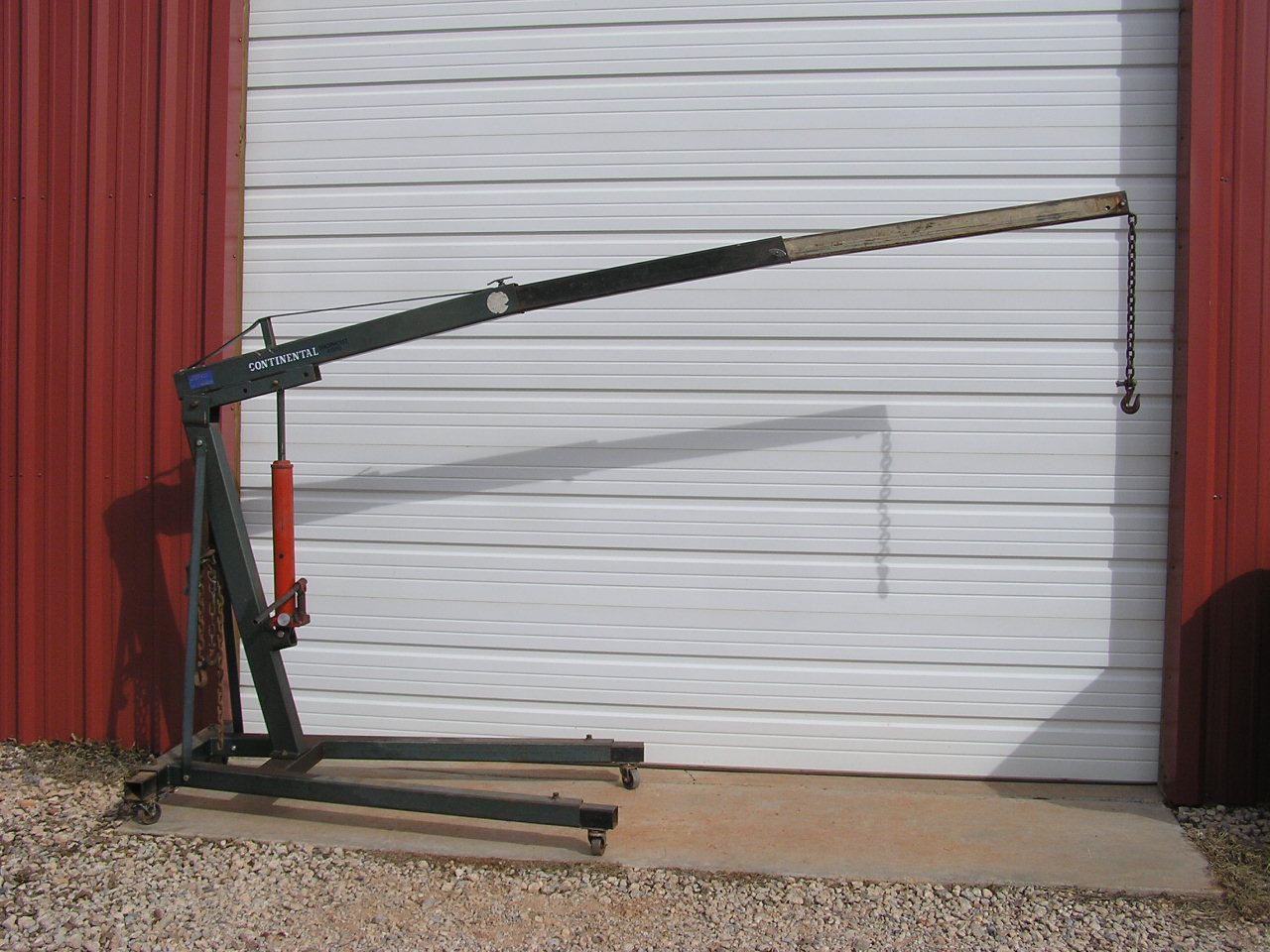

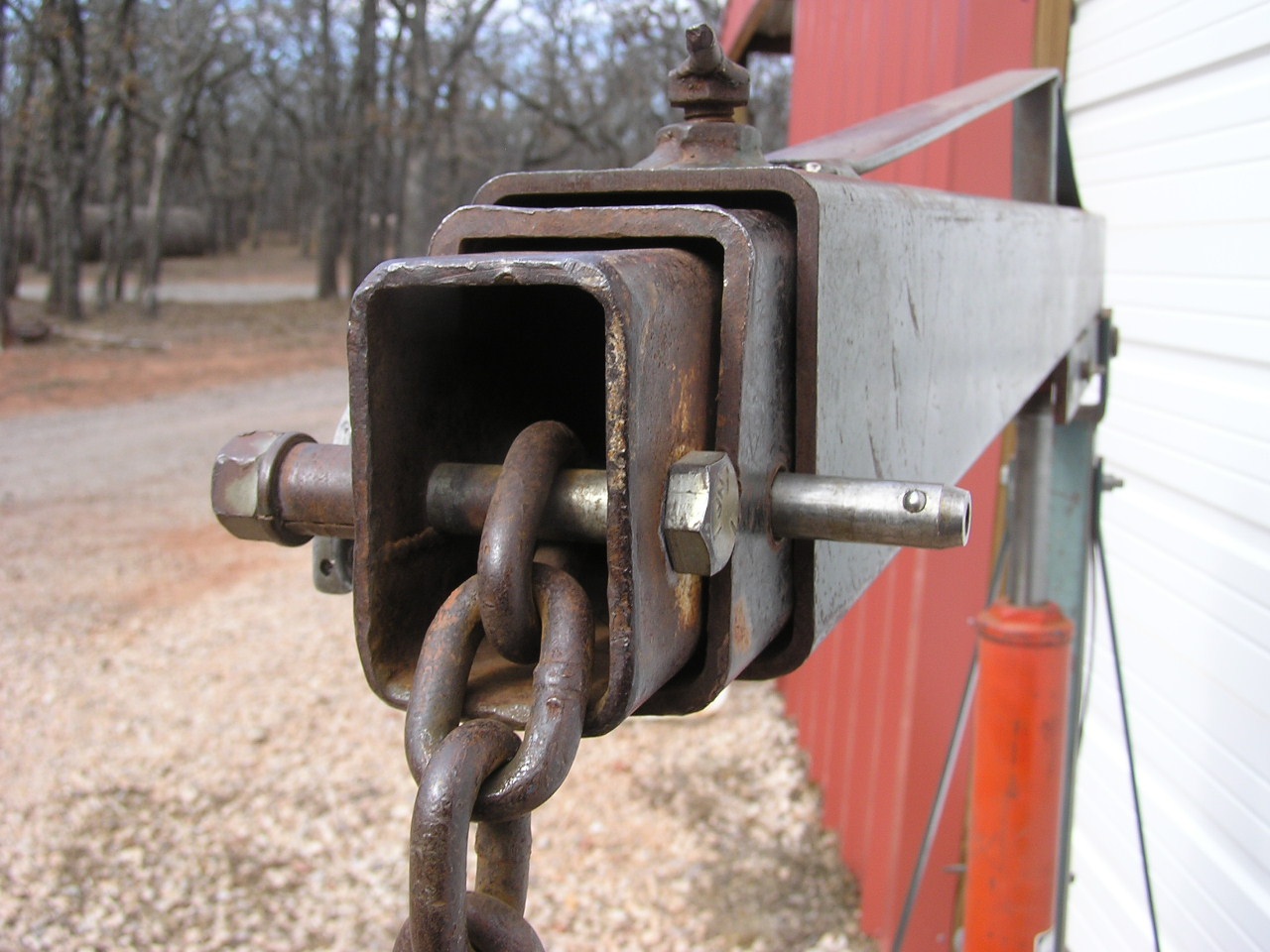

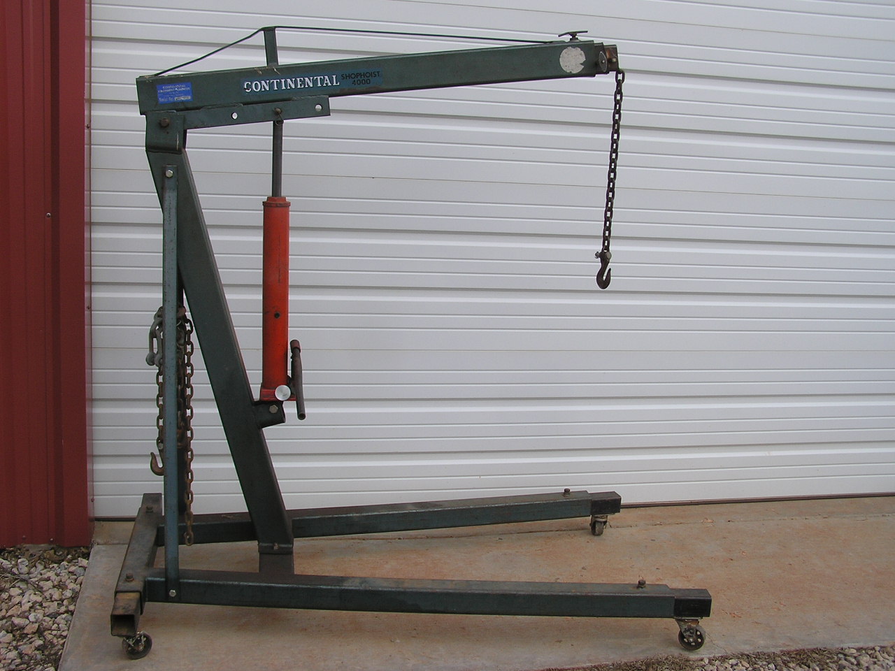

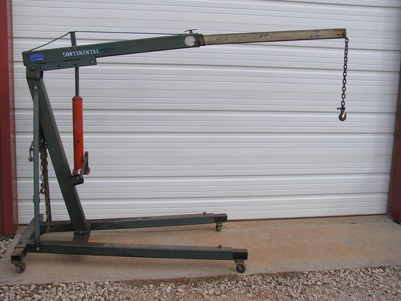

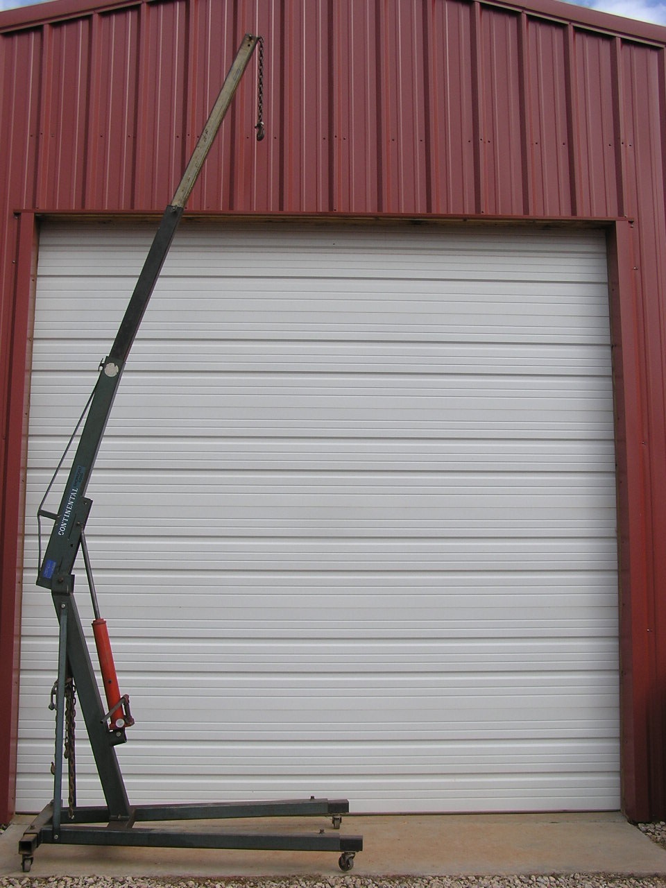

I manage with a shop crane that I added another piece of rectangular tube into, for more height.

xfaxman it looks like those legs telescope out too? Good thing!

xfaxman - you're nuts! That engine hoist modification is just asking to be crushed. Speaking as a Mechanical engineer, nothing from the original crane you used is up to the task of the weight you can hang from that far away. Please be extra carful when it's just standing there without weight on it.

Thanks for your concern, but I know its limitations. I have only been using it for over thirty years.
Had to replace the jack in July of 2016:
/ Garage Bridge Crane #18
Looks like it was designed to reach up, not out.

Good to hear, is it used more for "up" it looks like it could fall over just sitting there otherwise.
