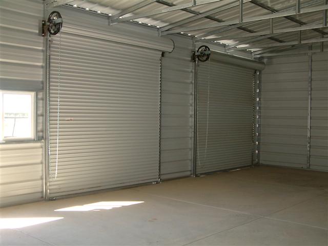

I'm confused. Does that $35K include 100 ft of concrete driveway?

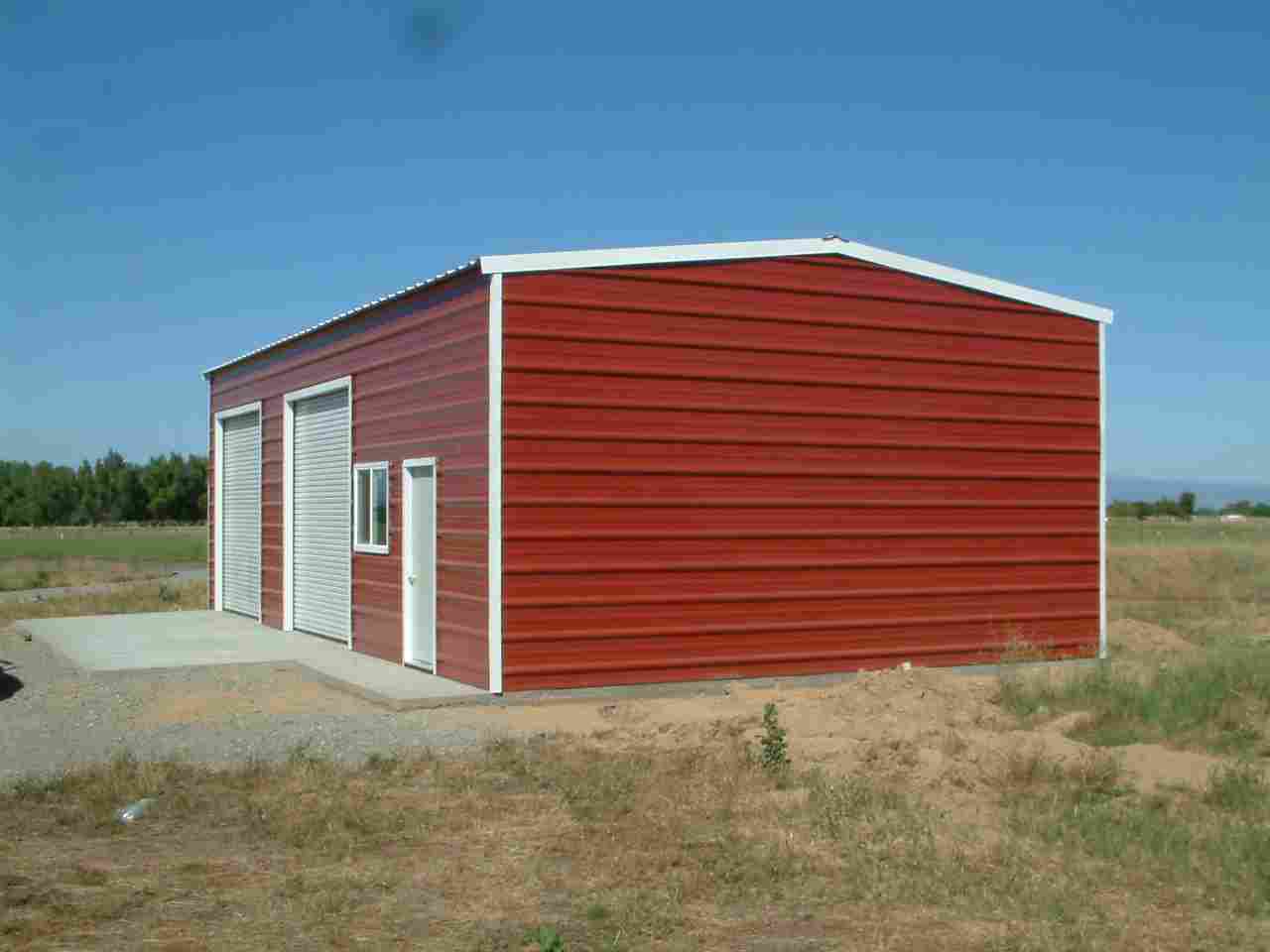

My shop is a 24 x 42 ft steel building with 12 ft walls, two 10 x 10 foot roll up doors, one man door, one window, 100 amp/240V service. Cost: $16K in May05. The concrete slab (6" thick, #4 rebar on 24" centers) cost $7K.

As the photo shows, my shop has two 10x10 ft rollup doors. You need at least 2 ft of height above the door for the rollup assemble. 14 ft is OK. Is the door on your garage a rollup type like mine or a normal garage door ( a tilt type or a sectional door that uses a pair of guides)?
