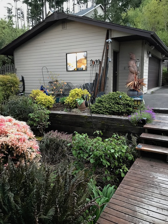

Okay here are a couple pics to help describe the situation.

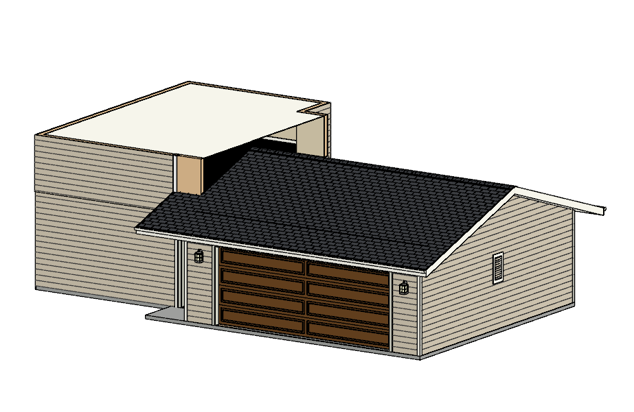

I plan to build towards the house which is lower and to the NW in direction. This means sun is a premium at the front of the house. Here is my in progress CAD design of the shop addition. Connecting to the house will be huge $$$ and I don't think aesthetically it will work. Keep in mind the drive comes straight into the garage so the house is lower on the hill and at a right angle to the left.

Man, around here I'd keep the plantings and not build a shop. That's really pretty there! :thumbsup:
Have you considered a total tear-down of the existing and starting over?
Do you have an overhead line drawing of the current buildings, driveway, planned addition?
/ Optimum Small Shop height design?
#13
I know I know... but I want the shop next to the house and not down the hill. I live on steep/view property. On tearing down I'm not sure what that would buy me? It is already crammed up against my top (SE) and NE lines. I can go NE a bit... which I did with the 14x24 addition which is set back 4ft from existing footprint.
Overhead line drawing not in CAD yet. Did do an as-is plan of house but haven't married the two. Haven't had time or learning of the software yet and the whole terrain thing. Got a dang day job. Powerful software slowed by an unlearned human. :ashamed:

google your location -> click maps -> click on "google earth / satilite" to turn stuff into greenry. zoom in/out and print out a picture of property. make some lines marker or what not of property lines. blackout your street address / local street names.
2 pictures not much, was also thinking of full tear down when i saw the little garage. i'am use to seeing large metal buildings / pole barns. so when looking at the little garage... it seems small.
/ Optimum Small Shop height design? #15
errr replied at same time....
have told many folks skip the stinking 3D stuff if you do not know it.
if you are using a microsoft windows or mac computer. Prnscn (print screen) key is your friend
open up "paint" if microsoft, mac have simliar program
go up to "edit"
goto "paste"
and there you go.
edit to your hearts content drawing some lines here or there.
other approach print picture out. get some markers and start chicken scratching away like a 2 year old. seriously 2 year old chicken scratches.
draw some lines, put in some measurements and it works.
other option is old grid paper.
take a picture or scan it back into computer and post it/ send it email to whomever.
