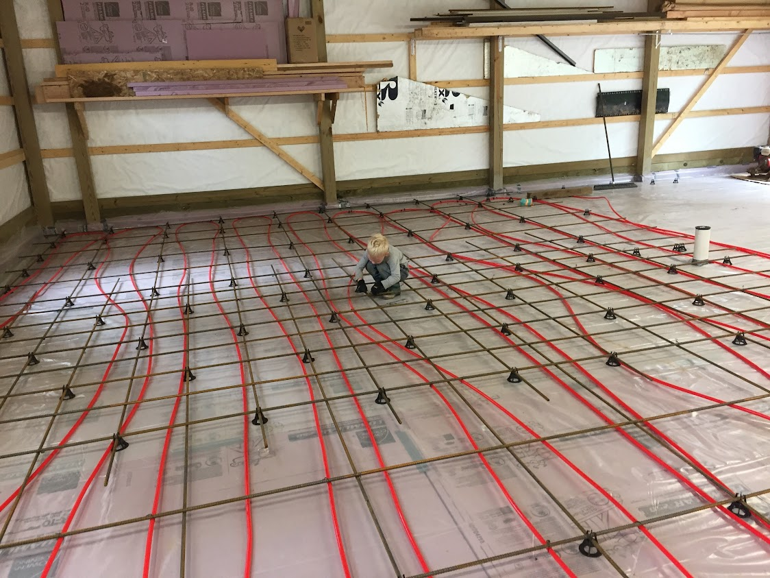

Lol. I'm (so far) firmly in this category though, I knew I'd want radiant heat eventually, so I did all the work to put my PEX in. 5 years later and I still don't have insulation in my garage roof, so there is no reason to proceed with actually heating it yet.
The PEX and manifold kit only cost me $350 for my 30x36' slab. Probably took about an extra day of prep work for me to lay out the PEX at the same time as my rebar on chairs (I have the PEX tied to the bottom side of my rebar). I wasn't sure how soon I would get heating going, but it was a no brainer to do it while I had the chance.
Having PEX under the rebar didn't change the way the concrete was poured one bit. They brought the chute in through a man door in the back of the building, and were able to get concrete to all corners of the building easily. I was at work so I didn't see exactly how it went down, but they said no problem.

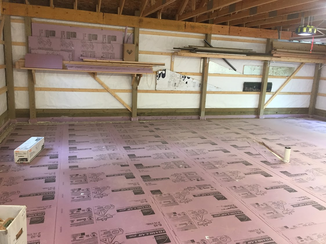

You didn't insulate under the slab?
You funny. :p
2" R10 foamular250. Not cheap! But I like to think I would have insulated the slab anyway even if not doing radiant, if the building is to be heated. We did 4" for R20 under the slab in our house, even without any PEX/radiant in it. Holds temperature crazy stable, it's awesome.
Your young one, looks so intent on the job at hand; that is so great!
Thanks for sharing the details and photos.
