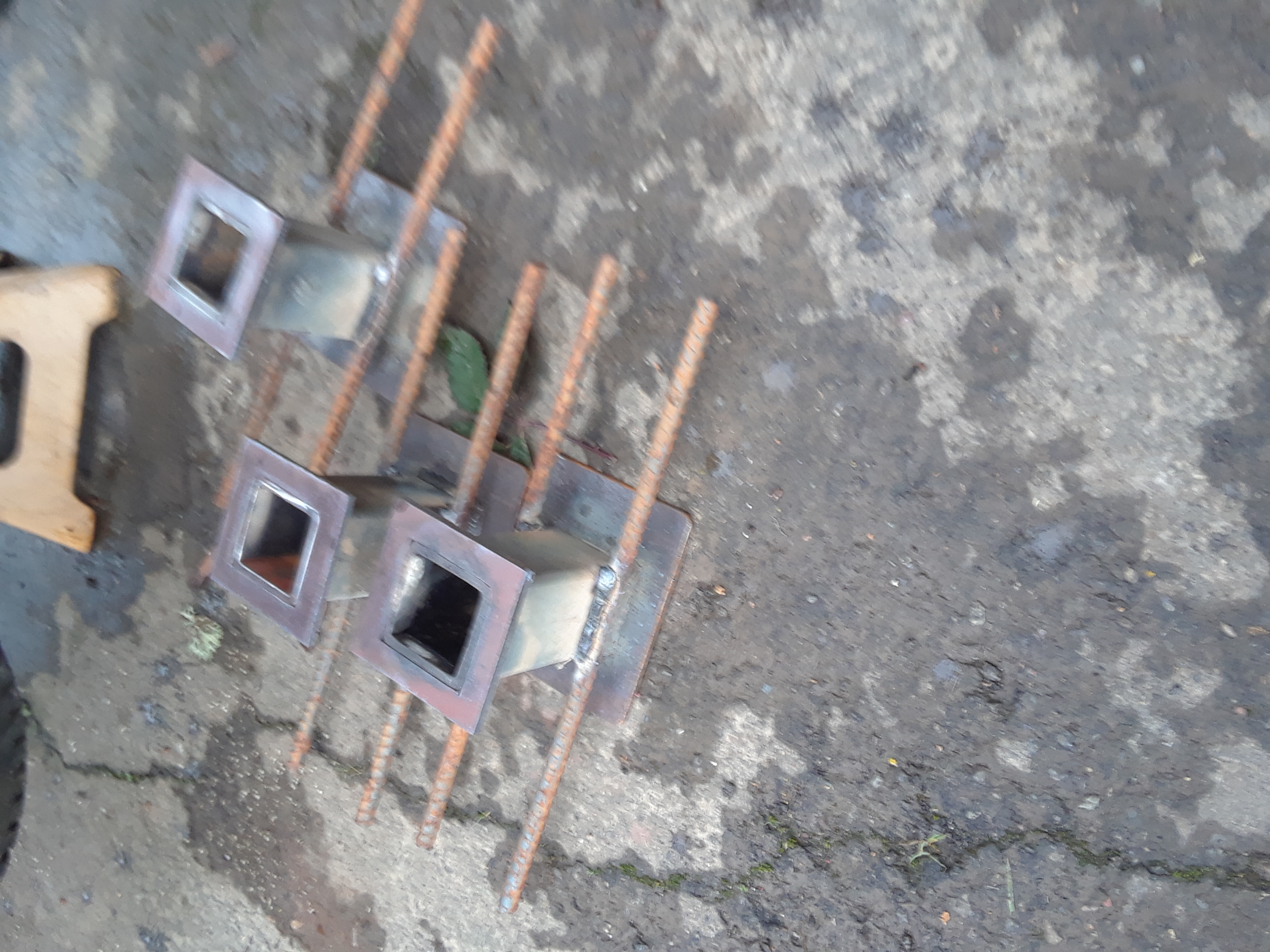

I made 6 of these to put in the slab, the rebar is welded at a height that matches the mesh on the floor, I just finished these tonight and tied them in place. The receivers will be used for grinder pedestals, vise pedestal, bender, saw horse, whatever crazy thing I come up with...
:thumbsup: Good idea, I'll add manual tire changer to the list.
