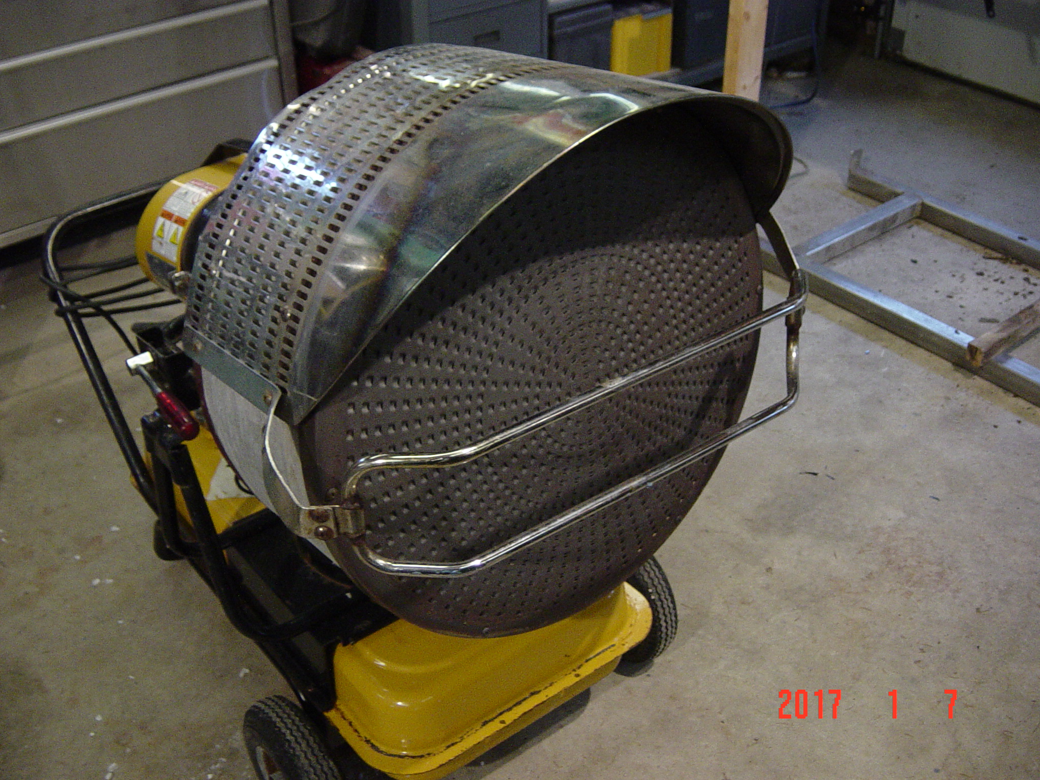

   / Garage heater #5
This is a radiant VAL 6 style heater, but better for large areas or outside. It only has a small fan for combustion purposes. They are expensive, so I waited five years before finding a bunch at auction.
The torpedo heaters will also make you sick in an enclosed space. These won't, or are not nearly as dirty. PLUS, they run on Diesel. I always had to buy and keep expensive kerosene on hand for the torpedo heater. Anyone run the torpedos on Diesel?
