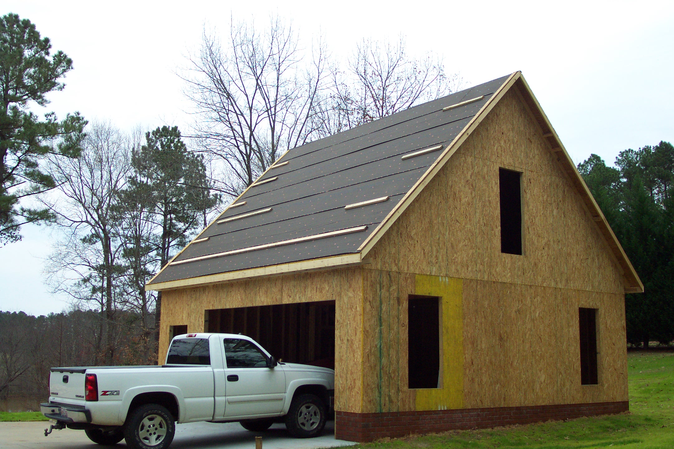

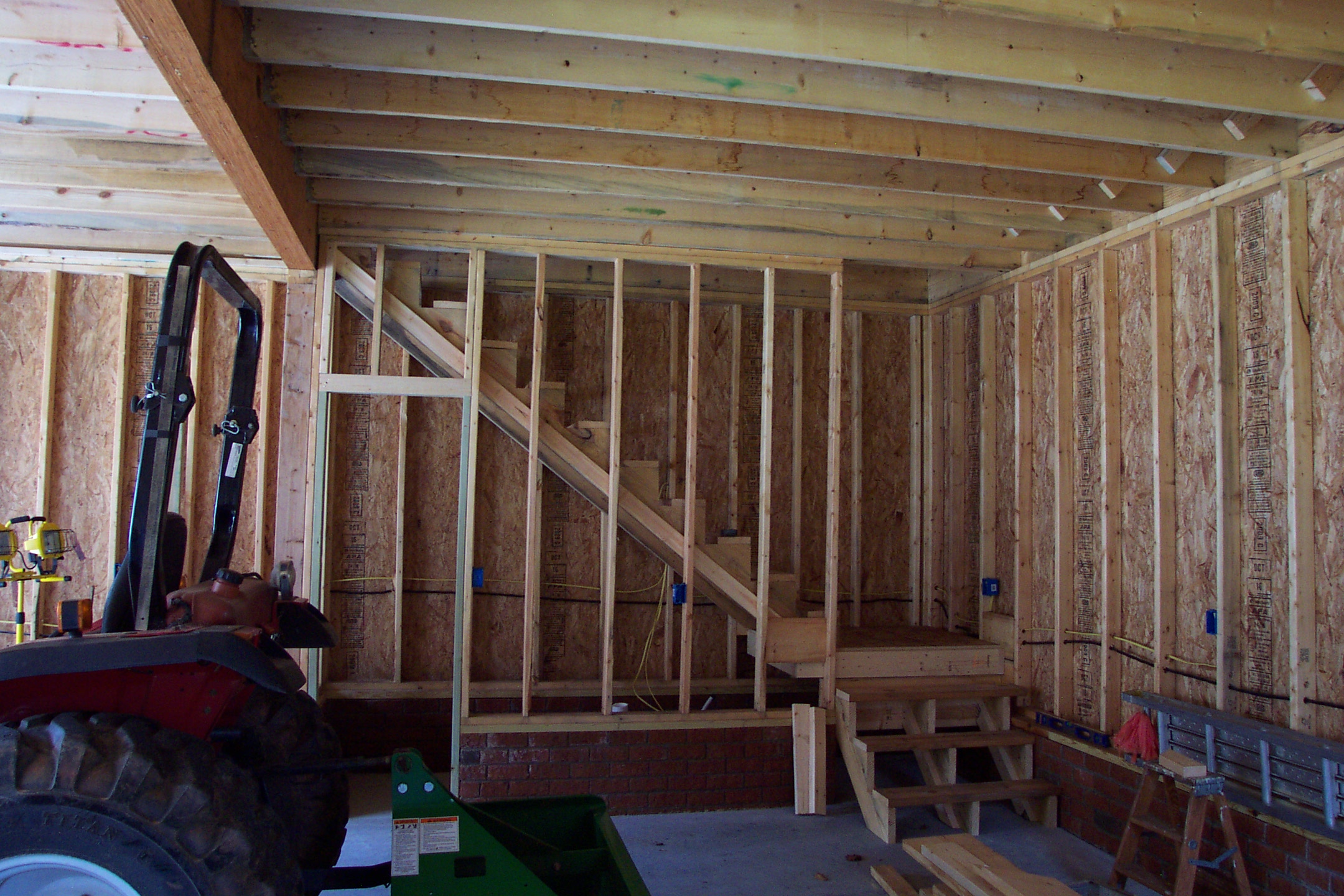

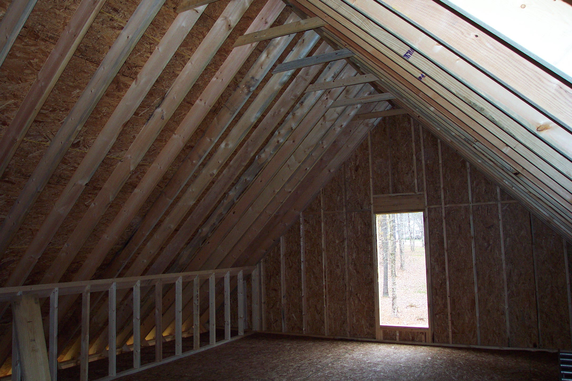

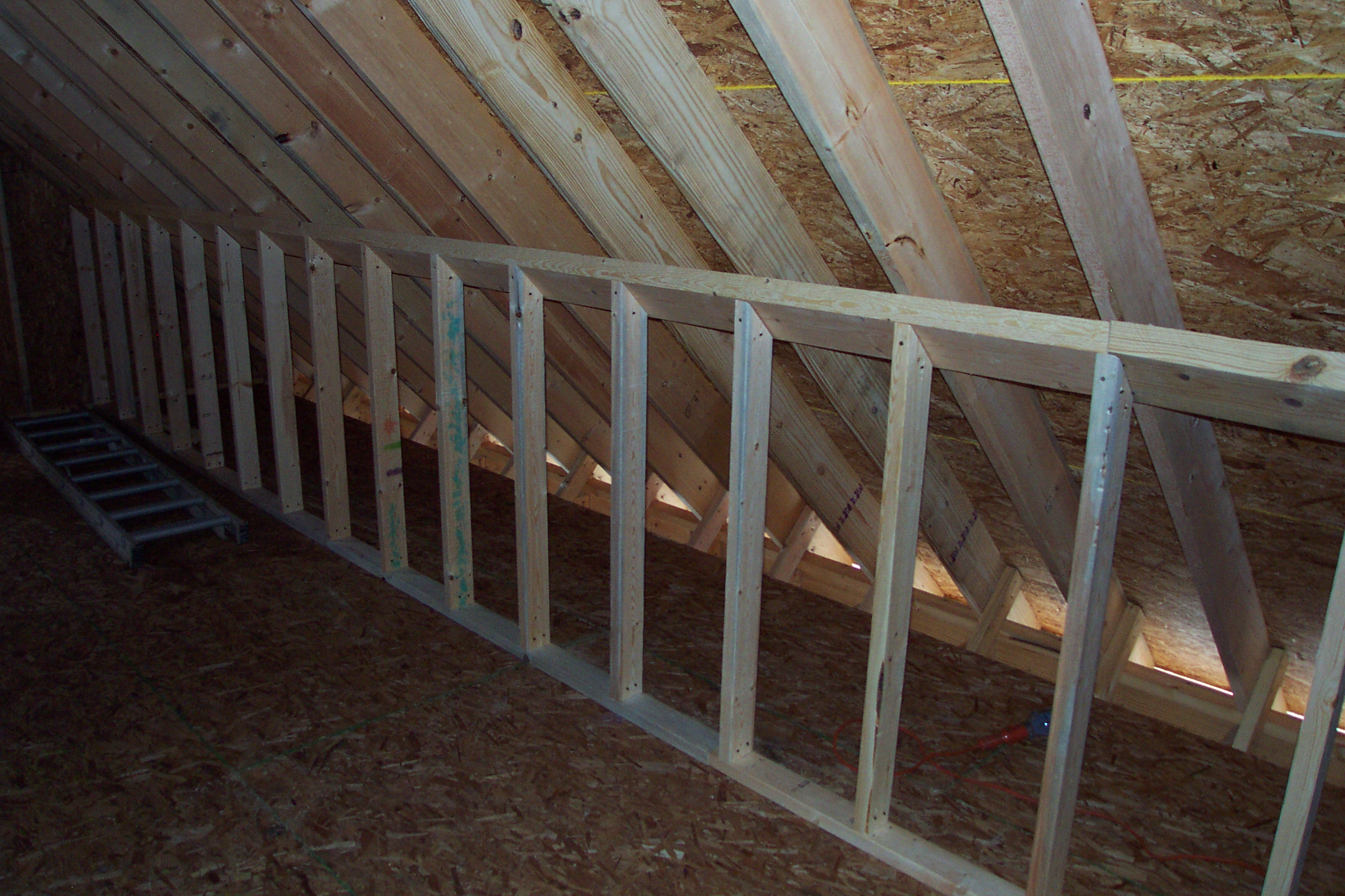

#73
A few shots....

/ Garage project #74
Dieselsmoke1, looks great! I was wondering (if it isn't too late) that you should raise the height of the second floor window. Seems a little too close to the floor. Your thoughts?
/ Garage project
#75
It is close, but it needed to be at that level to make the front elevation match. It's a 70" high circle top window so the distance from floor to opening above the sill will be similar to the distance down from an 8' ceiling.
/ Garage project #77
I know you will most likely put a gutter in but, why did you decide to put your doors under the drip edge.??
Shingled roof or metal.??
/ Garage project
#78
That's a fair question. All things being equal I'd rather have the doors in a gable end for several reasons. In my case it was necessary to open the side wall so I could match the front elevation of the attached garage across the pad.
The roof is architectural shingles to match the existing on the house.
