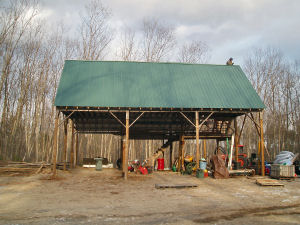

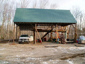

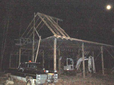

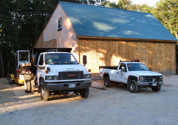

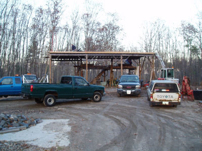

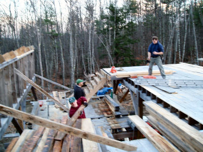

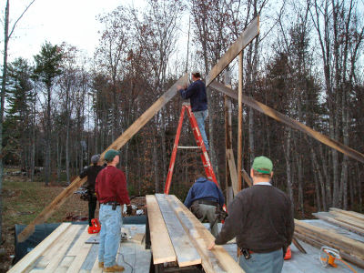

I have been building a 42' x 42' 2 story garage for the last 6 years. It is set on 6x6 poles set on a 14' grid. The ceiling is 12' in the garage area and 10' in the 3rd level. There is an intermediate level in the back over the shop area that is about 8'.
I have put in 2 10' x 10' overhead doors and just ordered a 12' x 12' overhead door for the trucks. I have insulated with the foil faced bubble wrap in the upper areas, while I've been buying r 19 insulation to tighten up the lower garage area.
I poured all the concrete myself. Some is 8" thick with wire, rebar and fiber mesh. With an Oshkosh truck I knew it was best to do overkill in the areas where heavy equipment would be parked.
I ran a water line from the house 6' underground. It is run into a well tile under the staircase, to prevent freezing. I also ran 100 amp service off of the house.
A couple things I'd do different:
More overhang on the eves. I have a saltbox shape and the front has a 12/12 pitch, rear has 5/12. With heavy snow it's nice to get it well away from the building.
I wish I could have had afforded radiant heat in the floor. I bought some of the materials, but realized I could pour all the concrete for what the tubes and insul was going to cost me. It heats ok with a Kerr wood furnace and much better when insulated.
10 x 10 doors are a must. My 3/4 ton just fits with a 8' blade.
I set my rear overhead level so I can set pallets up there with my tractor. It works good, but I would lay it out slightly different.
I would lay the entire thing out on 16' spacing between posts (if you are going posts) to make a little more room. 14 is good until you put stuff against the walls.
If you can go with a frostwall you will be much happier. Water will not effect your sills, you will not get any grief from your insurance company (supposed to have concrete walls up to 2'? for cutting and welding) and you will have a much stronger building that frost will not bother.
I would build a shed on the back just for open storage.
Hope this helps, good luck. Here's a few pics, in no particular order.
