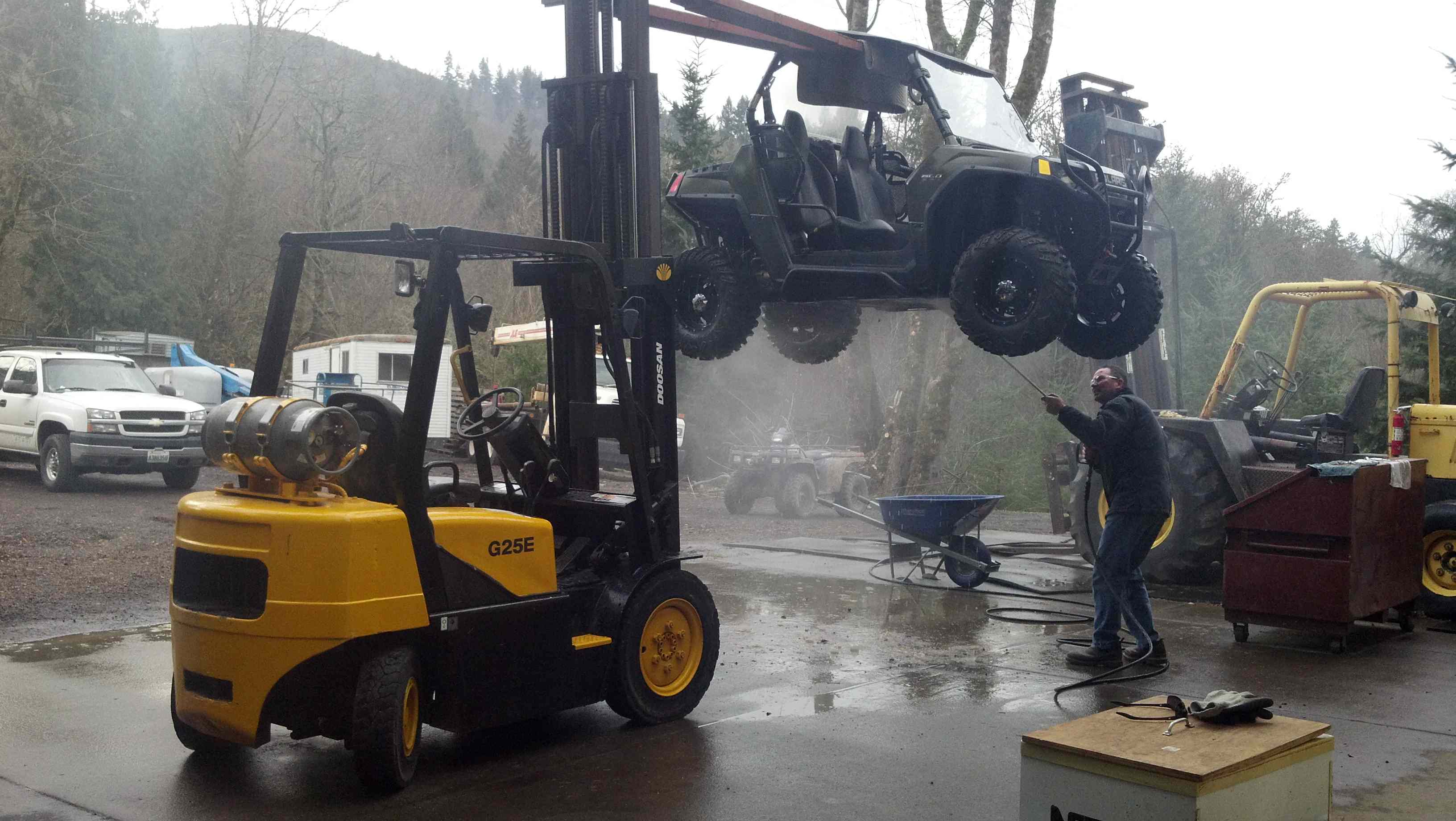

Or you could do it like this. Was at my neighbors and snapped a picture of them changing oil and doing the yearly on one of his RZR's
