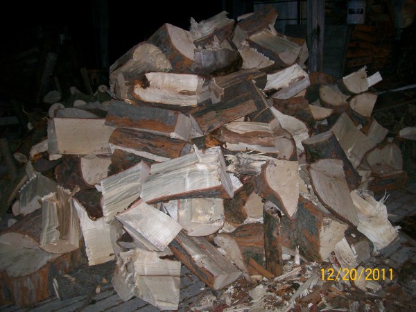

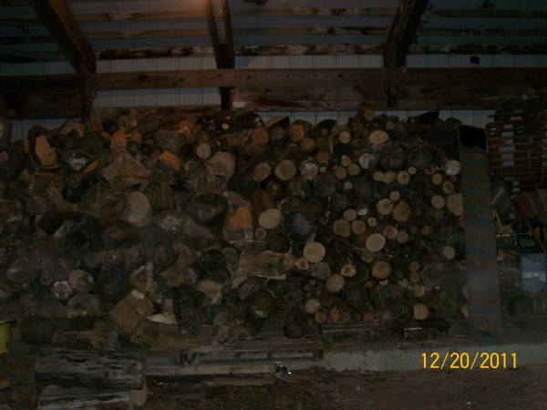

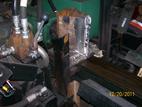

Update. I have put 12 hours on the splitter, 1-1/2 tanks of fuel, and made a bunch of wood. nice stacked pile is 8 foot tall, 18' long, and 9' out from the back wall, it's all split wood except for the very front corner is just cut up small rounds. For reference, the other pile is 6' tall, and took 45 min to make by myself. I re ground the wedge, to change the angle a bit, and it works better than ever.
