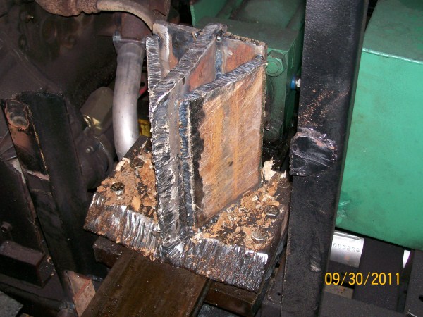

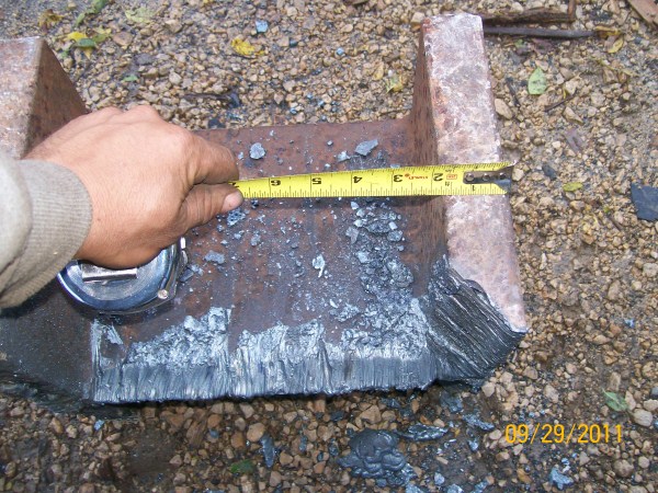

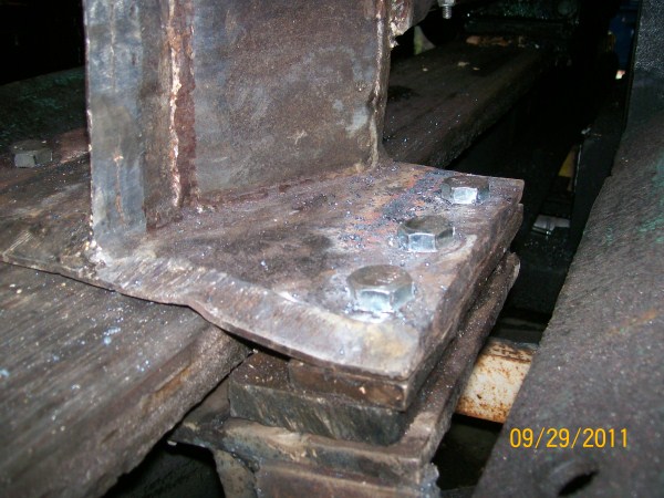

I got the filter working beautifully. I split about 2 cords wood last weekend, mostly large 3'+ across knotty silver maple. It was going pretty good until the bottom plate on the wedge started bending. I am now in the process of making a new wedge. Before anyone suggests it, I am not going to put the wedge on the end of the beam, or change anything else in the setup. This thing works great, what ever doesn't split, it shears clean thru, has not gottren stuck in anything yet. Here is the start of the new wedge, and the bend that is starting in the current one.

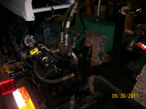

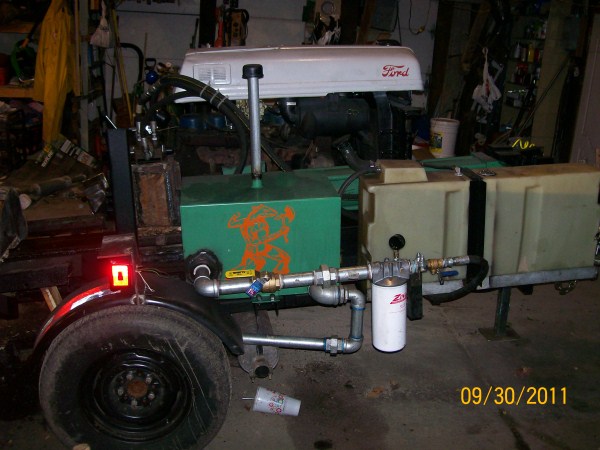

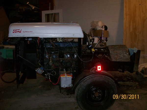

So here are a few pics of the finished until something breaks product.
New wedge works great, it makes the wood pop.
Specs: 50 gpm pump @ 3600 rpm - 3100 psi capable
full cycle time at 1500 rpm-16 seconds/3000rpm-9 seconds
curb weight full of fluids-3,450lbs
~20 gallon hyd tank- system takes approx 32 gallons to fill from empty
~20 gal gas tank
13' long 6' wide 5' high
175 hp Ford 300-I6
80 Gpm 10 micron filter
Hood is from an 8N
Approximate total build cost $1,650.00

For sure it's a beast :thumbsup: there's not a tree safe.
Not to pick but fyi, using galvanized pipe is a no-no on hydraulic systems. The zinc will flake off in spots and play **** with the system. One more comment, take a small wire tie and tie the return valves open, if vibration or someone inadvertantly closes the valves and you start 'er up I'd say in 45 seconds or so you're gonna have an empty tank and one heck of a mess. I say small because you can break it if you have to close them in a hurry for some reason without resorting to finding a pair of pliers....Mike
