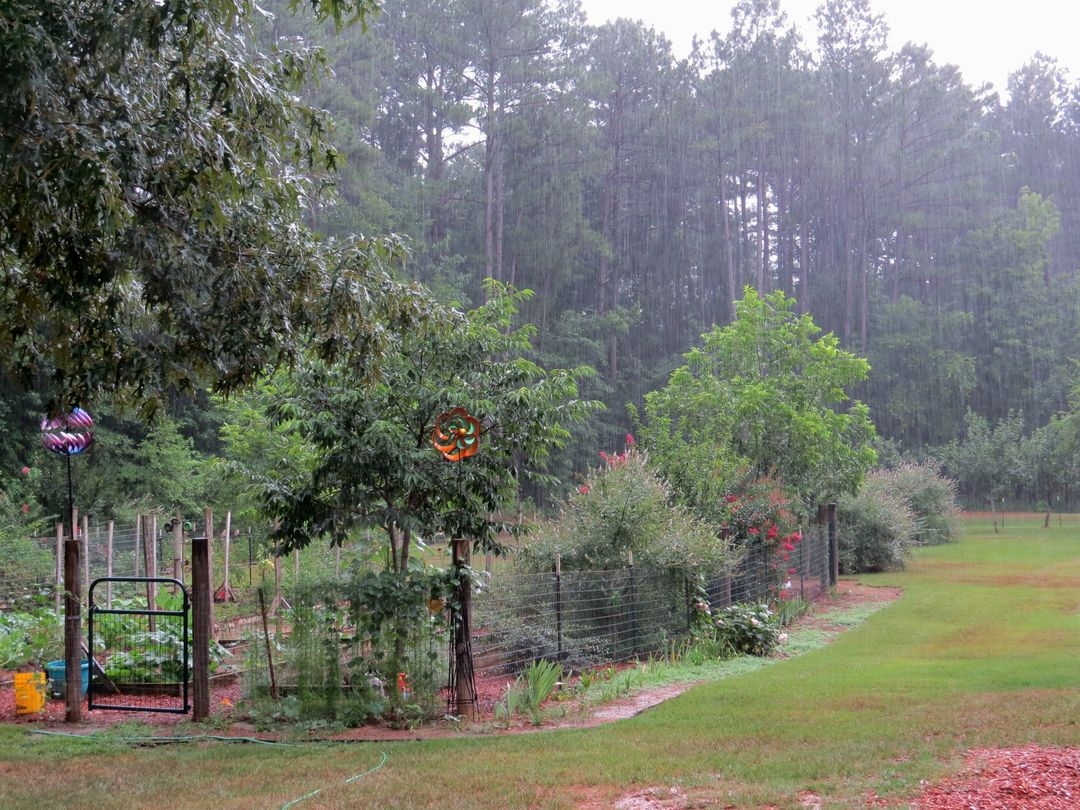

Here's how I did my own 24x32 garden:
How did you attach the mesh to the welded panels? Zipties seem to last about 1.5 years in the sun around me. I might use hog rings, Ive used those on gabion walls, but seemed kinda overkill for attaching the mesh.

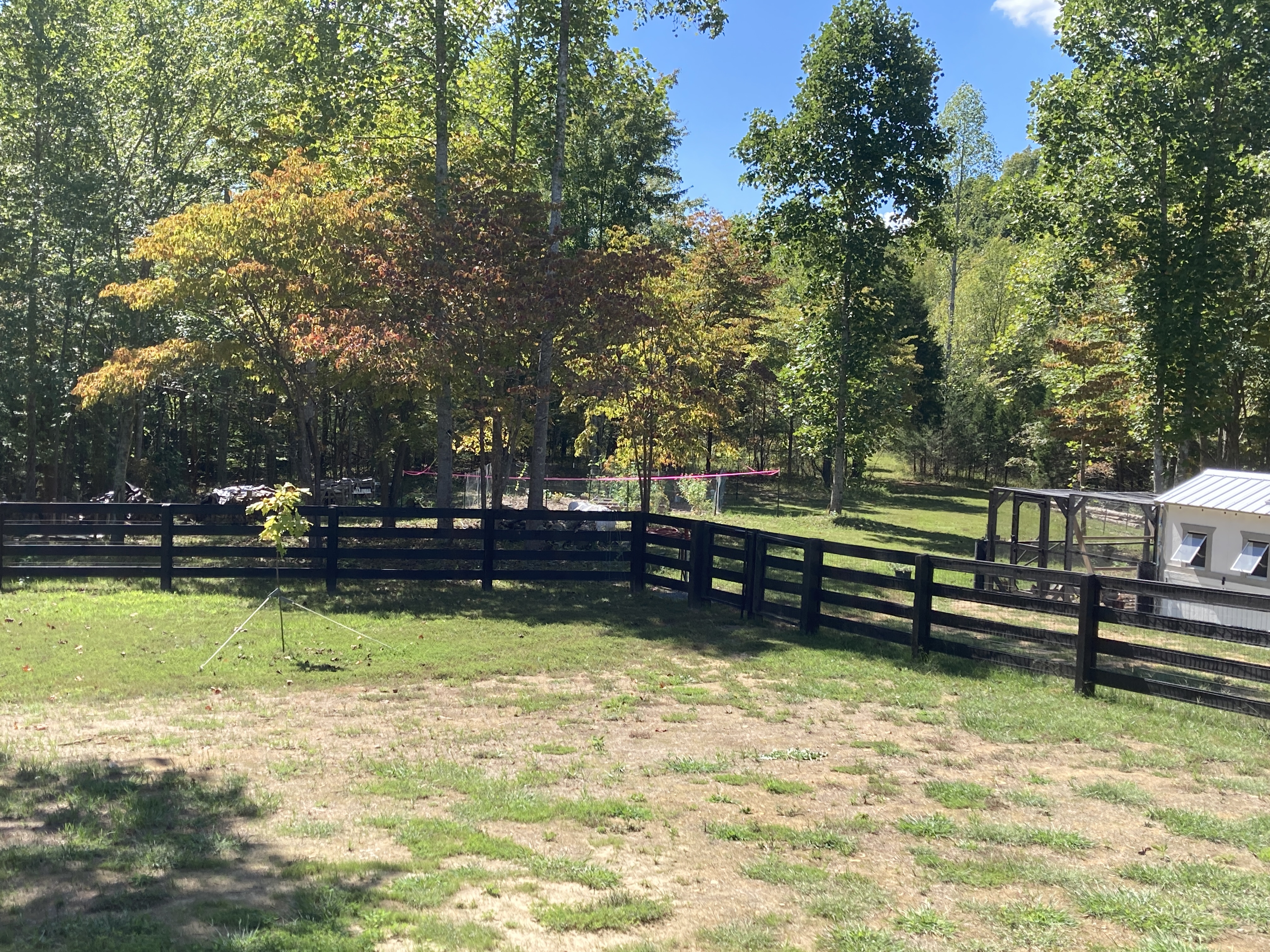

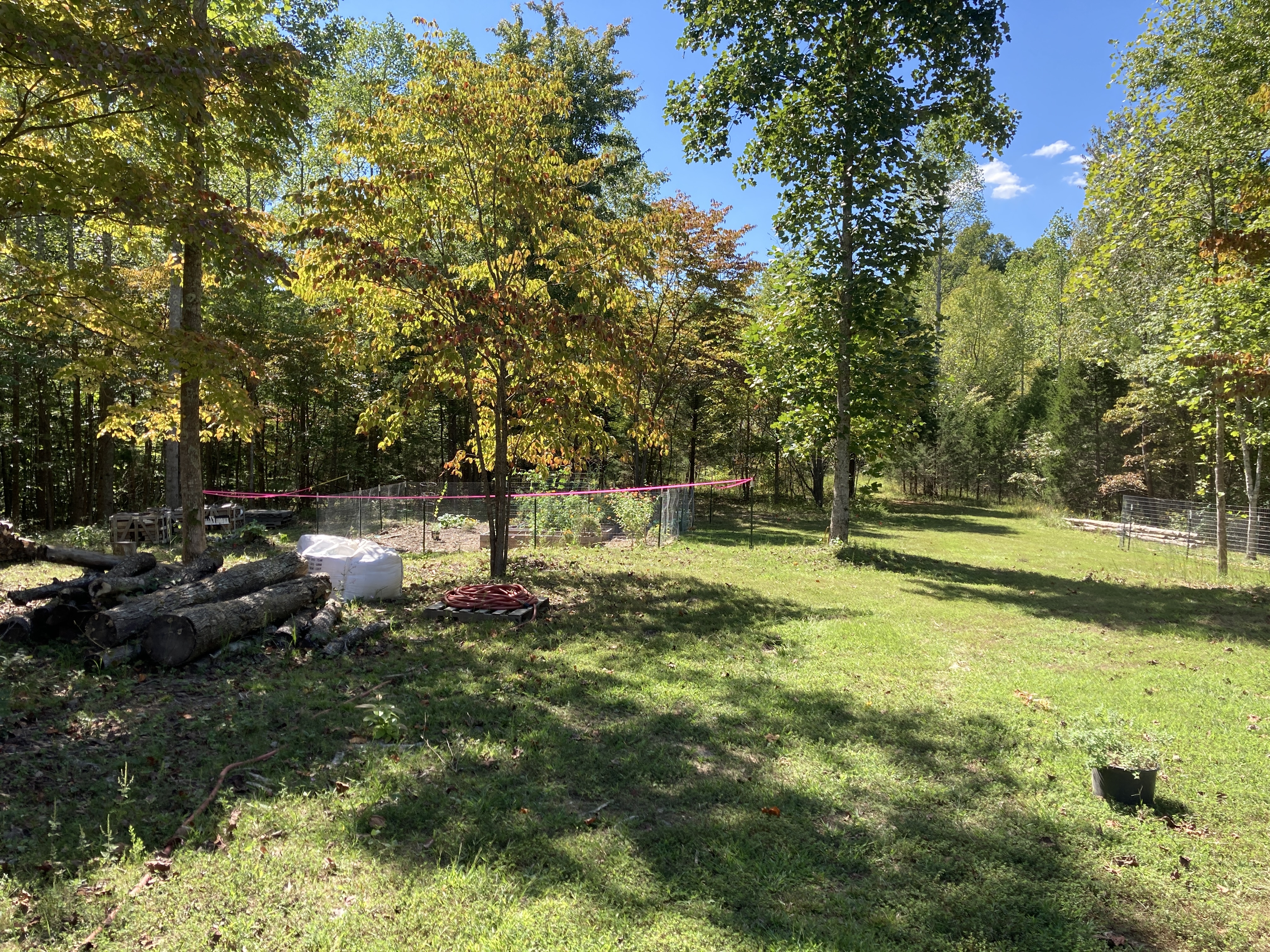

I appreciate you challenging the approach from this perspective. You are right that this is mostly to keep deer (and rabbits, etc) out. No need to impress or look good for neighbors, just our own enjoyment. I also agree that we'll likely want more space in the future, but I don't think we could get it by making this area larger.
First off, we already have multiple garden areas. You can see in the photos below that there's the current garden (chicken wire and t-posts on the left), and a fruit garden on the right with t-posts and 2x4 welded wire around it. We're planning to grow garlic in cattle waterer tubs outside the fenced garden once it's complete, and also have a cedar planter with herbs right off the back stoop of the house.
Secondly, we're constrained by trees and topography. We have plenty of land -- 20+ acres -- but only so much flat land close to the house. The pink flagging tape in the photo represents the outline of the planned fence build. We'll be putting an 8x10 greenhouse just to the right of that, so the only area to expand into would be farther back, which will entail quite a bit more clearing work. We have talked about putting fruit/nut trees back that way (sadly the pecan trees we planted got eaten) so maybe that project is sooner on the calendar than I'm currently thinking.
Our land is also terraced with mature trees, so that's a fun part to work around. Can't really smooth out the terracing without getting into the roots, and we want to keep many of the trees.
This has been good though to think about how the structure of the fence will fit in with everything else that's there. Wonder if it will feel too busy/enclosed...going to have to go stare at it for a while :)
