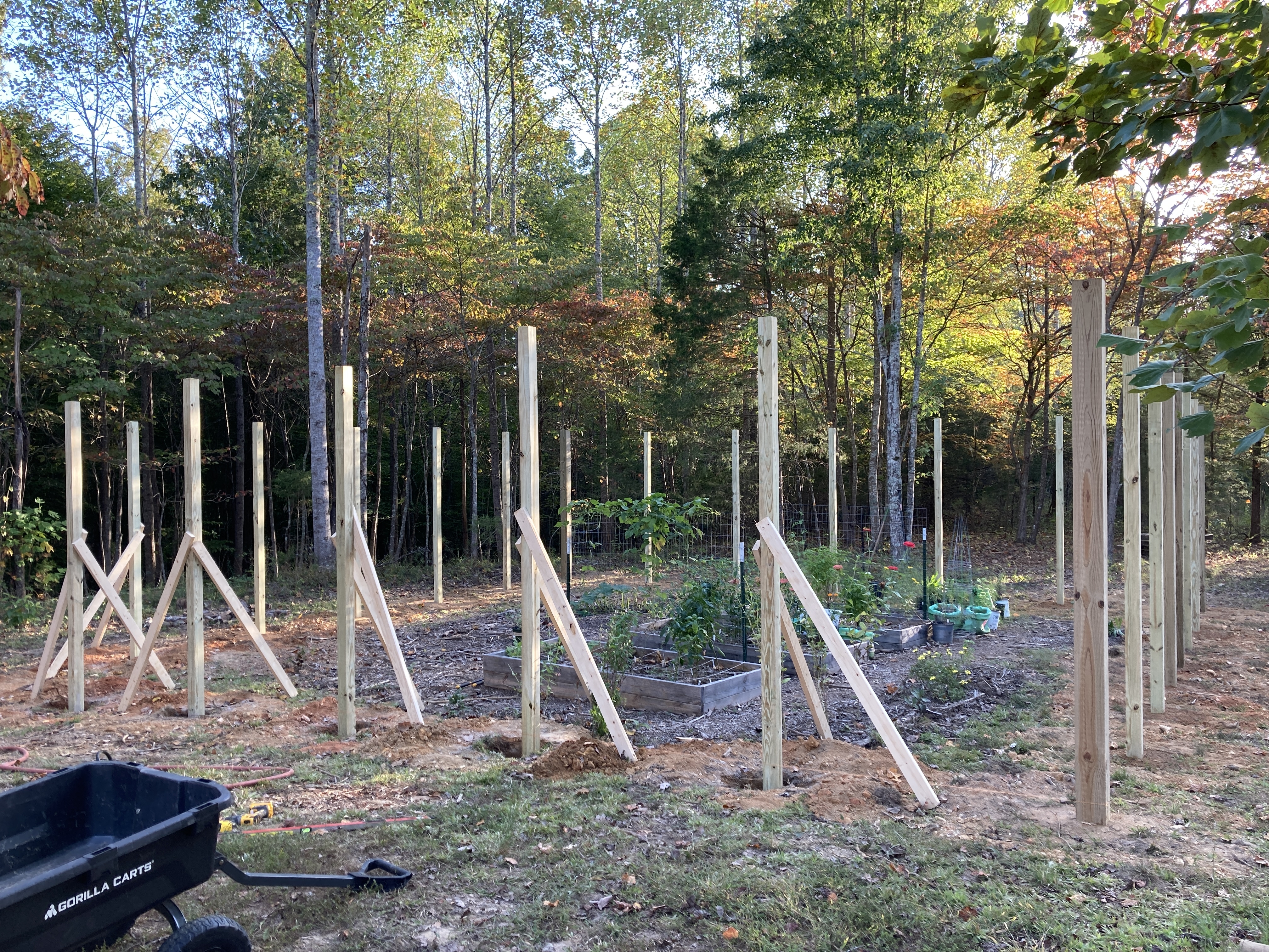

Got the last of the posts set today. Whoever was responsible for marking and digging the holes needs to be fired -- positioning went wrong in a number of places and had to modify holes to get the posts spaced properly.
On the upside, the gate is now 36" instead of 32", which will make the missus happy.
Really don't know where my calculations went wrong...oh well, it'll work!

View attachment 1510847 View attachment 1510848
You should probably fire the contractor. 🤣
   / Garden fence build #55
Not "his" fault. The rocks in Tennessee soil will bounce an auger off direction no matter how carefully he set it.

No, it's definitely my fault...somehow. Not sure where my measurements went wrong, but with a 12" auger for 4x4s I should have had plenty of leeway.
Anyway, on to the next phase!
