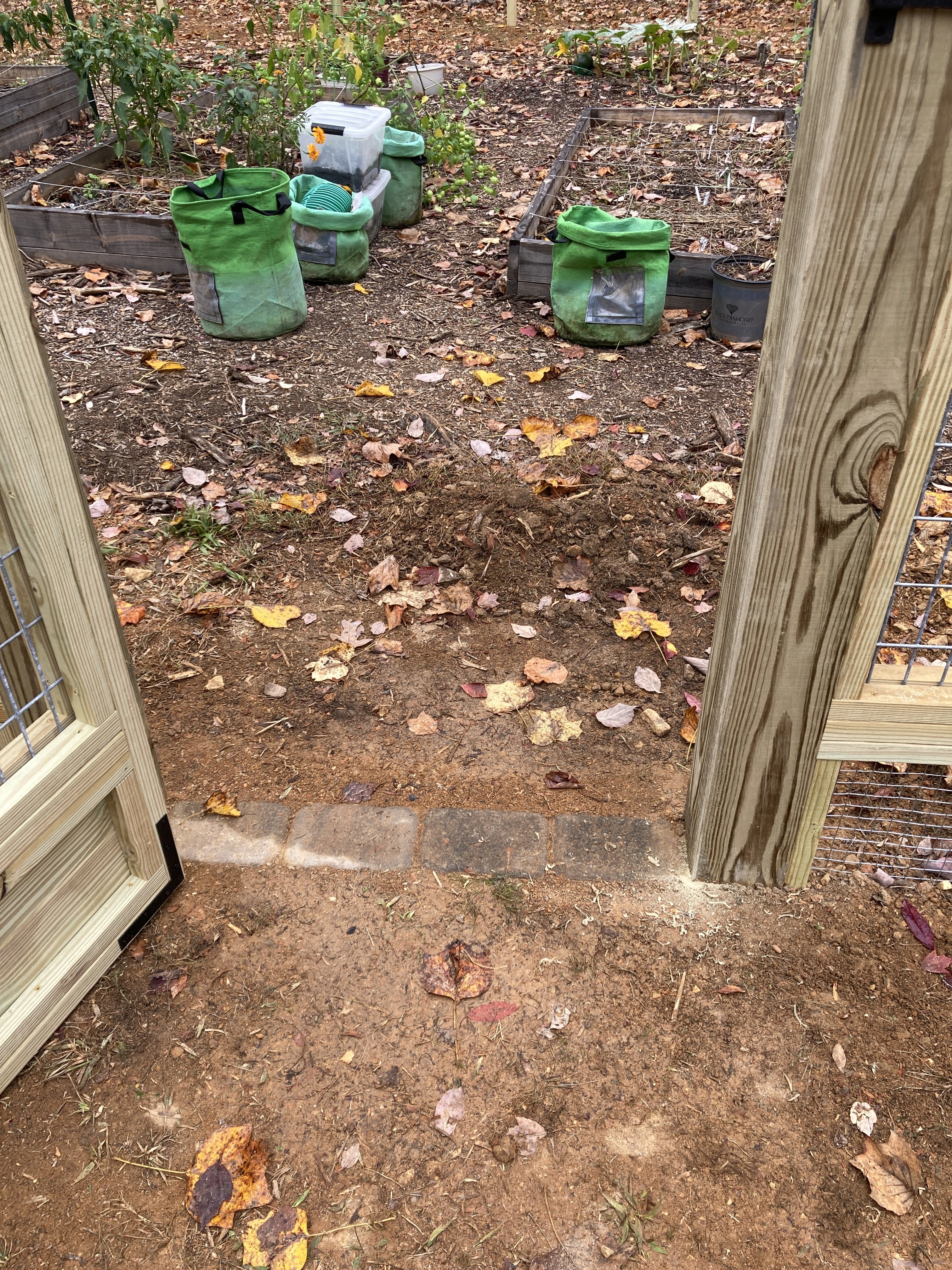

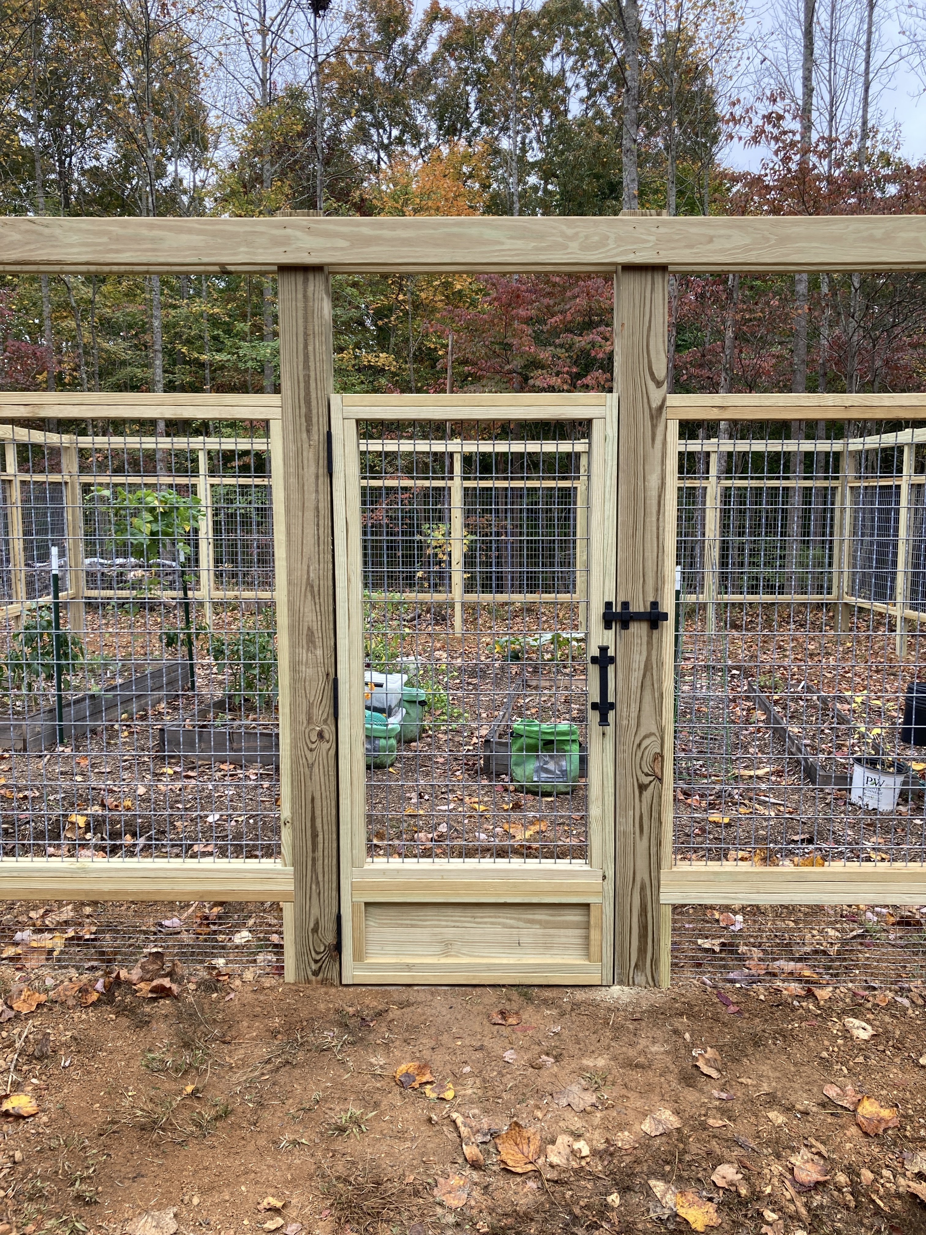

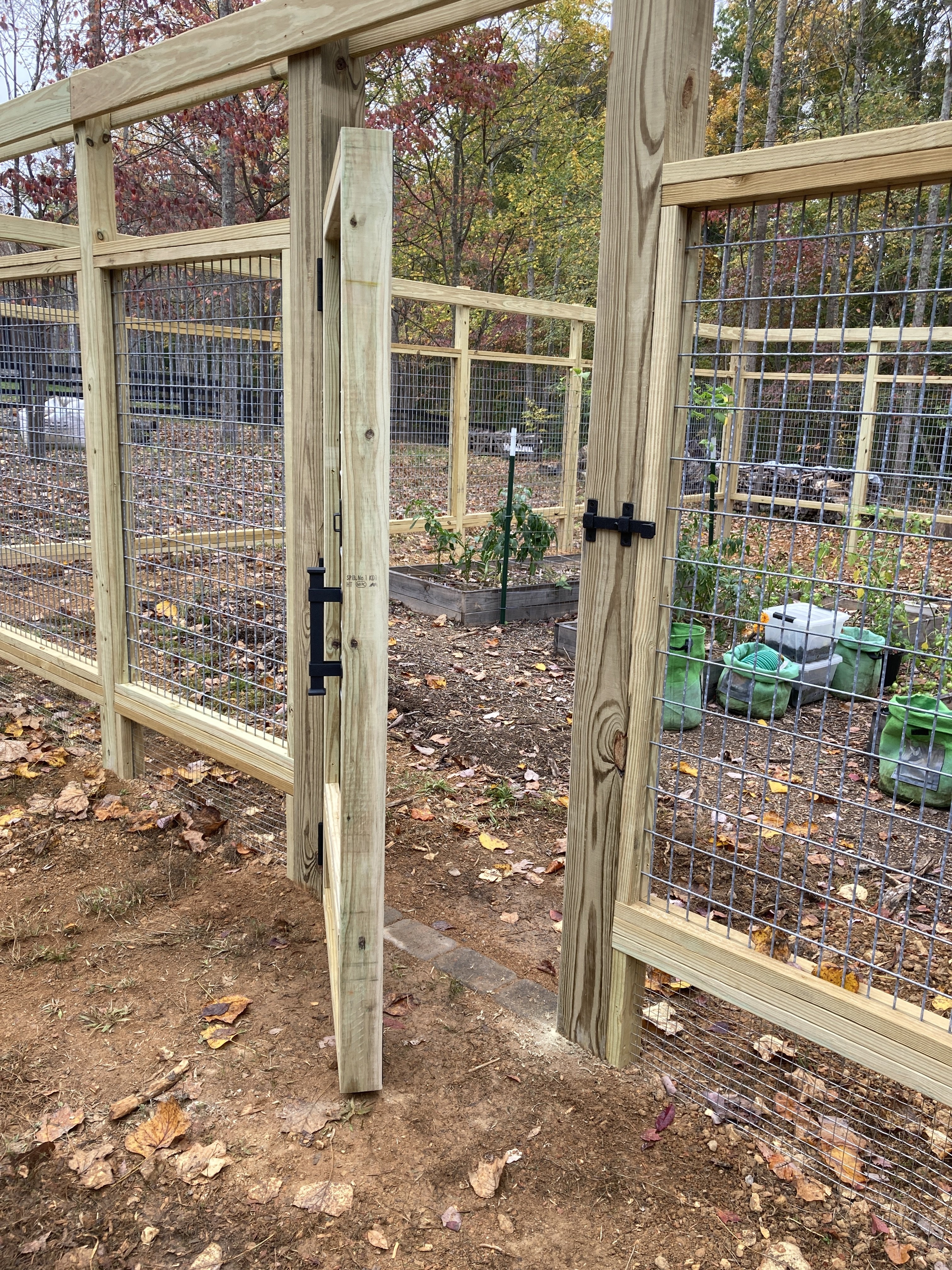

Unexpected rain today so time for another update...Not quite done yet, but got the door mounted this morning.
Discovered another lucky aspect of the door ending up 36" wide -- I made a threshold of pavers which fit perfectly in that width. And I'm halfway through putting up the 1x1" wire on the bottom of the fence then I'll (thankfully) be done with this project!

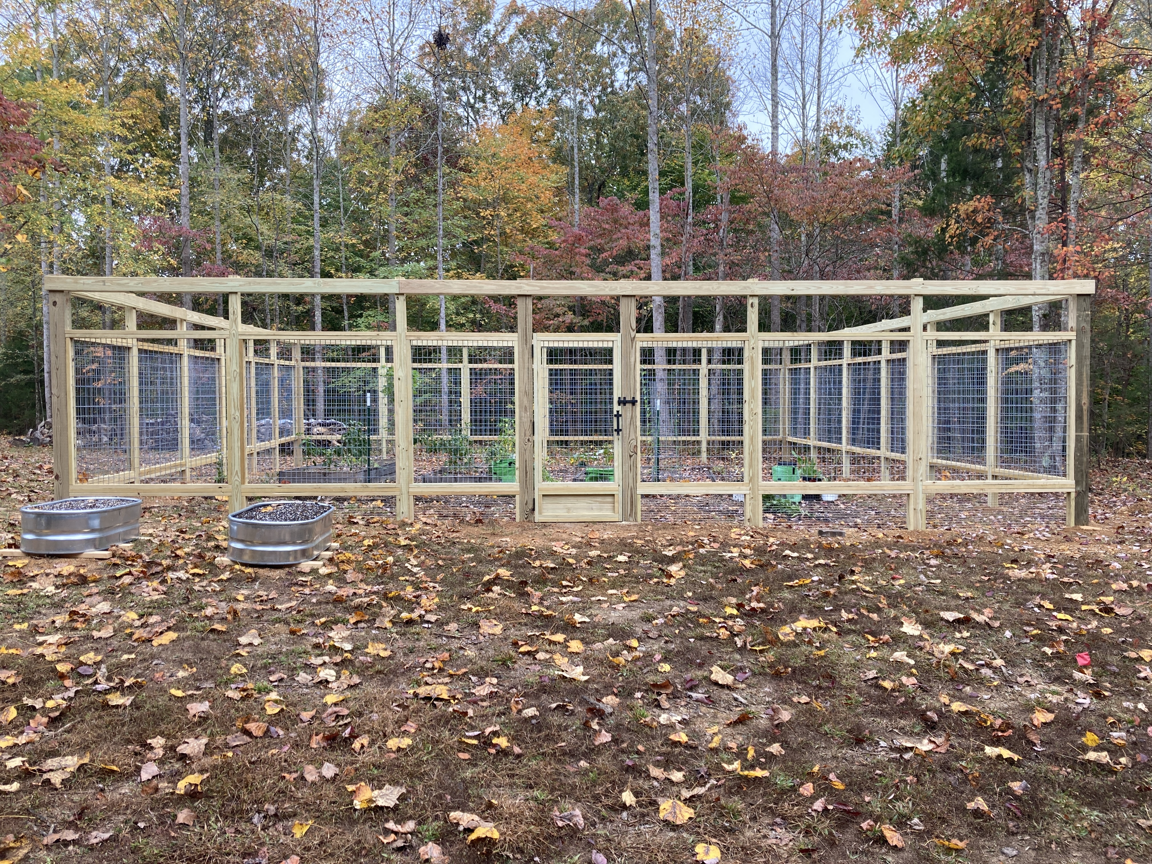

Finished the project today. Lots of learnings. Ended up costing $2750 in materials, plus or minus $50 in screws. I won't try to value my labor, but mostly with me working on it solo (with a little help with the missus when I needed an extra pair of hands), looks like it took a little over three weeks working 7 days a week.
Even with all the saw work, I still have 1..2...3....10 fingers so I consider it a success :). And apparently I lost 5 pounds in the process!

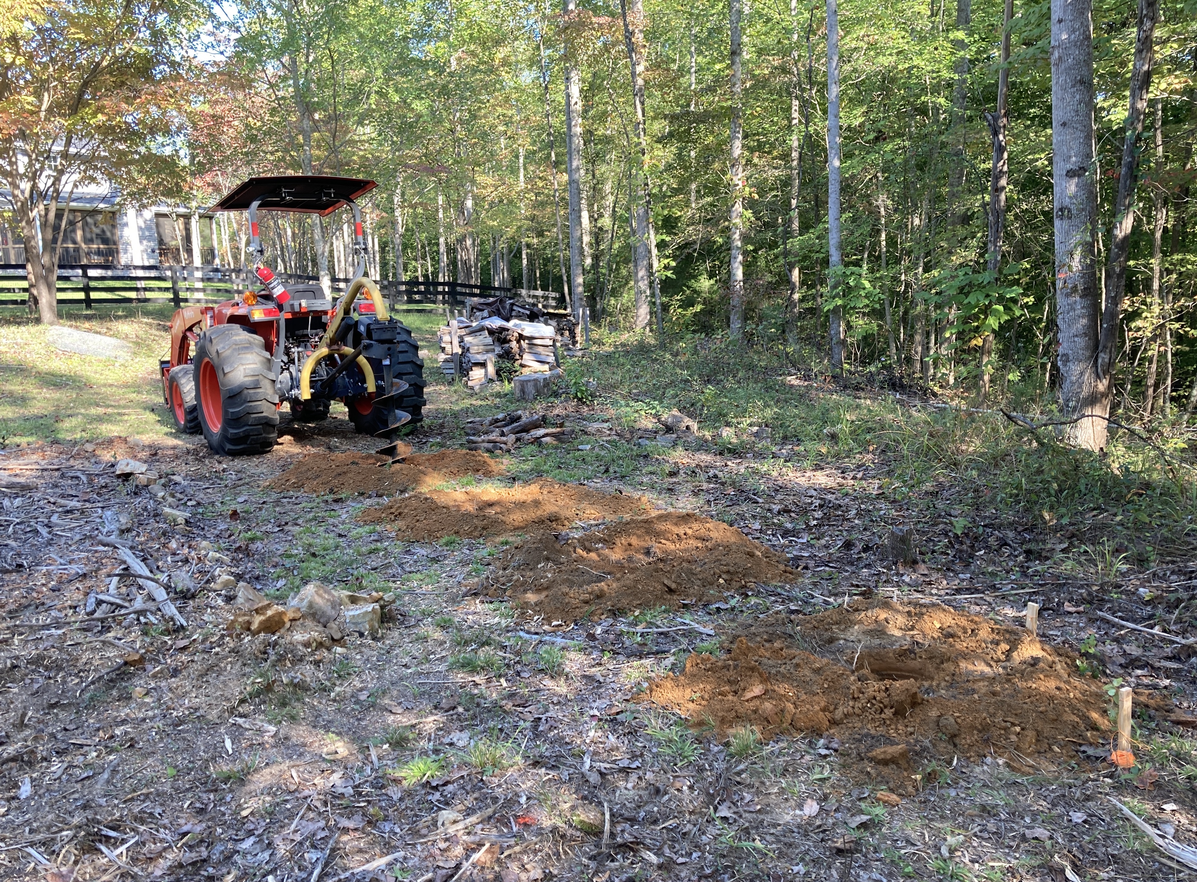

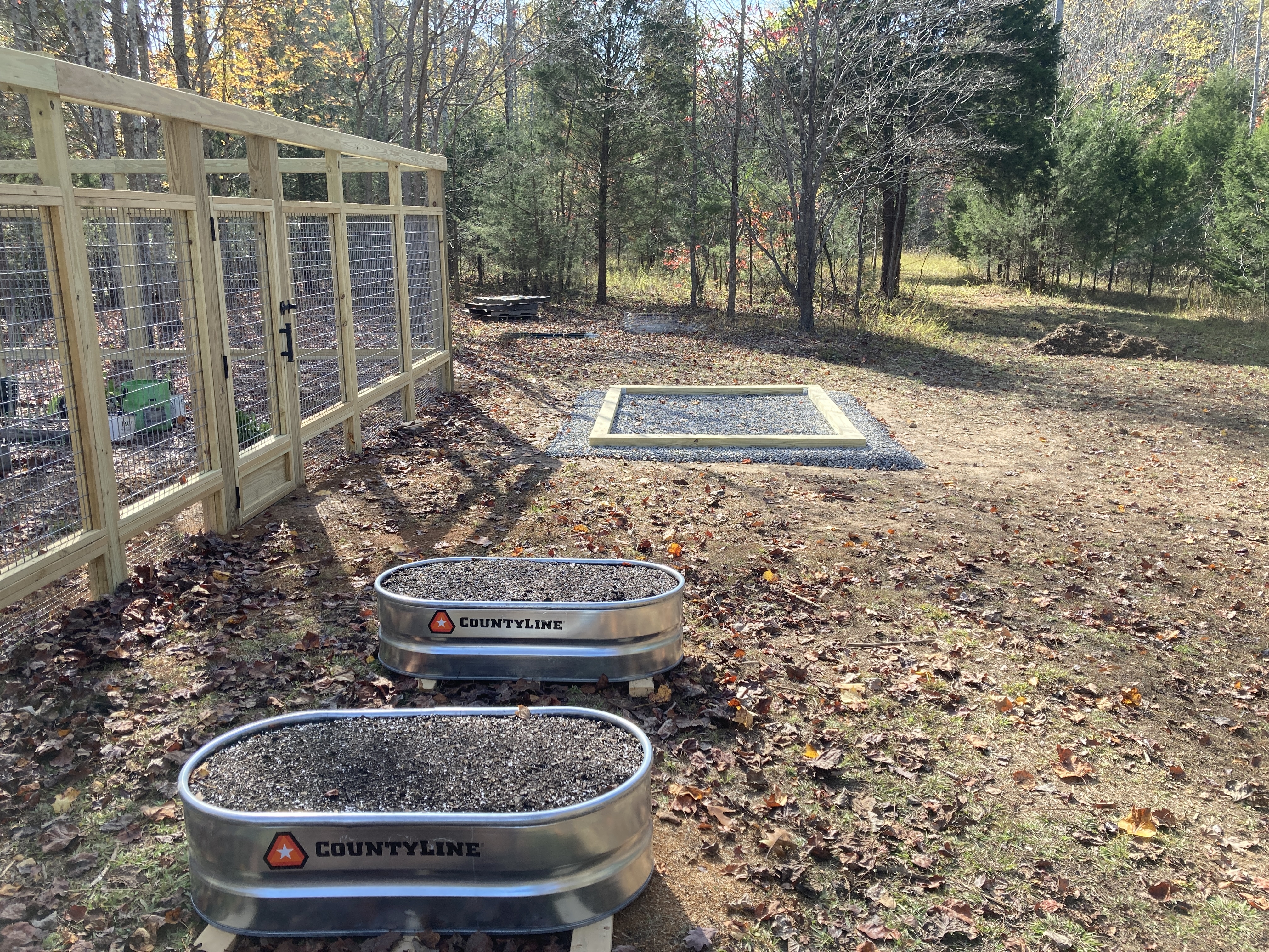

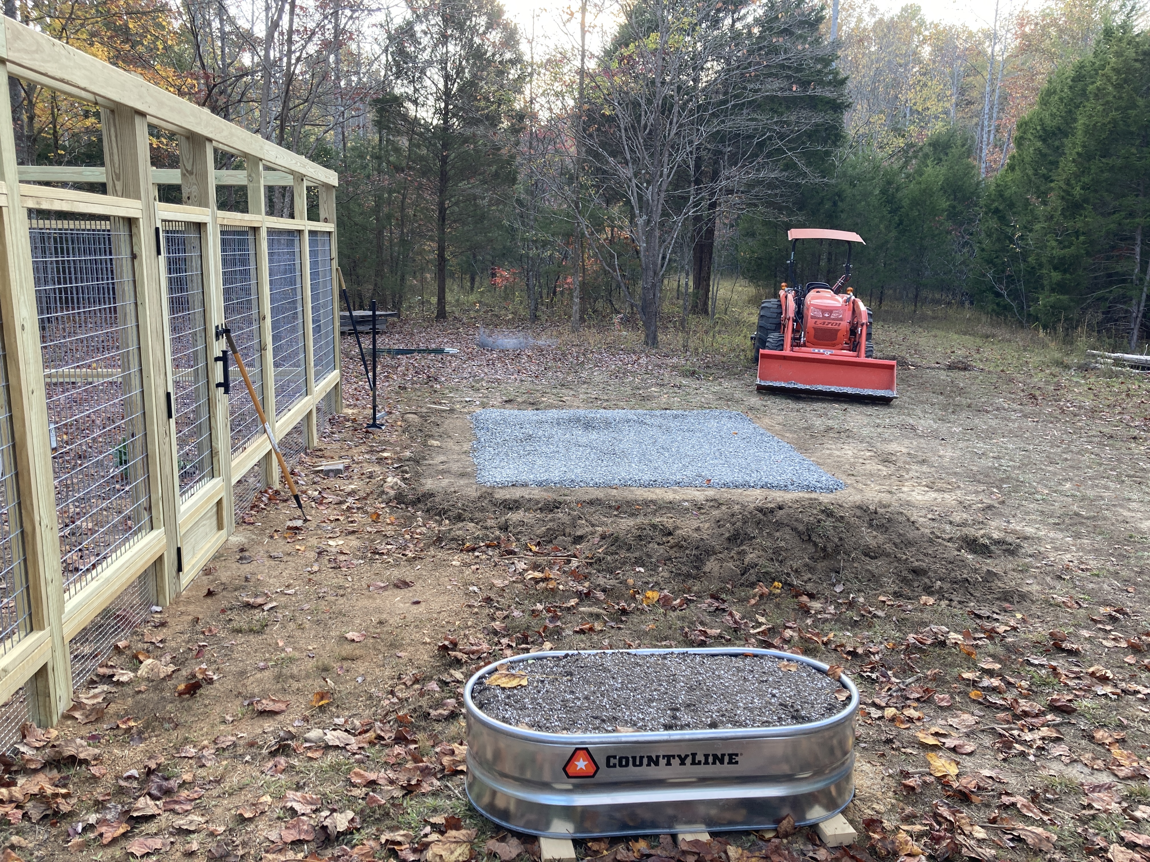

I'm not good at taking days off (or so my SO tells me) so started on the greenhouse foundation today. Scraped off the topsoil and tried to level it out a bit -- I suck at using the loader/bucket to smooth out ground -- then put down some landscape fabric and lastly gravel for drainage and to help level out the 4x6s I'll use as the actual base of the greenhouse. Looking at the photo I still have some leveling work to do on the gravel pad.
Got some Simpson angle braces and mending plates to assemble the base and keep things square. Rain expected on Thurs so I'll probably wait until Friday to get the 4x6s.

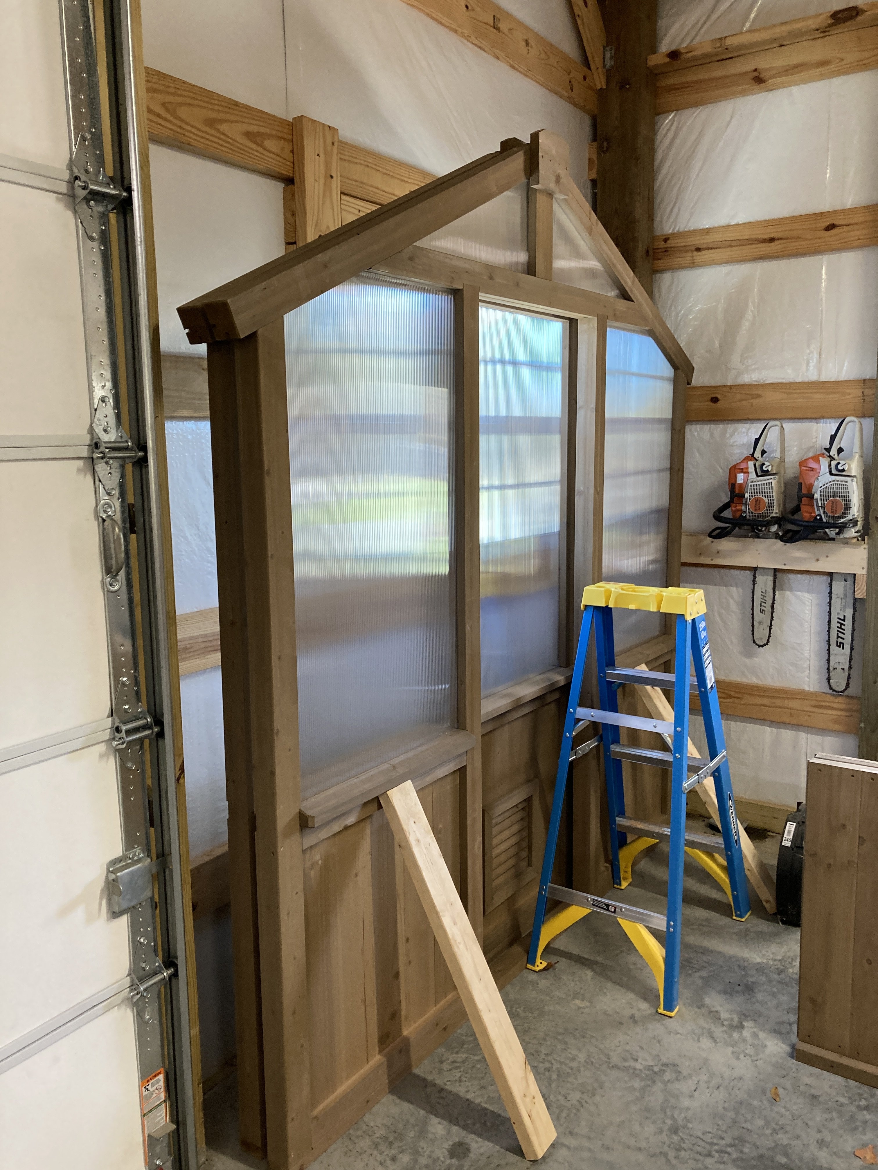

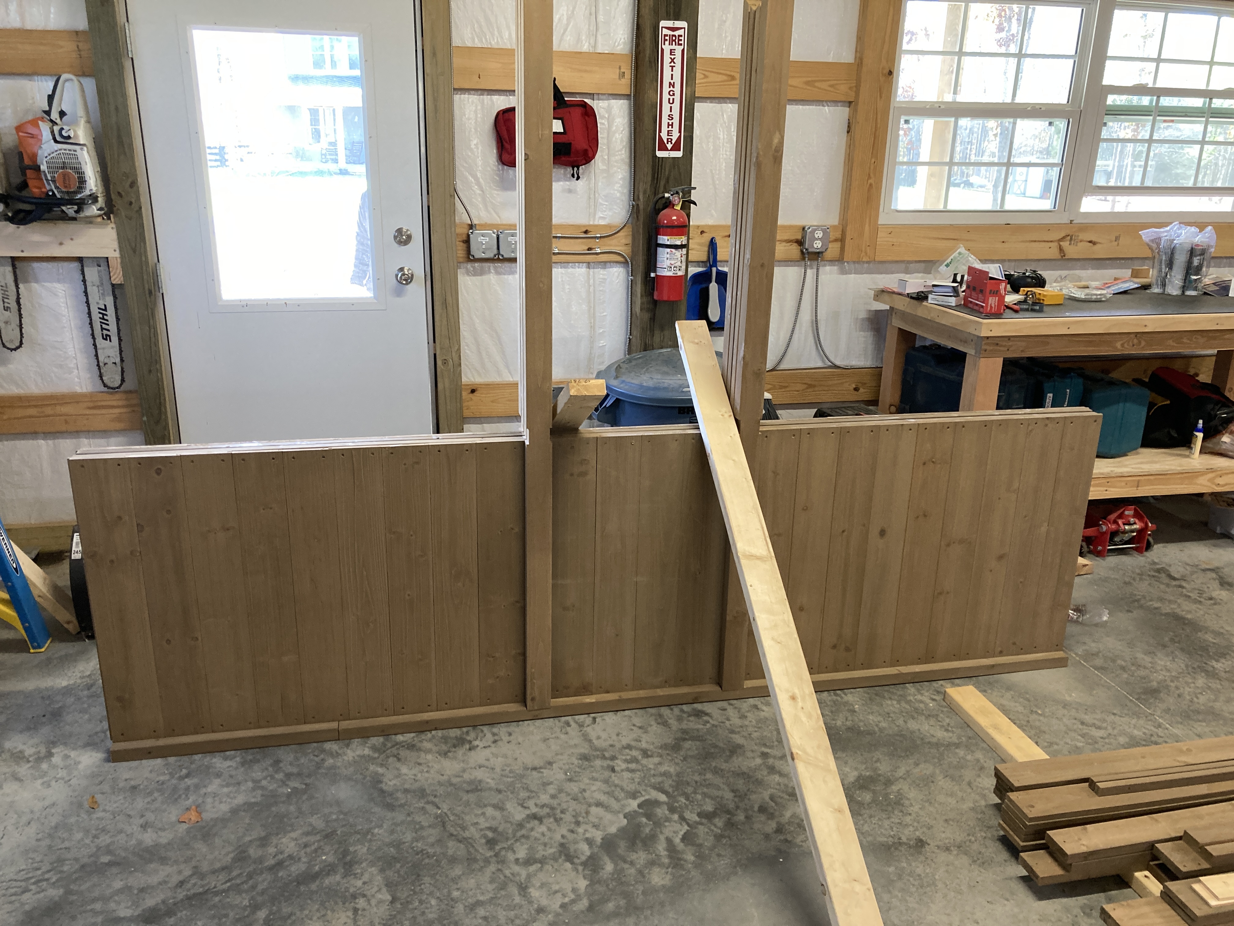

Brief update...been delayed due to warped and damaged parts to the greenhouse and now weather since I missed the dry weather window due to the delays. Given the price maybe it's worth the trade-off, but so far my experience has me not recommending the Yardistry products...
Hoping to get everything assembled on Thursday if it goes smoothly. Have the walls pre-assembled as best I can, the rest has to be done on-site. And have lag-bolts to connect the greenhouse to the foundation.

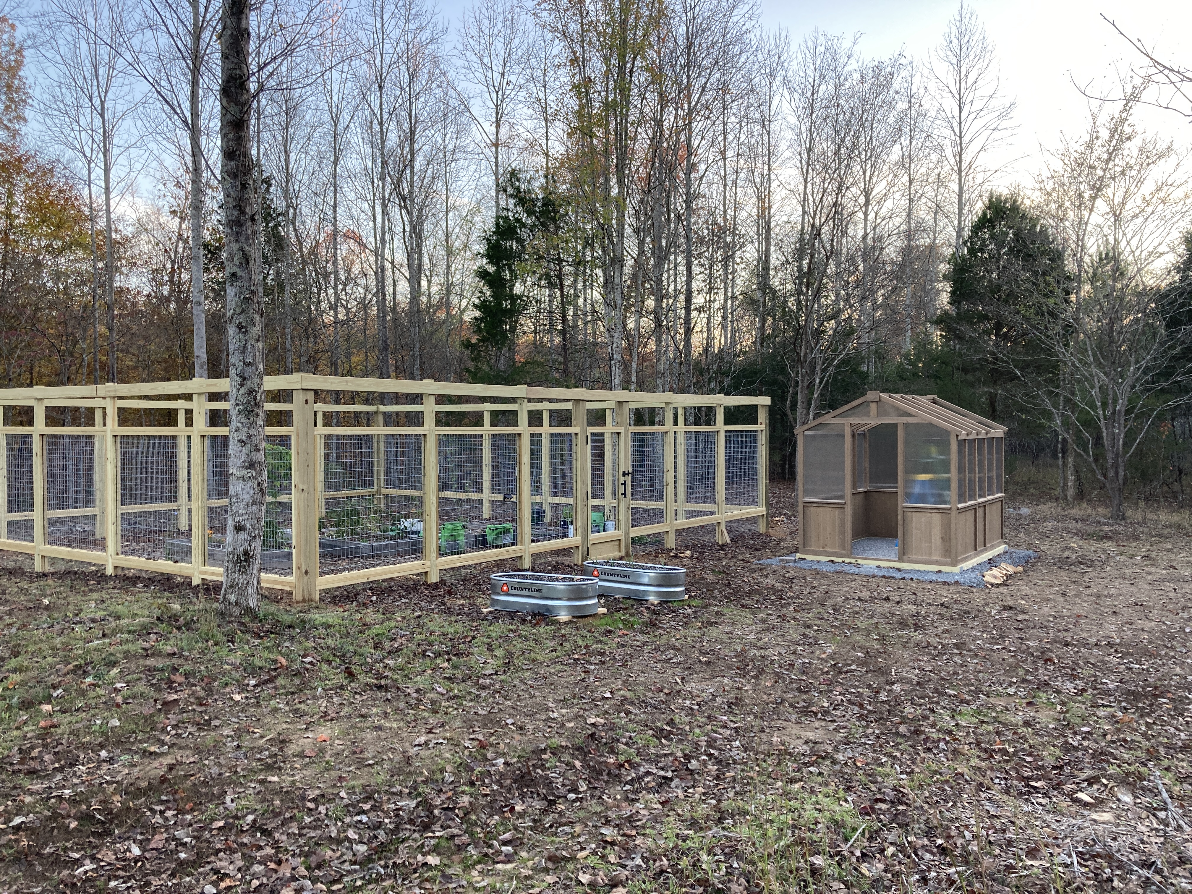

Some more (slow) progress -- finally got all the needed parts and some good, dry weather. Hoping I can finish it up tomorrow. Still need to install the ceiling panels, caulk everything, then do the door and shelving inside.
Did manage to crack one of the roof beams right at a joint.. Hard to describe but the SO was helping me put it up and all of a sudden heard some wood give way. You sister two beams together for the main roof beam so I think a few extra screws have made it all good, but will have to keep an eye on it.
