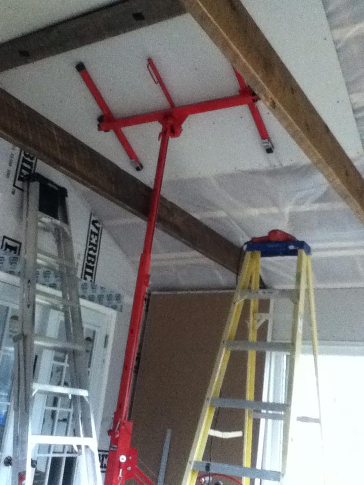

I will just add my 2c for a drywall lift making life easier. I bought a new HF one for about the same money as used ones on CL or a rental, and now my BiL has it for his current project.

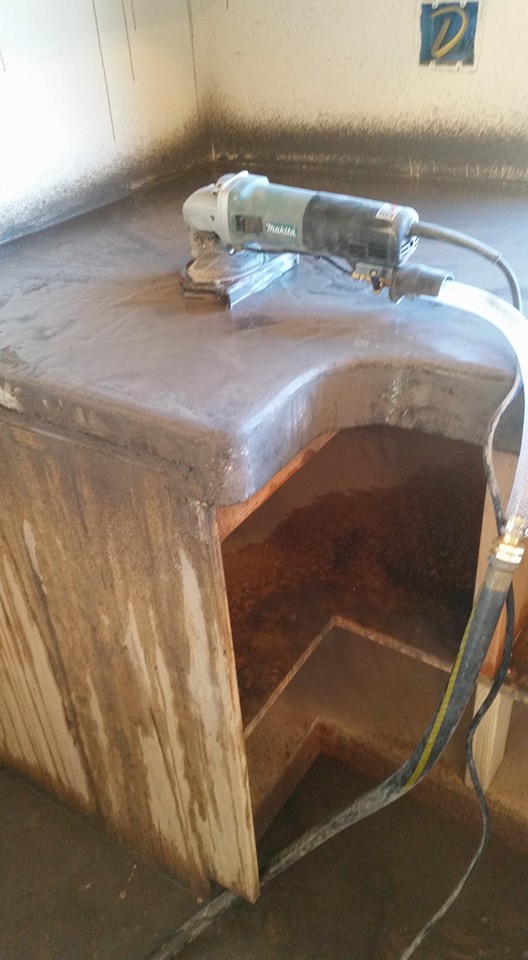

Except for being cheap, these concrete counter tops are turning into a project that I'm starting to regret. I spent half the day polishing them and they are getting a lot smoother. Not great, not pretty. They are just looking like smooth concrete. I was really hoping the stain that I mixed into it would have done something, but it's like I never put added it at all. It was liquid and I poured it into the mixer, so it should have gone all the way through. After polishing, there is no sign of color. I'm going to stain them when I'm done polishing and see if that helps.
To polish the concrete, I bought a Makita 4 inch stone polisher from Amazon. The reviews where all good except for the hose attachment. Some said it was hard to find, others said it was easy at Lowes. I proved to be impossible for me, or anybody else at Lowes to figure out what would work. The fitting on the polisher is just a hair smaller then a garden hose quick attach. Eventually I figured out that I would just slide a hose over the fitting and clamp it down.
Water and polishing is a mess. It's a huge mess!!!! Doing it in place is just crazy. Never do this in your house!!!!

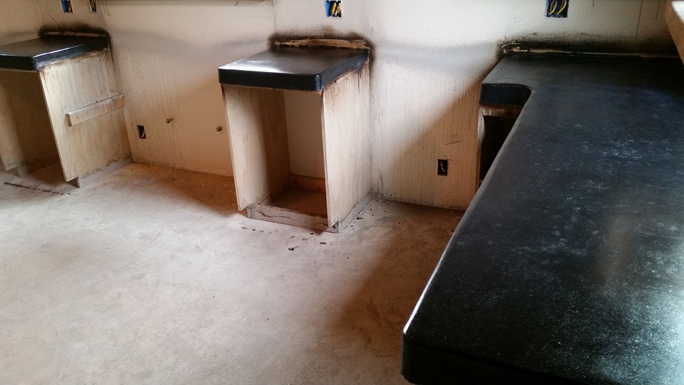

The counters have proven to be a bigger challenge then I had expected. The polishing disks work great, but they don't last very long. I went through two sets of them to get the counters smooth. The mess factor from the water was pretty bad. I'm not sure what I could have done to catch all the water, and keep it off of the floors. Thankfully they are still just the concrete slab and I just let it evaporate between hours and hours of polishing.
The next big disappointment was the stain. I mixed in the stain sold at Lowes that is made my Quickrete. I had hoped that since they sold the concrete mix for counter tops, the stain would work well together. It left the unpolished counters a nice color, but once they where polished, the color went to grey. Water made it dark again, but just temporarily.
I bought a gallon of ebony colored acid stain on Amazon to make it darker. It had the highest reviews, but some of them said it didn't make the concrete very dark at all. I did two coatings. First one cooked for 12 hours, the second for another 12 hours. They said 24 hours was the max to let it cook before spraying it with ammonia and water to neutralize the acid. The results where ugly, patchy and too light. There was also some brown, rust like areas that developed from the stain that we didn't like.

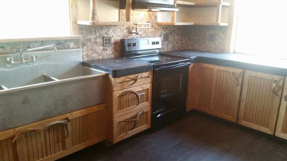

Finally I found some dye that was jet black and very strong. I thinned it down with paint thinner and rubbed it on like wax in circles. The results where instant, and amazing. Finally, we had what we wanted in the correct color.
I'm at 3 coats of sealer in this picture. They recommend at least two layers, but said that the more you put on, the better the protection and the higher the gloss you will get. I've used less then half the bottle, so I'll probably keep adding layers to it over time when I know there will be no dust to deal with until I use up the bottle.
