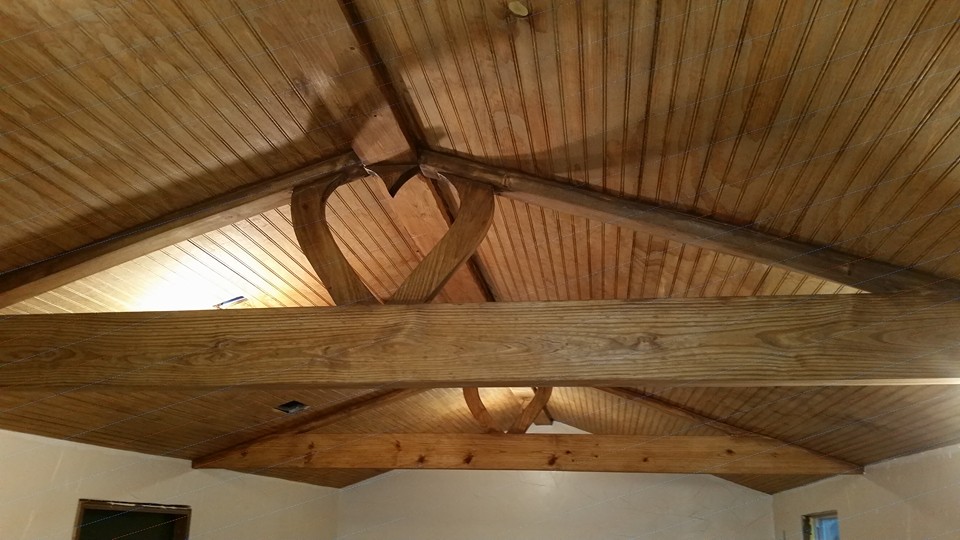

#25
Ceiling and beams are stained. We went with Minwax in Puritan Pine

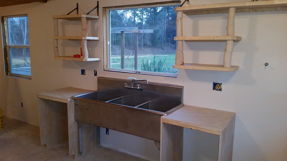

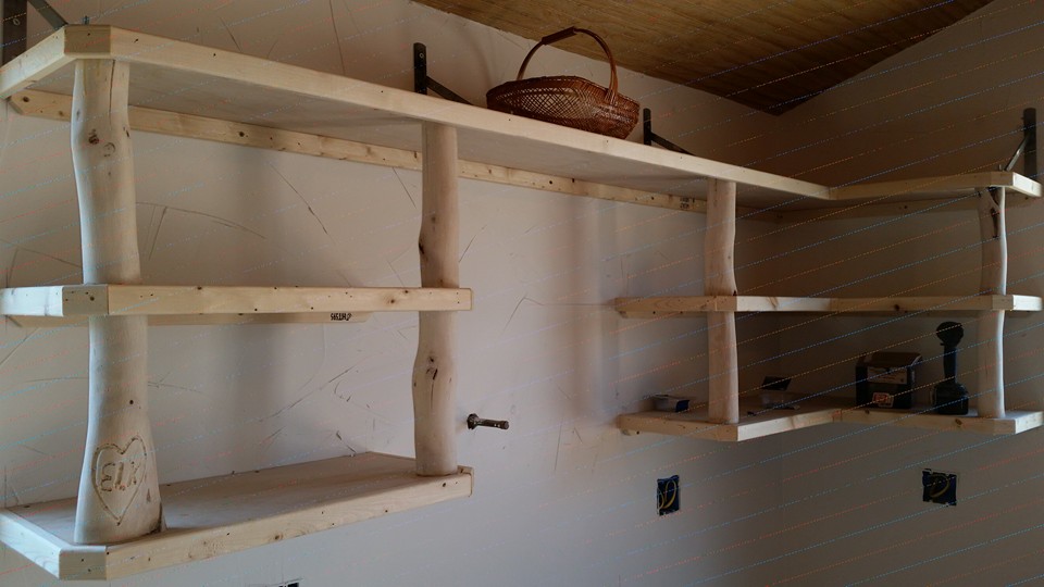

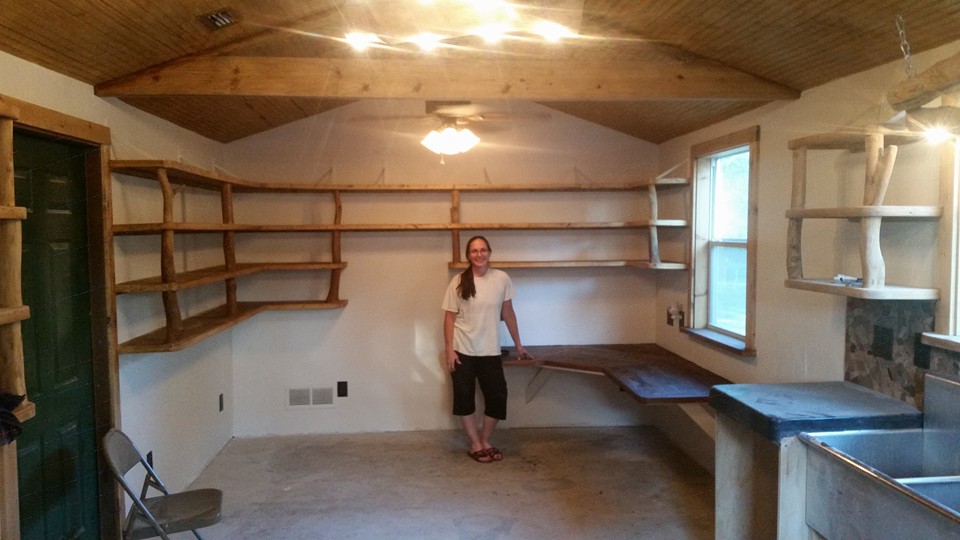

#26

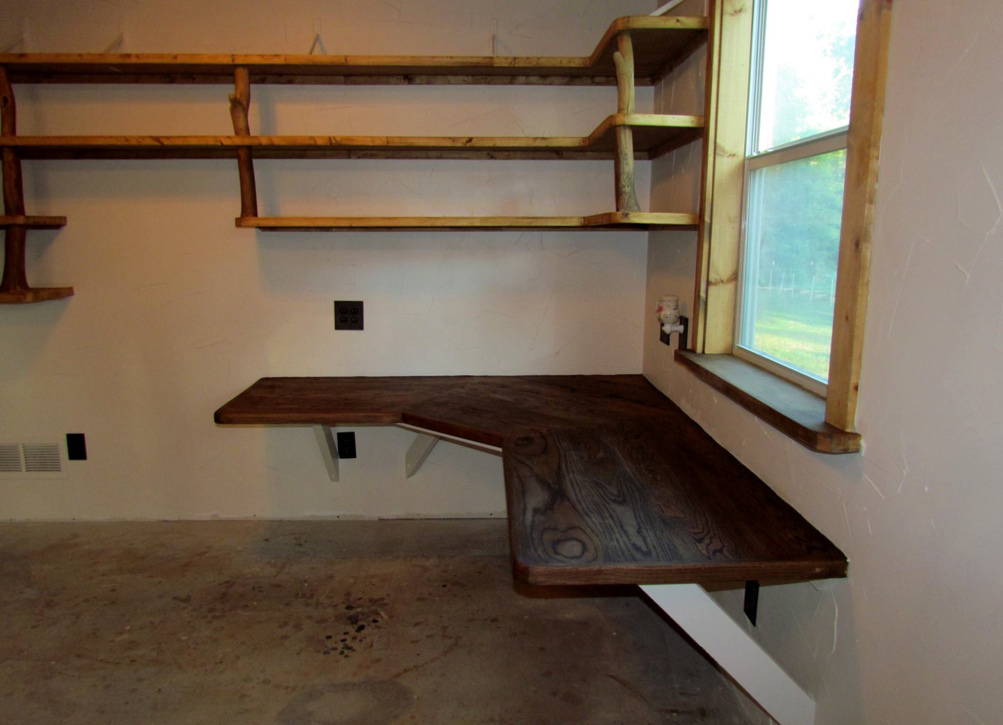

For the shelves, I wanted something open, and easy to see what's up there. Basic shelves seemed kind of boring to me, so I'm trying something new. I bought some shelf brackets and welded them up to make them stronger, then mounted them upside down on the top shelf. I also ran a bolt through the shelf and the bracket to make sure screw threads would never pull out. Then the lower shelves are hung from that top one with branches that I cut from a downed oak tree. It took a very long time to get them sanded how I wanted them, but the result was worth it.

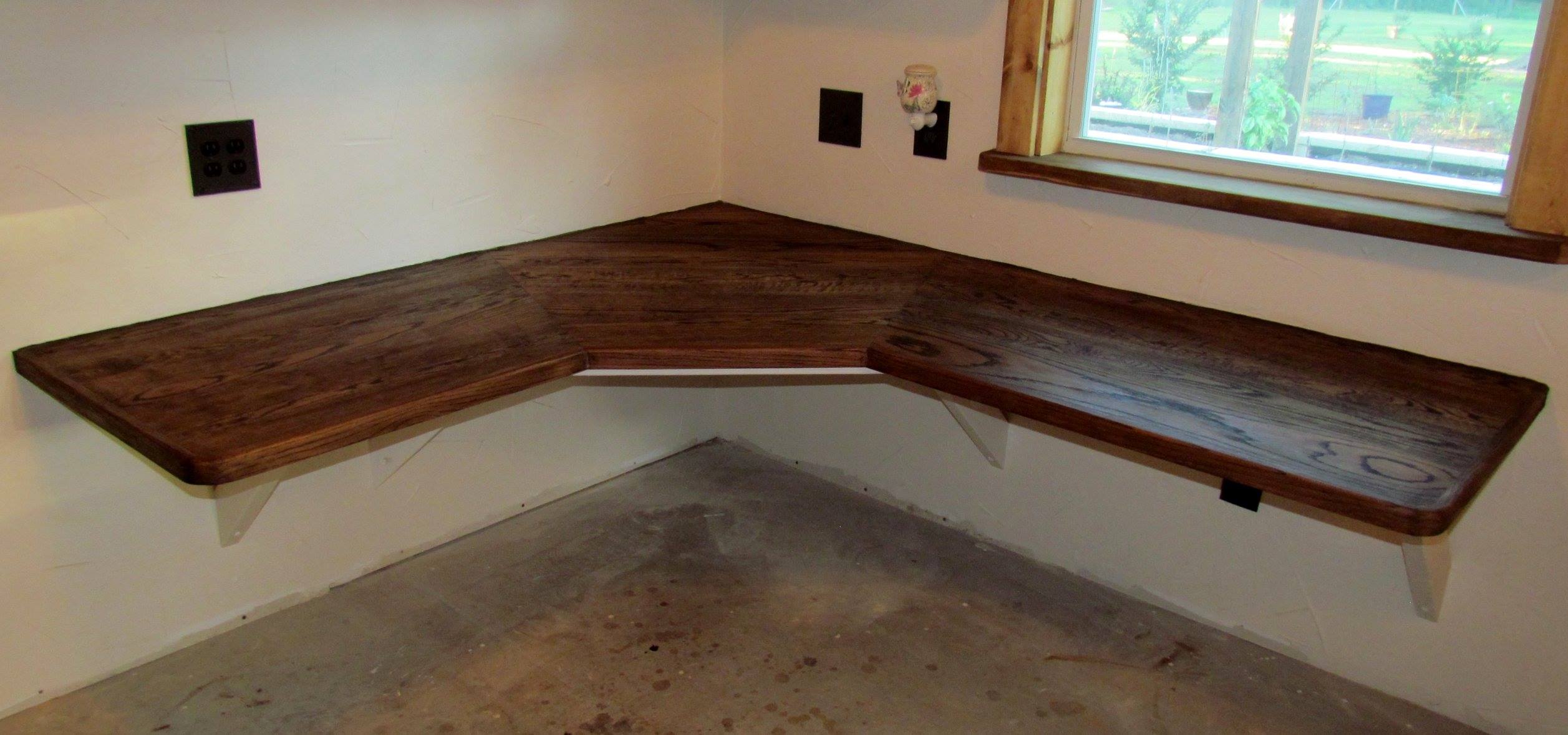

For the bottom, I'm making normal enough cabinets from plywood. The stainless steel sink was something I saw on FB lat year and knew I had to have it for this project. This is the first time I've seen it where it's going to go. I'm going to cut the legs off of it and the lip on the sides so I can put the counter top over it just like an under mount sink. Because there is no way to get to the water lines or the back of the faucet once installed, the sink will have to be able to slide out when I'm done with everything.
I'm going to try to make concrete counter tops. We want them to be as black as possible, so right now I'm researching ways to dye the concrete. Has anybody done this before? Lowes sells a specific Readi Mix labeled for counter tops at $18 for an 80 pound sack. Pricey, but hopefully worth it.
   / Garden Kitchen/Processing Room #27
:thumbsup:!
   / Garden Kitchen/Processing Room #28
A+ on the shelves Eddie.
   / Garden Kitchen/Processing Room #29
Eddie PLEASE delete the pic of the shelves, If my wife sees it i will be building shelves just like that, but with some minor change that wont take much to do. Just :laughing: I really like the shelves and I likely will be building some. Ed
